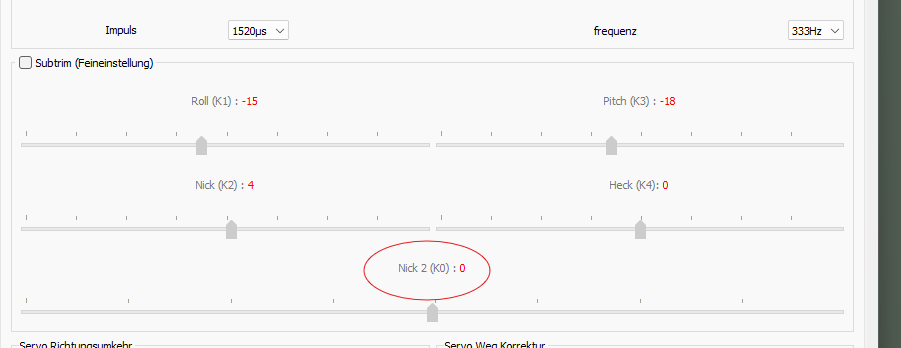

I use the CCPM 90° Velos for a Vario R22 mechanic.
I there no positiblity to Subtrim the channel 0 ?
I there no posibility to make a servo travel correction on channel 0?
Thanks for your help!

Selecting "CCPM 90" degrees gives you a subtrim option for CH0 in the PC configuration software (Version 4.0.2).
It seems, that travel correction must be done via the remaining 3 servos.

I Found the subtrim for Channel 0 in 4.0.2,
Thanks for the hint.
But there is no servo travel correction for channel 0 in the in the corresponding dialog.
I can not understand, how i will make a travel correction on Channel 0 with the 3 other servos.
The servos are all independent of each other.
Jörg
Sepp62
Posts: 77
Travel correction is used to make the swashplate level in the lowest and highest position.
If you have adjusted the subtrim at 0 degrees and roughly the overall collective travel under "Limits", it should be possible to make the swashplate level by correcting the other 3 servos. It will not be possible to change max and min pitch with this method (thus you need the setting under "Limits").
I never tried this, but this is my guess how it could work. At least for your scale model, which is not dependent on a symmetric pitch range. Limiting pitch for the negative pitch range, can be done on the transmitter side.
You are correct. Travel correction can be made by remaining 3 servos to match travel with the 4th servo.
