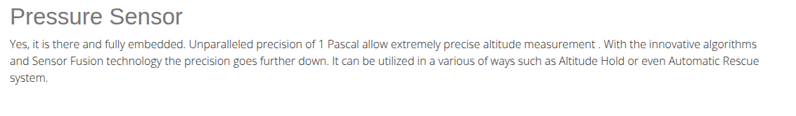

Pressure Sensor
Yes, it is there and fully embedded. Unparalleled precision of 1 Pascal allow extremely precise altitude measurement . With the innovative algorithms and Sensor Fusion technology the precision goes further down. It can be utilized in a various of ways such as Altitude Hold or even Automatic Rescue system.
