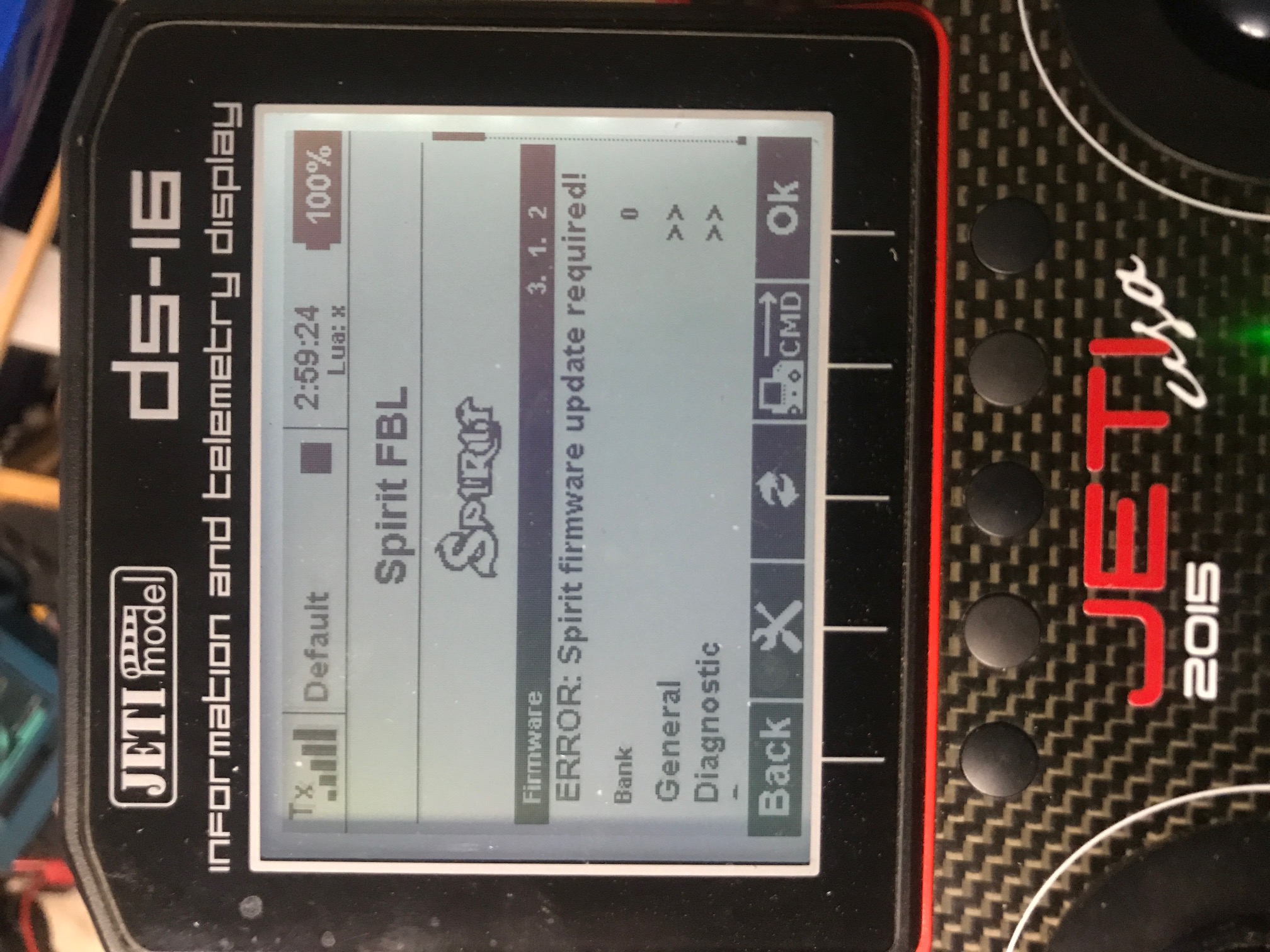

My SPIRIT GTR has been updated to version 4.0.2 r2, but JetI is still showing an ERROR!
What settings are incorrect?
10x
Posts: 192
Firmware in the Jeti is showing version 3.1.2. you need to update the spirit bin file. Download from here. https://spirit-system.com/download.php
Go down to the bottom under integration and download the Jeti file... Then read here https://manual.spirit-system.com/index. ... ntegration
