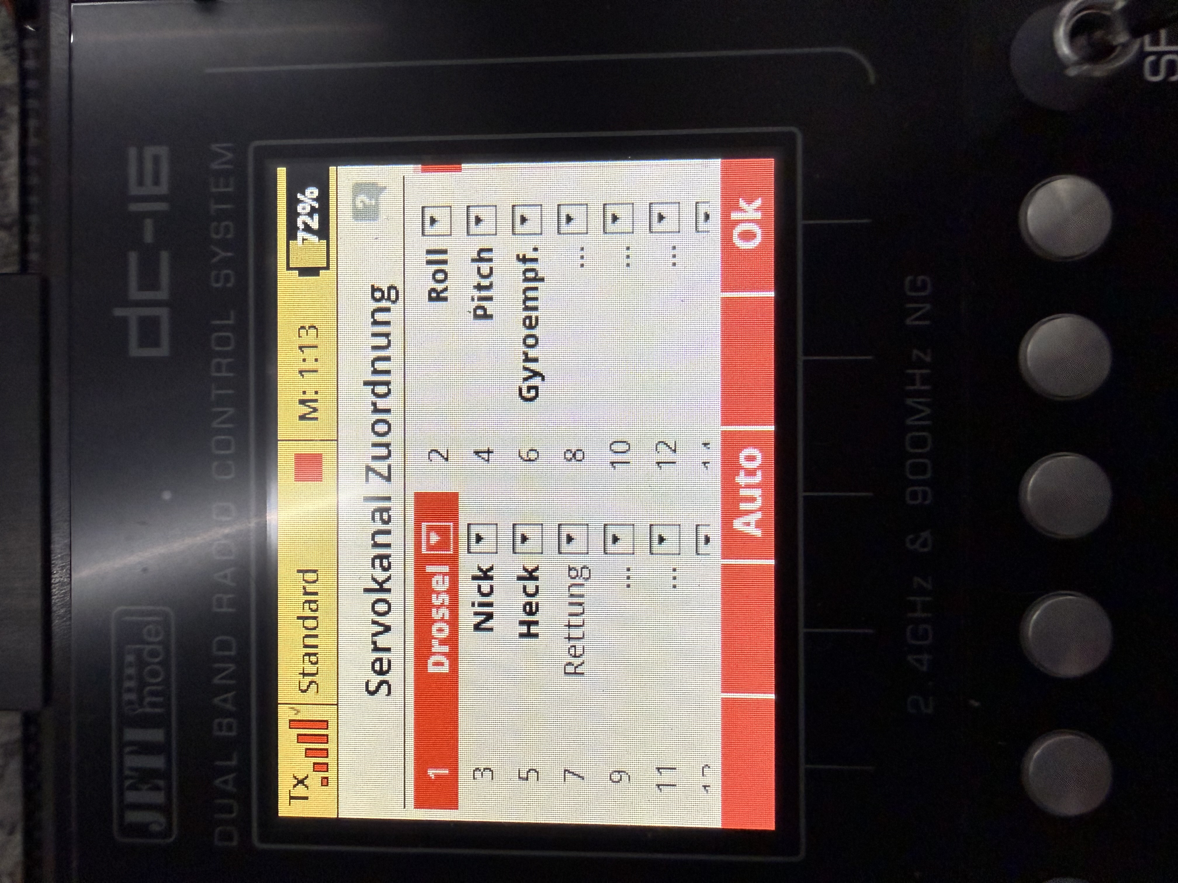

Hi, thanks for the feedback, but now I'm unfortunately confused
I set it up exactly like this.
so the channels on the Jeti DC-16 II are:
1: Throttle
2: Aileron
3: Elevator
4: Pitch
5: Rudder
6: Gyro
But in the Spirit software, Tail and Pitch are swapped.
BTW, I’ve also checked the servo cable connections ;-)
What am I doing wrong?
Thanks in advance

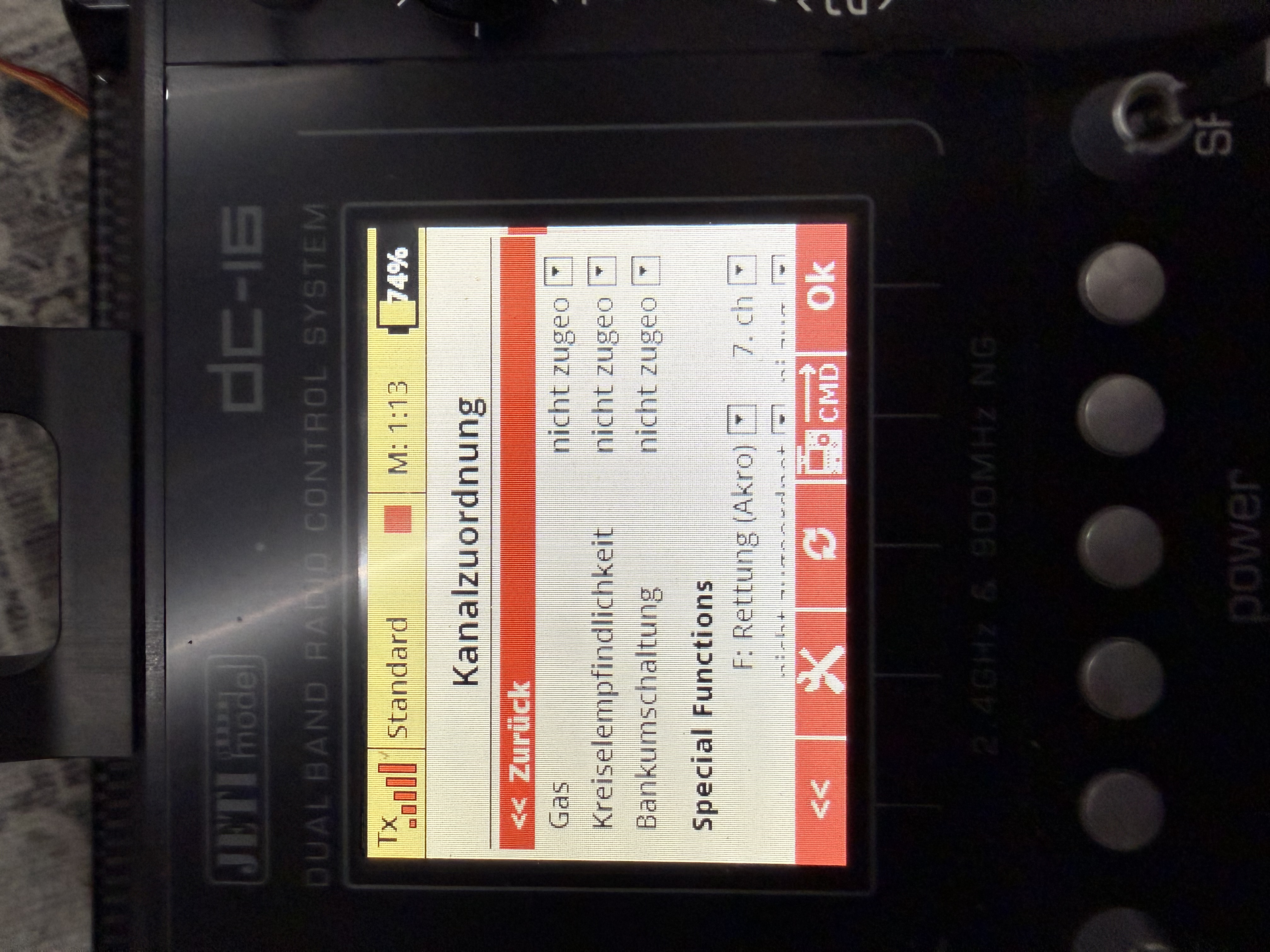

Flyfrank
Posts: 14
Joined: Sat 14. Jun 2025 9:01:24

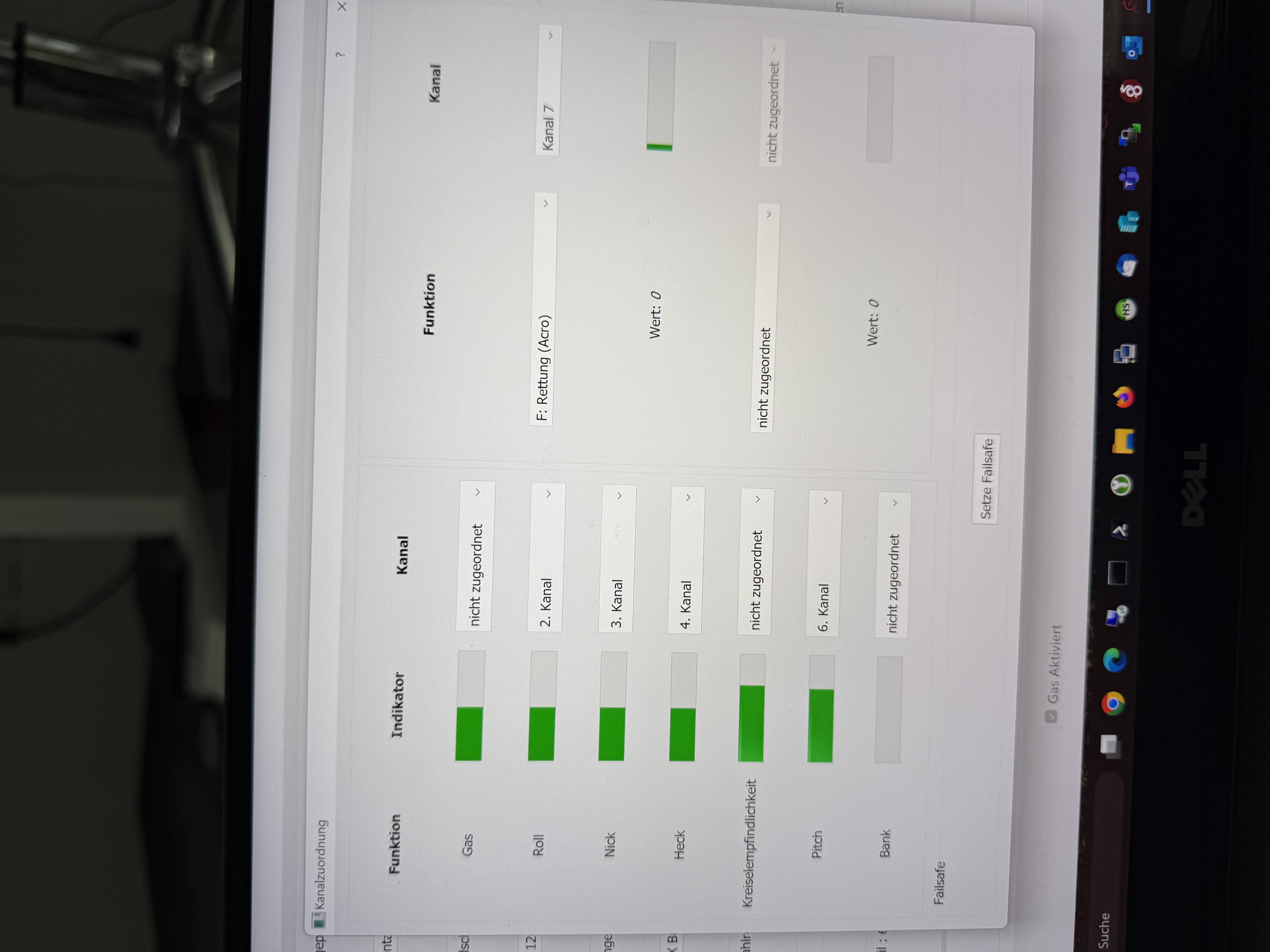

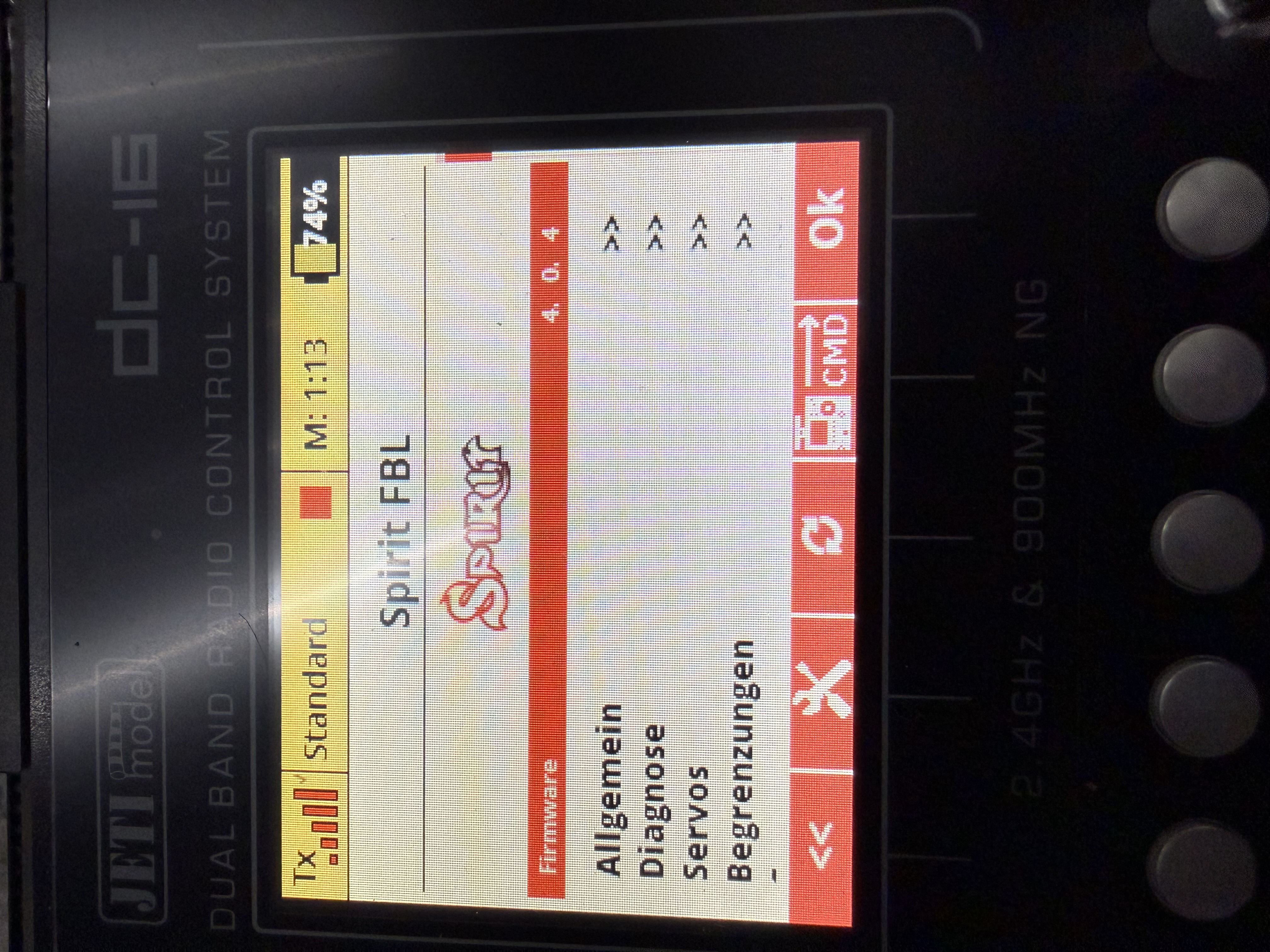

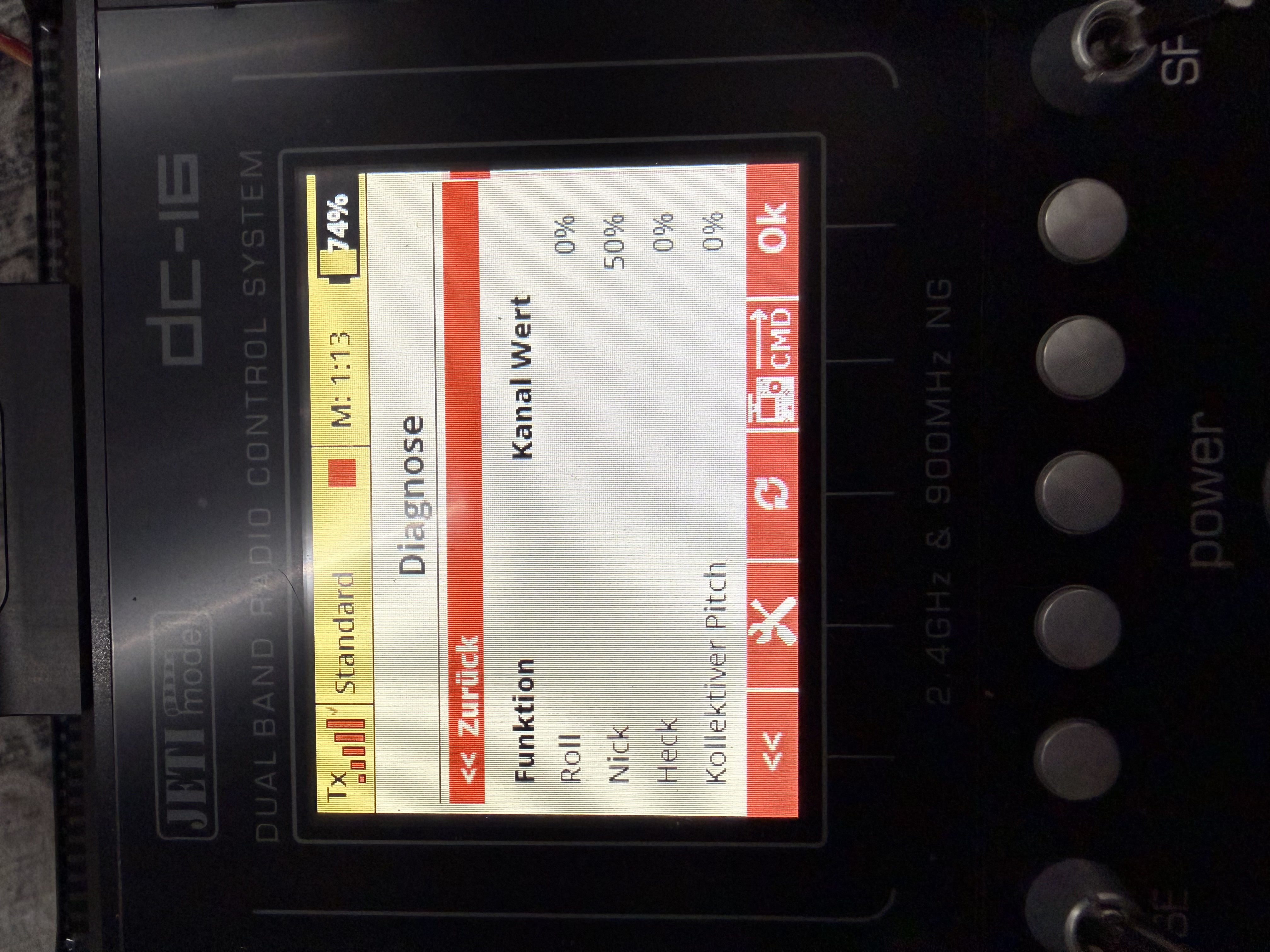

Hm, may be I am to stupid...
I did a complete new setup with jeti + spirit. Here is the result
Rudder and pitch swapped, okay no problem, it´s working
Gyro not working and rescue channel 7 not working.
Can anyone help me? The servos are plugged in correctly
Thx
Frank

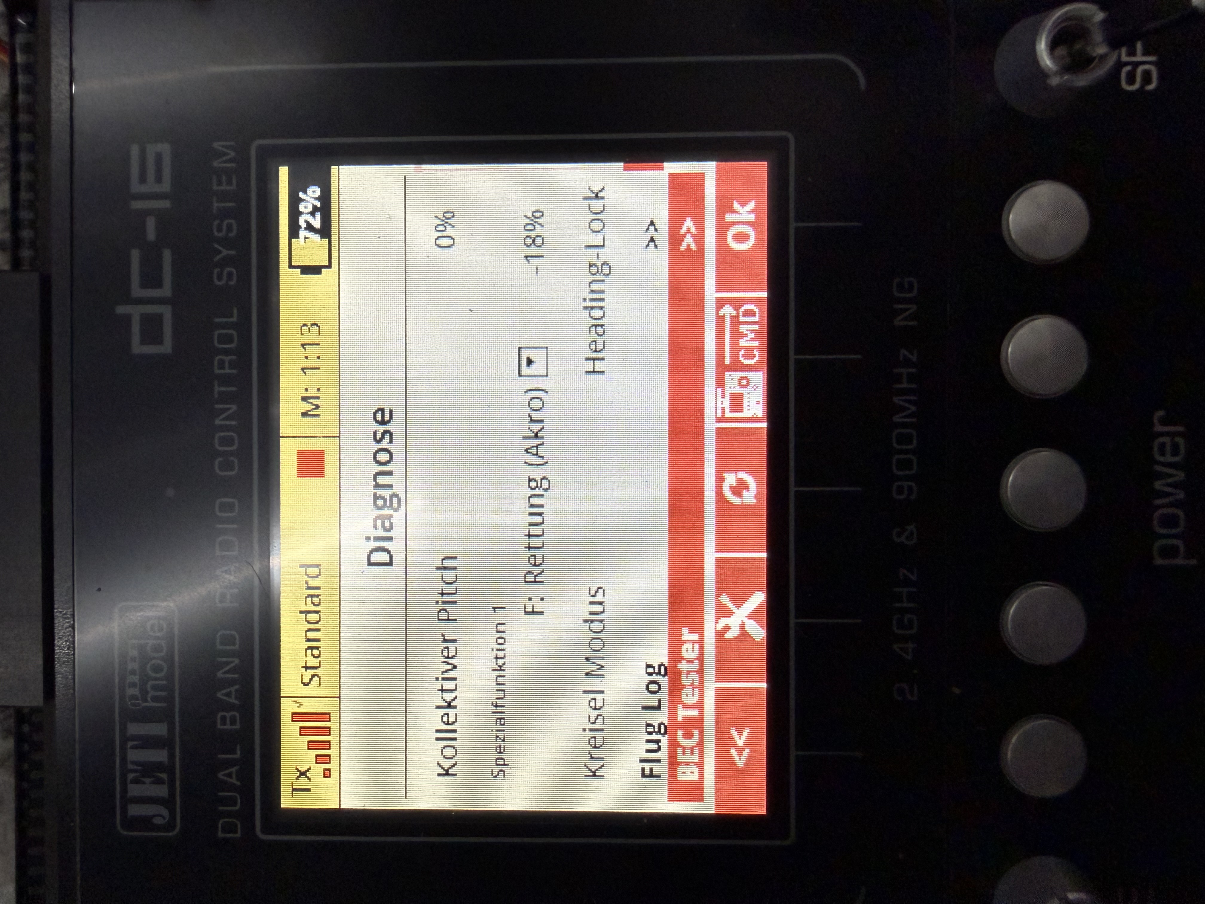

Flyfrank
Posts: 14
...and this is how it shows up in jeti integration
I think I better give up :-(

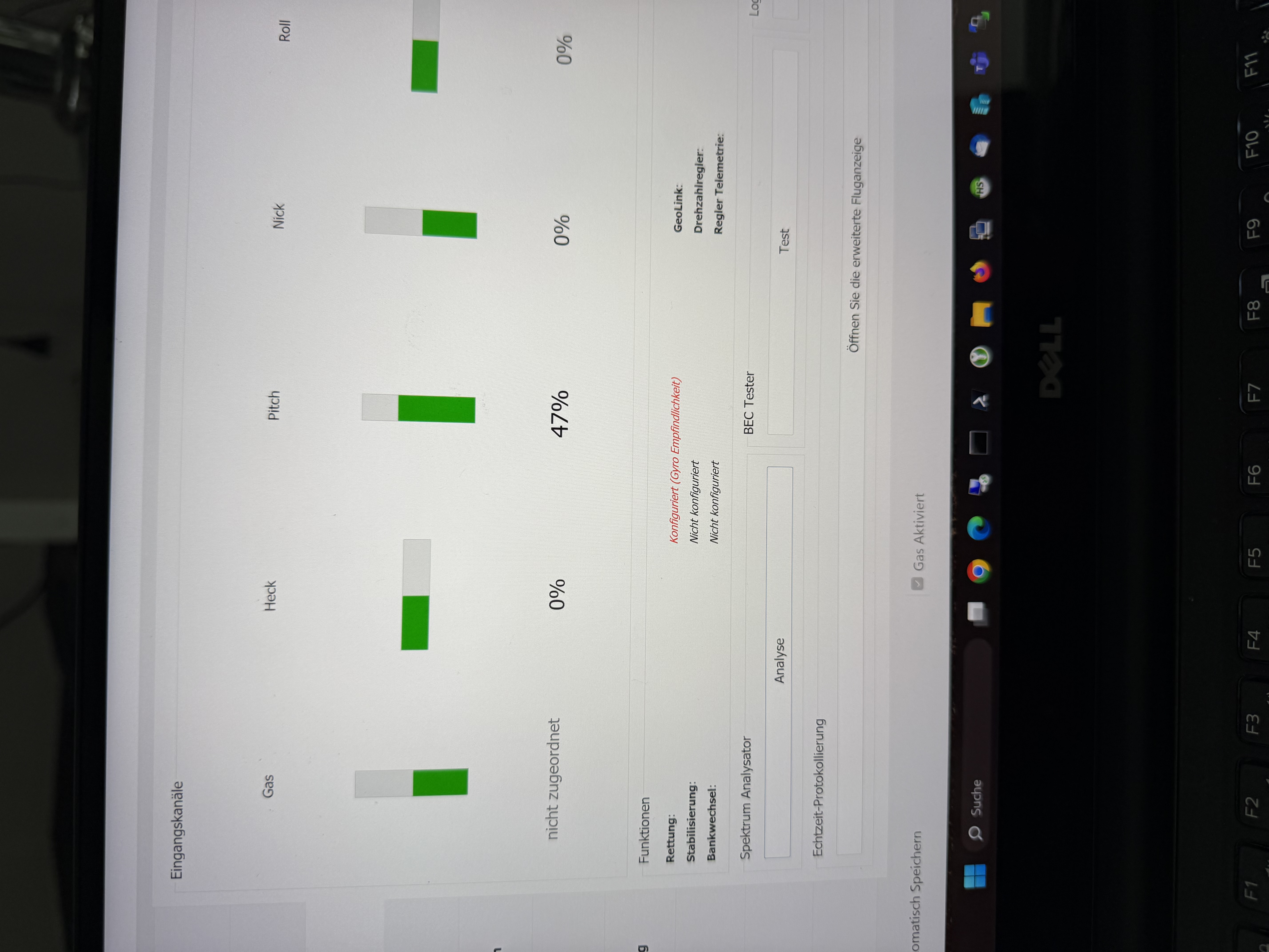

Flyfrank
Posts: 14
and last pic
