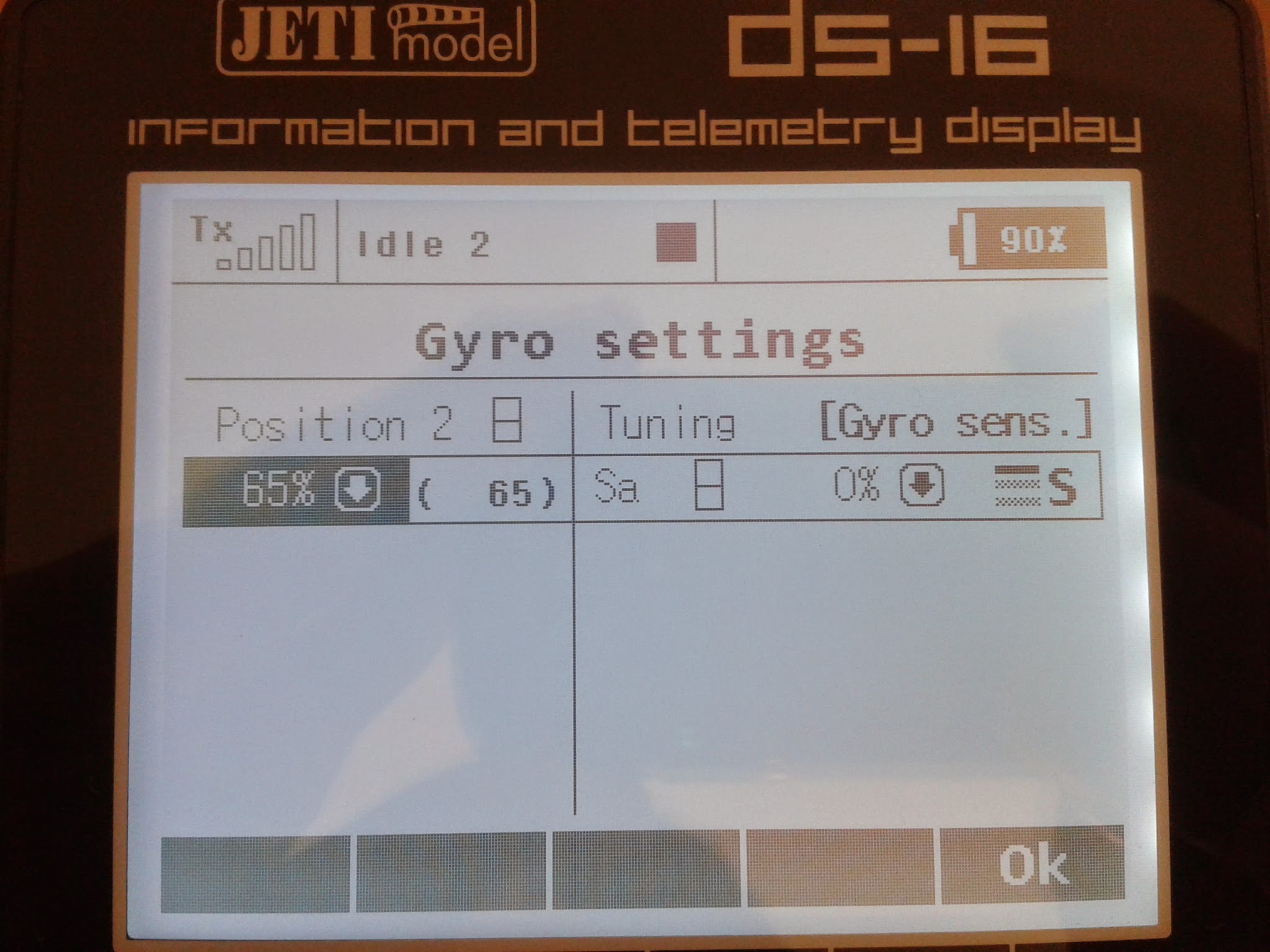

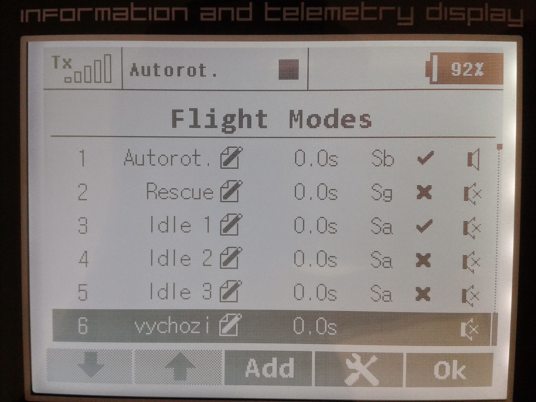

Posts: 12921
It is not that hard.
First from all you can create Bank function and assign it to the switch SE.
Then you have to create Flight modes and assign it to SA.
Here you have to create new flight mode "Rescue" and assign it to SG.
Make sure to change position accordingly, because position determines priority.
And lastly you have to setup Gyro Gains for each Flight Mode.
Check my screenshots.
This is the simplest way.

Posts: 12921
There is no mix or logical switch, SG will activate the rescue or stabilisation - depends on the current bank.
