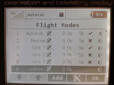

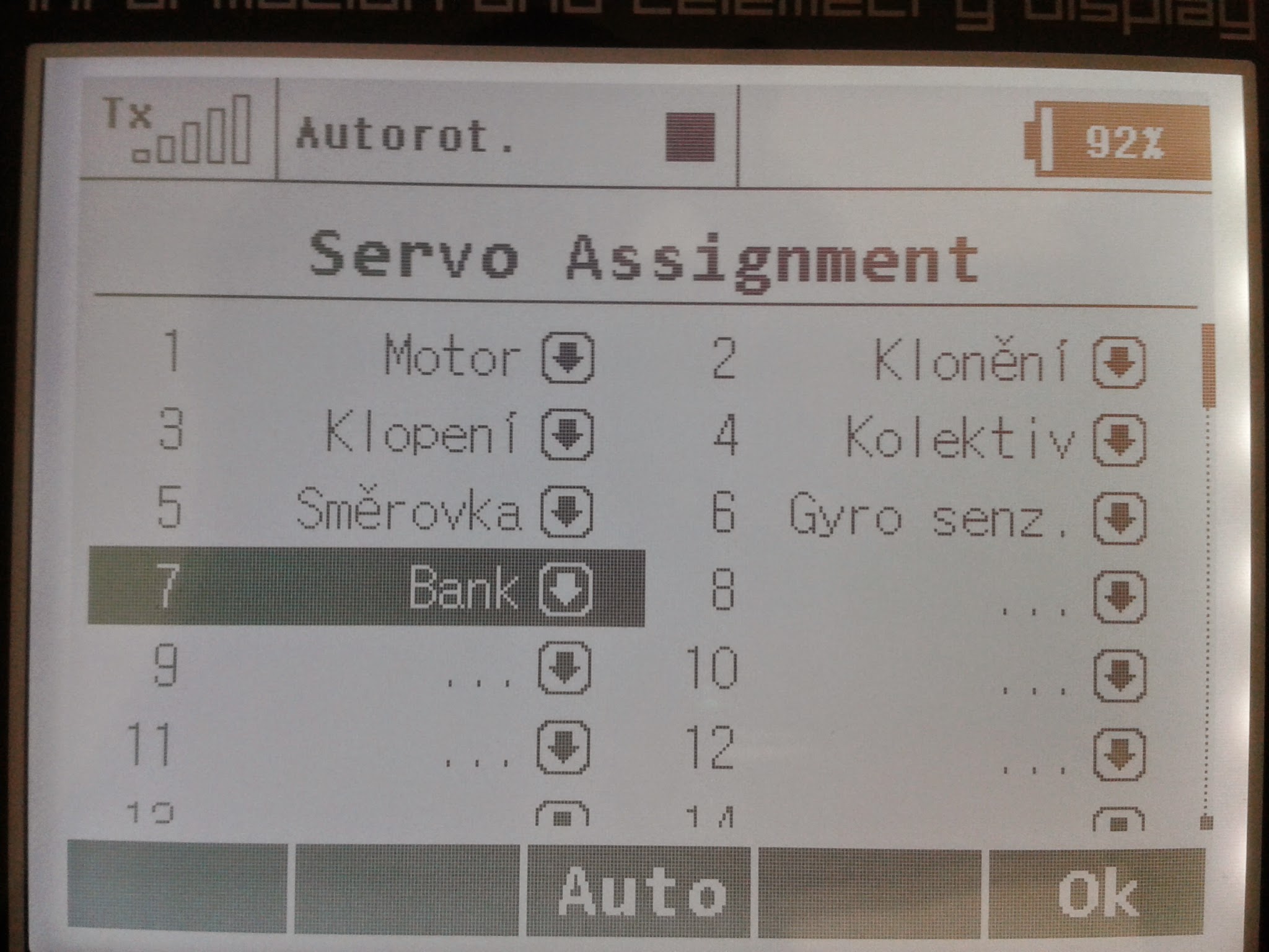

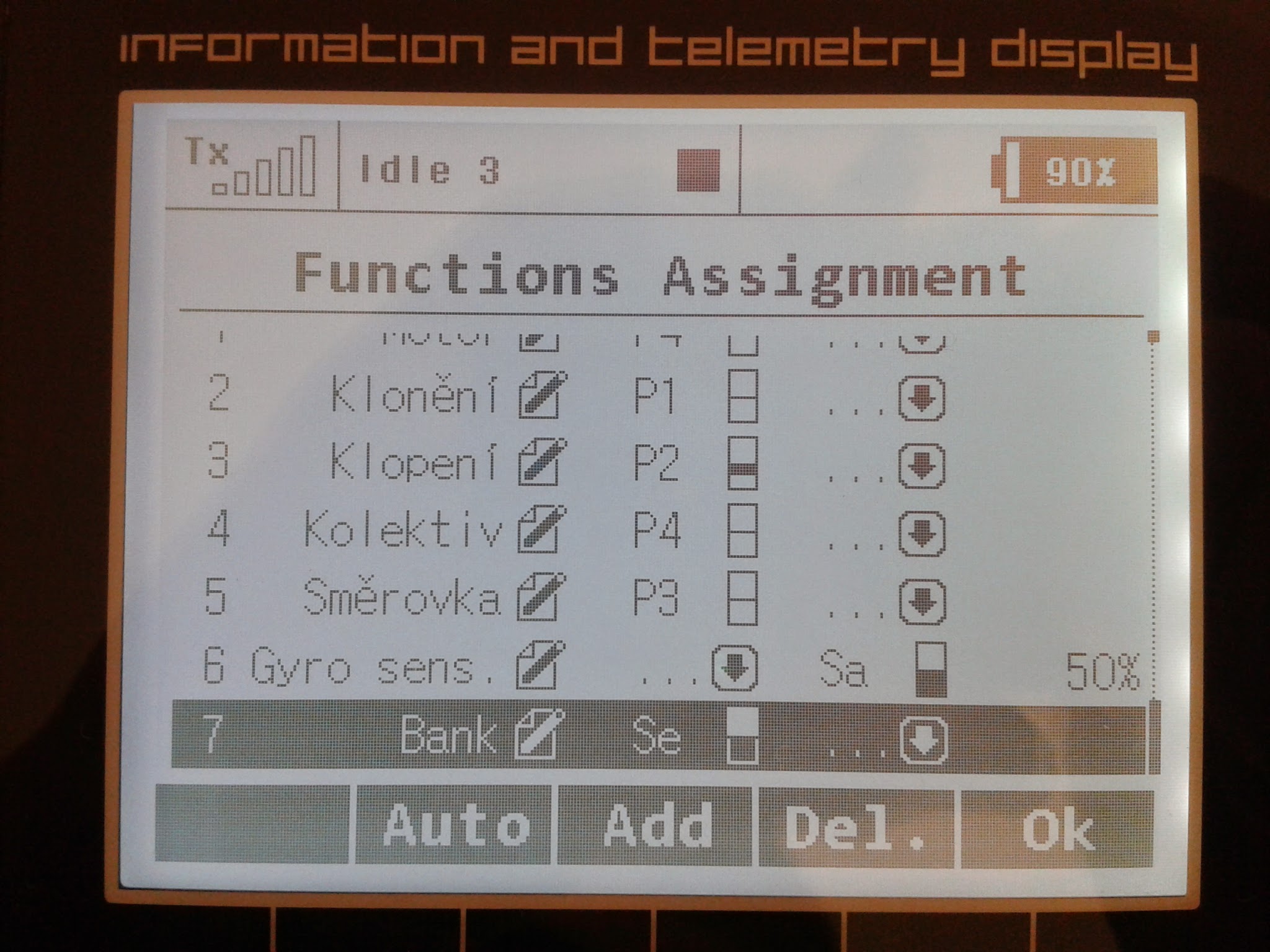

It is not that hard.
First from all you can create Bank function and assign it to the switch SE.
Then you have to create Flight modes and assign it to SA.

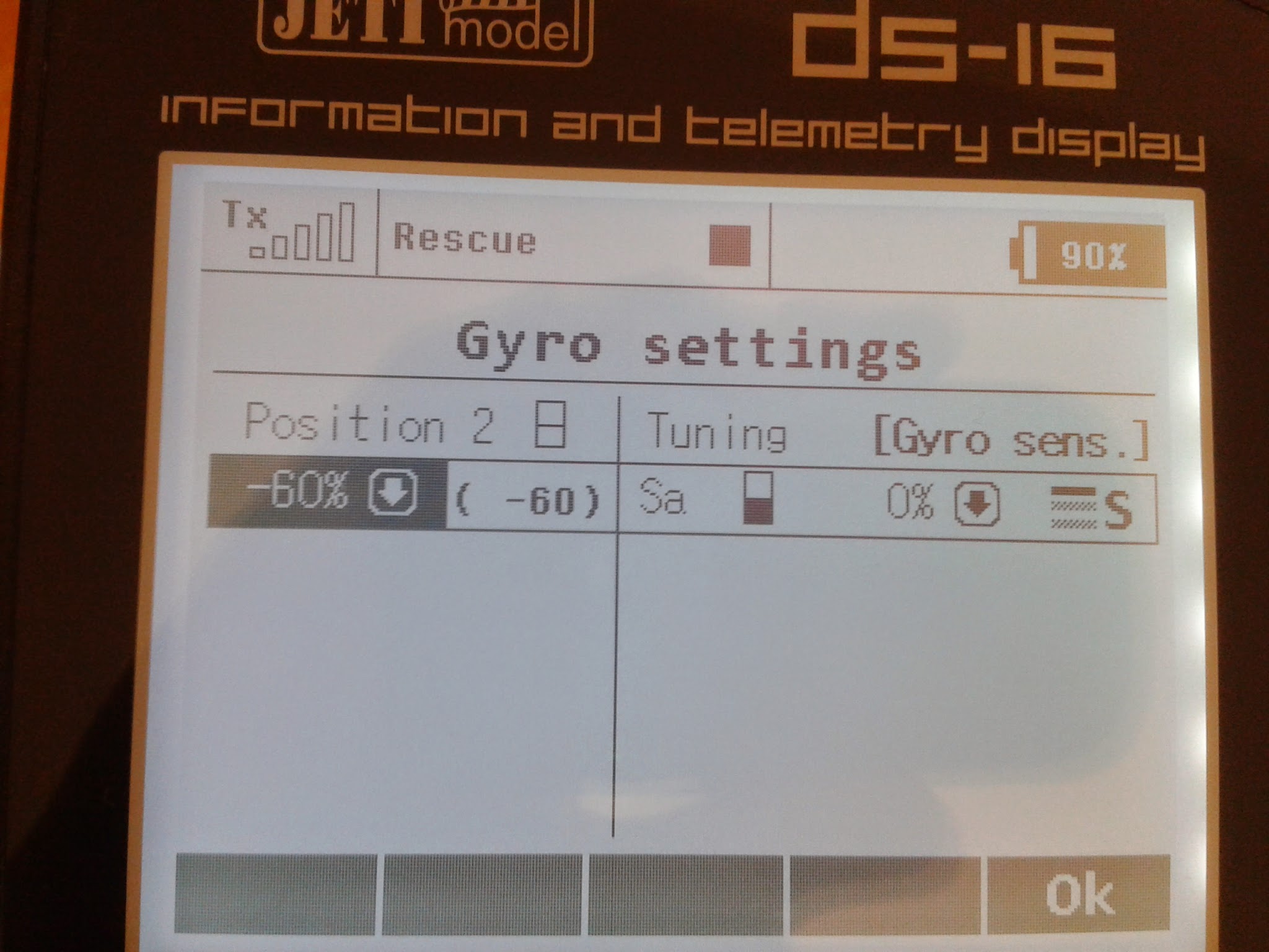

Here you have to create new flight mode "Rescue" and assign it to SG.
Make sure to change position accordingly, because position determines priority.

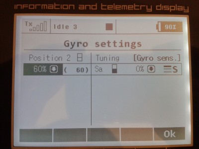

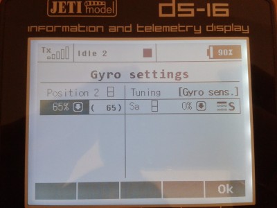

And lastly you have to setup Gyro Gains for each Flight Mode.
Check my screenshots.
This is the simplest way.

After creating a "Rescue" flight mode and assigning switch SG. How are you connecting this flight mode to the bank settings in the Spirit software? Are you using a mix or logical switches? Thanks!
There is no mix or logical switch, SG will activate the rescue or stabilisation - depends on the current bank.

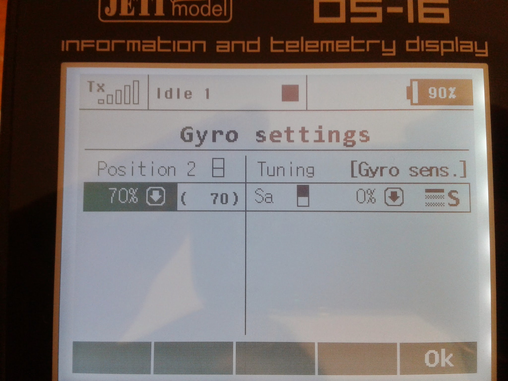

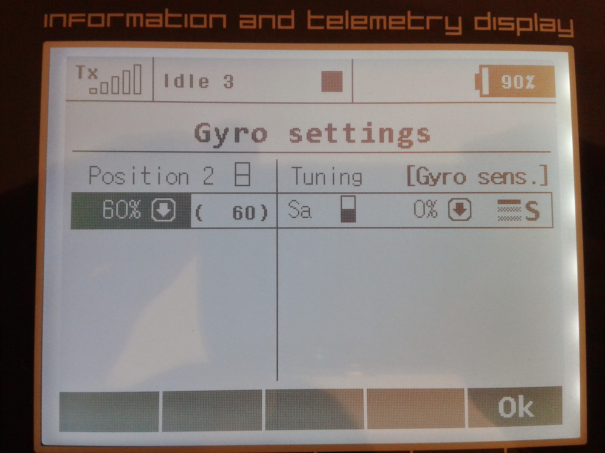

When I set my value to 70 here, my tail servo stops responding. I actually had to use a value of 49%. Anything higher than that and the tail servo starts to cycle back and forth erratically then it just stops responding to input.
Did I do something wrong?
Jeti DS14, Jeti R7 REX, Spirit Pro/EX Bus, MKS 669 Tail servo set to 760us @560Hz
The problem may be in travel range - it probably exceeds 100% in the diagnostic tab.
You can change travel for each channel in your transmitter to 68% - this should match with -100 to 100% in the unit exactly.
markrj
Posts: 6
Joined: Mon 02. Nov 2015 21:30:57
Yes, the Transmitter's travel has already been set properly. 68 is the exact number I use as well.
I see all 100s in the diagnostics tab.
