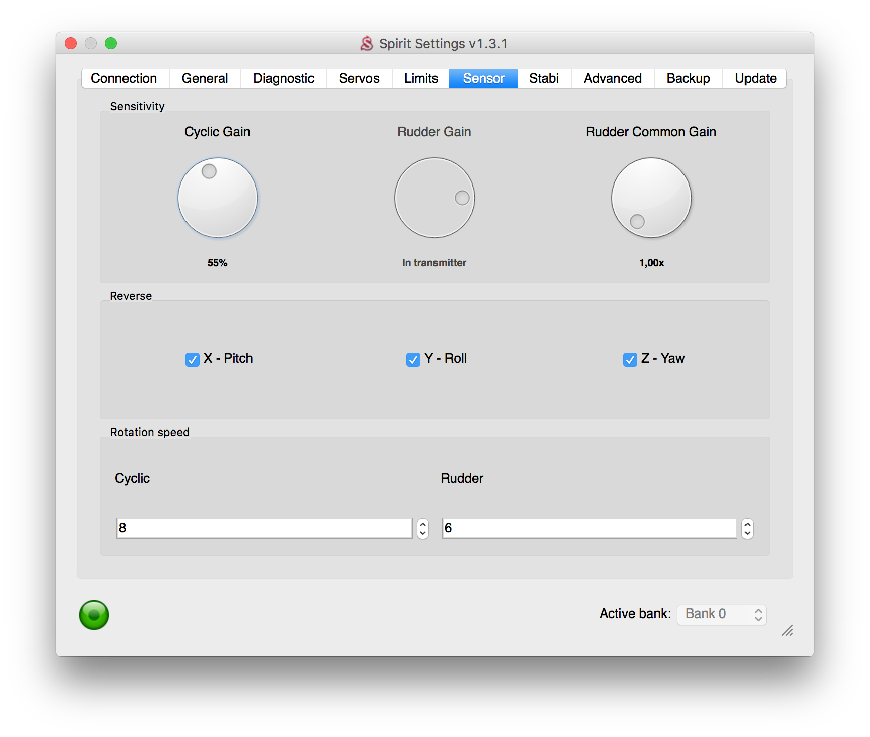

Rudder Dynamic: 7
Yes, that is what I based my tuning on today (and in the past).

So, which other Rudder dynamic values you tried?
Posts: 13047
The problem is often caused by too high Pirouette Consistency, lowering will help, but holding performance could be worsened.
You can try to decrease limit for the rudder (limit that is closer to the tail blades).
Also tail centering and servo arm can make a difference.
Can you share your whole settings, please? You can just attach 4df file and we can view it here.
