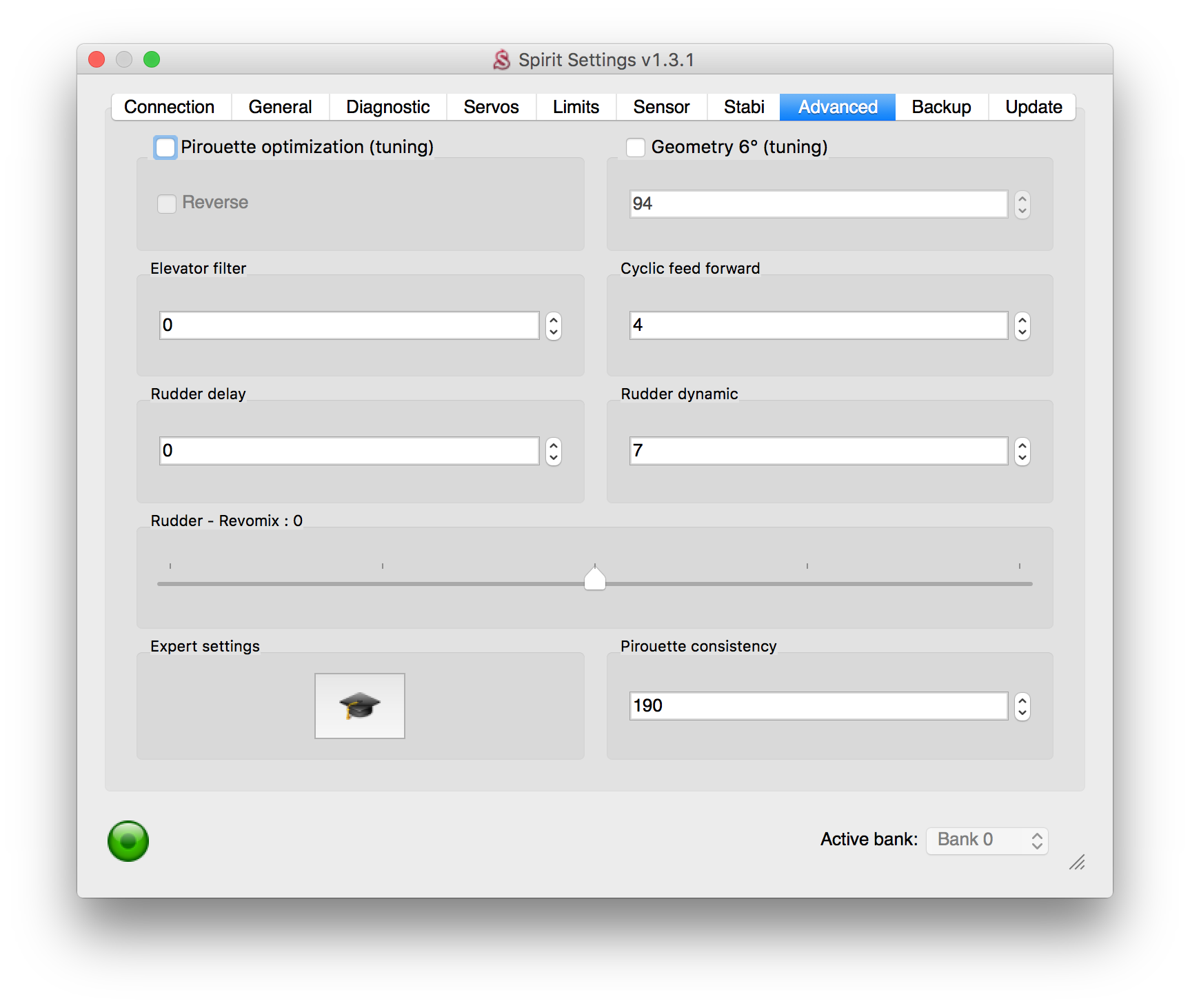

I am using:
Tail gain: 1x, 80%
Cyclic Gain: 55%
Rudder Delay: 0
CFF: 4
Revomix: 0
Piro Consistency: 180-195 (tried in jumps of 5)
Headspeed: ~1950 with a multigov
Tail blades: 106mm

So, which other Rudder dynamic values you tried?
The problem is often caused by too high Pirouette Consistency, lowering will help, but holding performance could be worsened.
You can try to decrease limit for the rudder (limit that is closer to the tail blades).
Also tail centering and servo arm can make a difference.

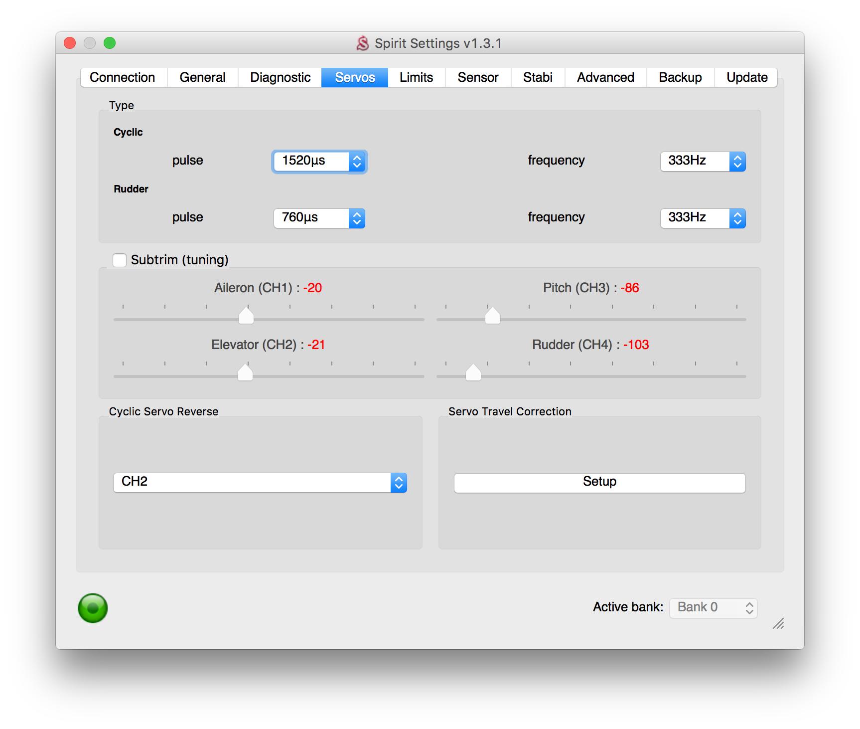

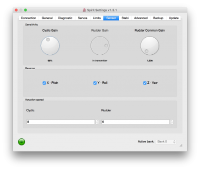

Can you share your whole settings, please? You can just attach 4df file and we can view it here.

Heres the setup.
- N7.4ds
- (255 Bytes) Downloaded 121 times
