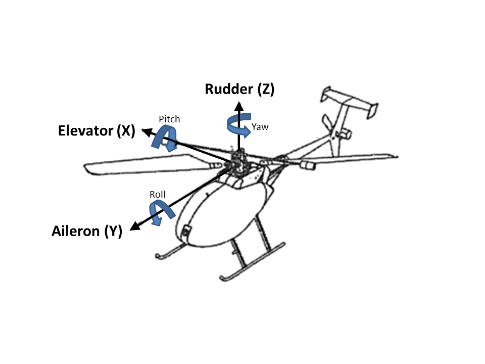

1. Do the X and Y axes in the Spirit manual correspond to pitch and roll, respectively?
Yes
2. Is the vibration analyzer in the unit reporting vibration along the axis (translational), or vibration around that axis (rotational)?
Rotational
btheli
Posts: 86
Joined: Fri 26. Sep 2014 20:08:26
Thank you Tomas.
Here is a crude graphic. The Spirit Spectrum Analyzer reports rotational frequencies about each axis shown in the graphic. For example, the "Z-Rudder" sensor axis graph displays the heli vibrations around the Z axis, not the heli vibrations up and down the Z axis. Hope this helps.

For me, honestly, that's intuitive.
Rudder axis vibrations are vibrations around the same axis as rudder commands.

Okay, I don't want to stir anything up, but here's the root cause of the issue for me: The Spirit manual uses phrases like "measure vibrations in three separate axes", "frequencies for the currently selected axis", "vibration on the selected axis", etc. It is not clear what "in", "for the" and "on the" mean when referring to movement, i.e., these phrases could be interpreted to be either translational or rotational movements.
