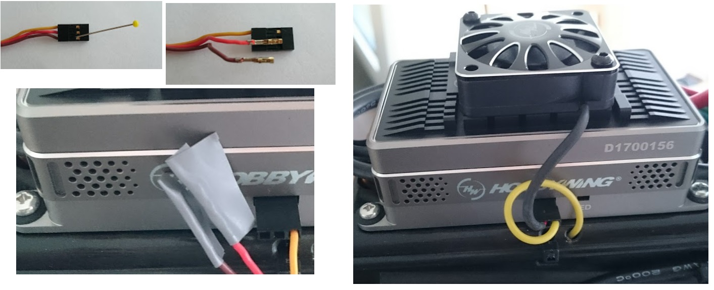

So, test it without fan, as you did with the Data cable, but take black and red wire pin out of the socket. So there is only the yellow data wire on the right plugged in (S). Make sure you isolate the pins you took out. Pins can be taken out with a needle to lift the little plastic lip and pull gently on wire.

I should unplug the fan completely than plug the Telemetry Cable in the Dataport of the ESC but only with the yellow wire?

On the left what you should do for testing with only Telem UNI Data Cable using it's data wire.
On the right my final cabling, where I just extended the yellow data wire from Spirit Telem UNI cable into the fan port.
