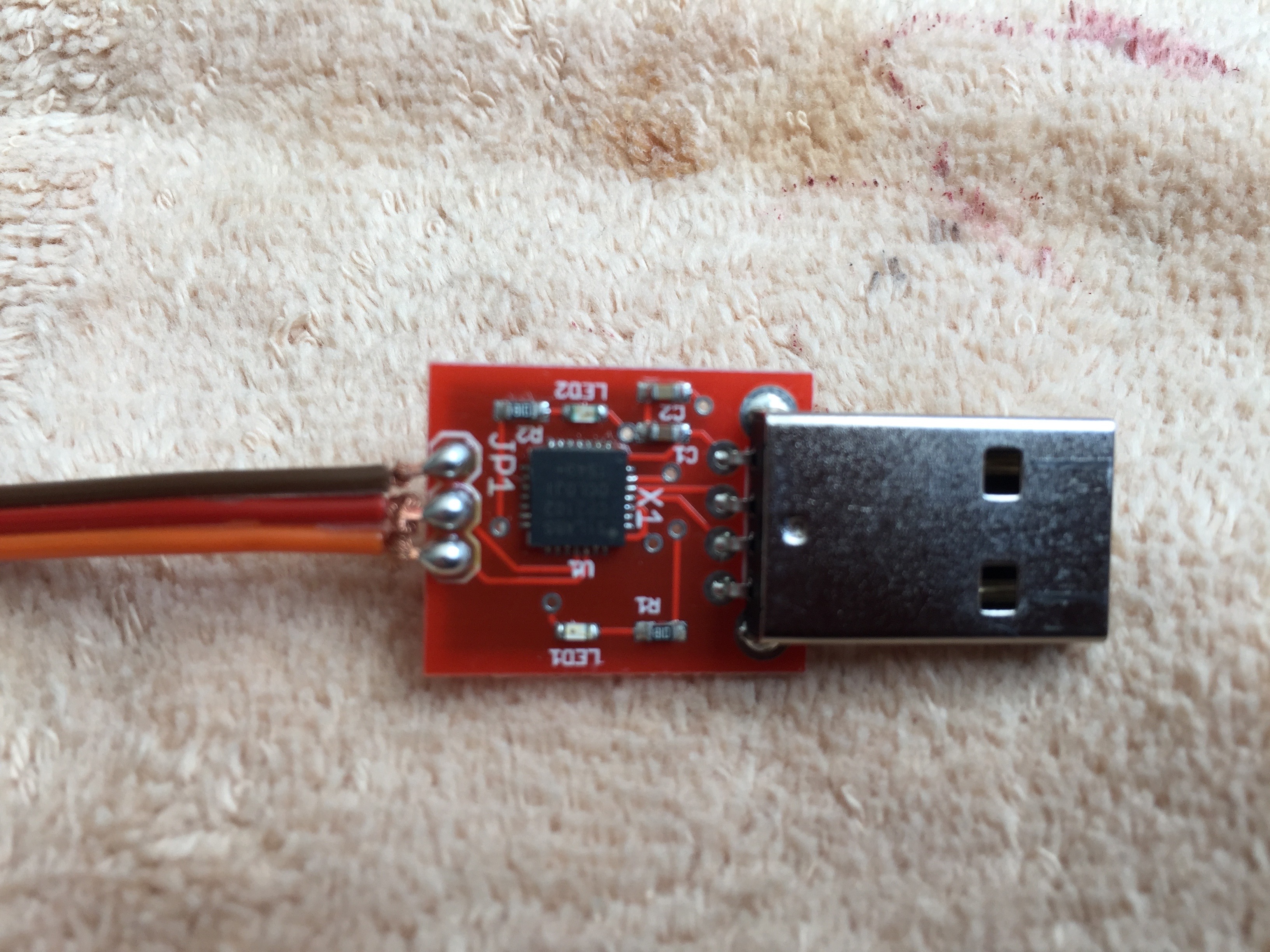

Hi!
I do not know what's going on, now it is not again. Again goes only the demo mode ...?
Posts: 12925
maybe the problem is again there.
From the photo I can see that there is some wire which is nearly touching other one.
Maybe it shorted there.
Franky13
Posts: 135
Joined: Tue 30. Dec 2014 7:50:36
Sorry Tomas,
the second photo is after the new soldering.
No cables or contacts touch on the photo.
Another idea?
Posts: 12925
Are you sure that you have not enabled for example Kontronik telemetry? This would disable USB communication as described in the Telemetry window.
