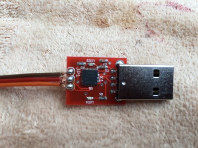

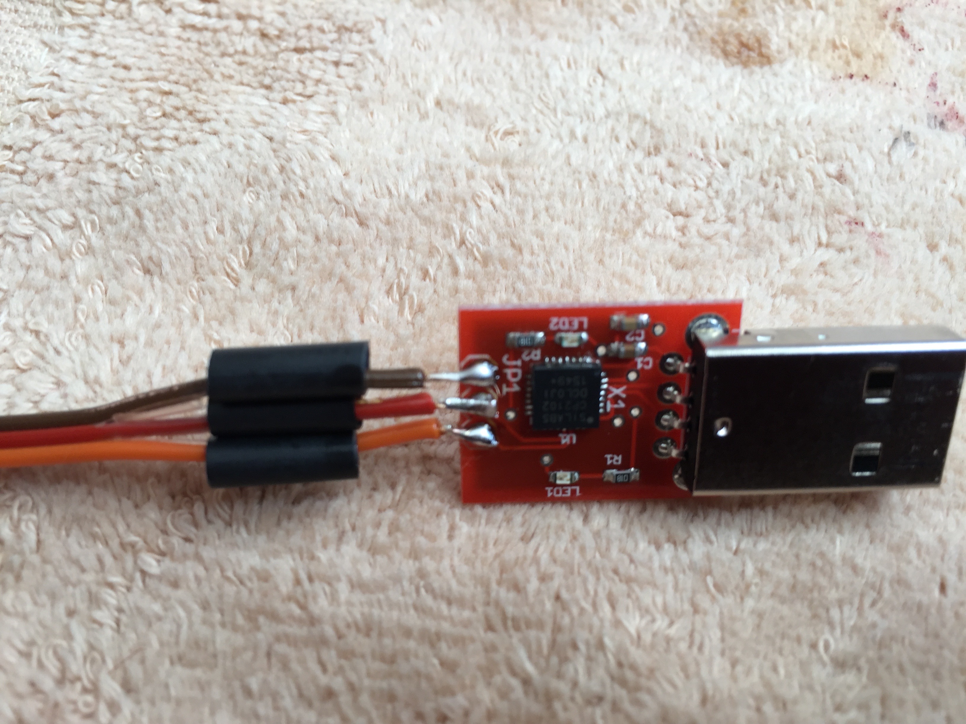

maybe the problem is again there.
From the photo I can see that there is some wire which is nearly touching other one.
Maybe it shorted there.
