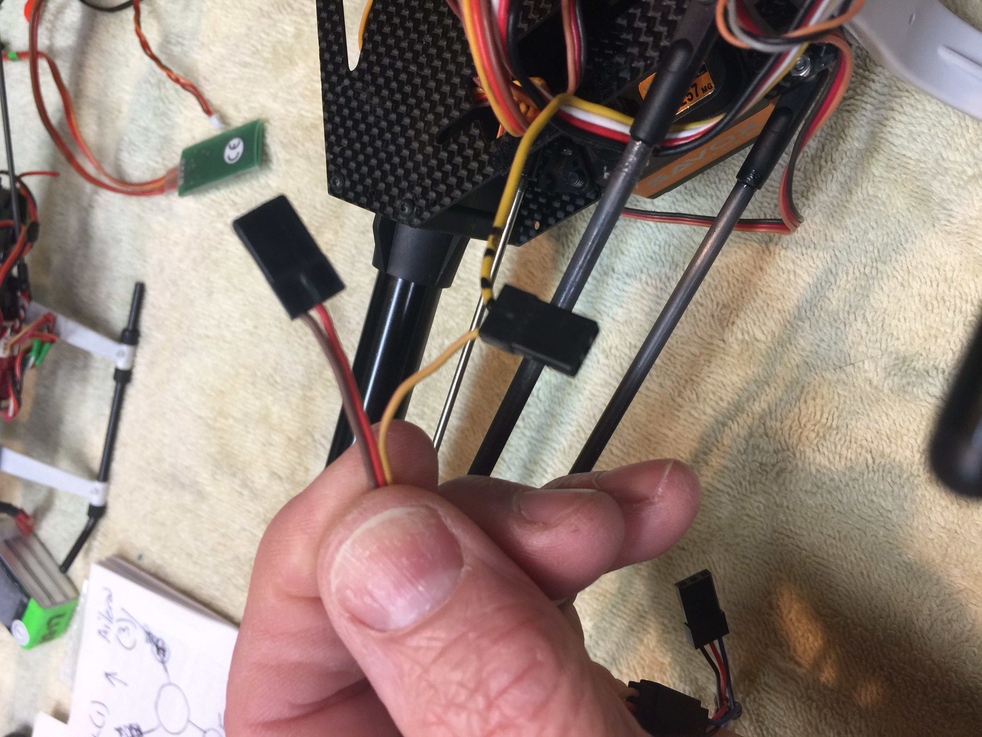

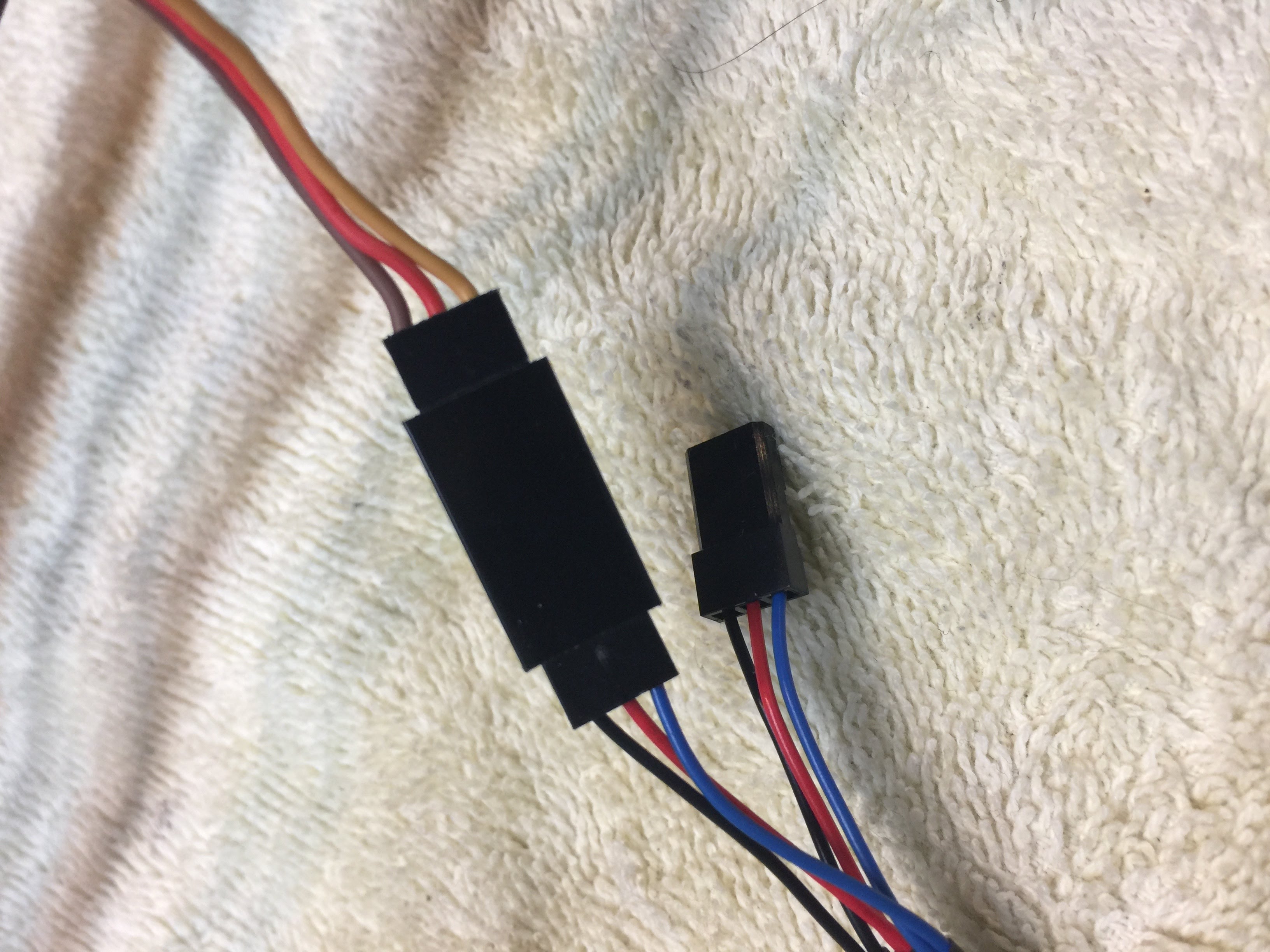

I made my own Jeti Integration cable.
I connected my HW output signal wire (yellow with black bands) to the center pin.

is the connection with receiver and unit working in some way? Are channels moving?
Your cables seems to be good.

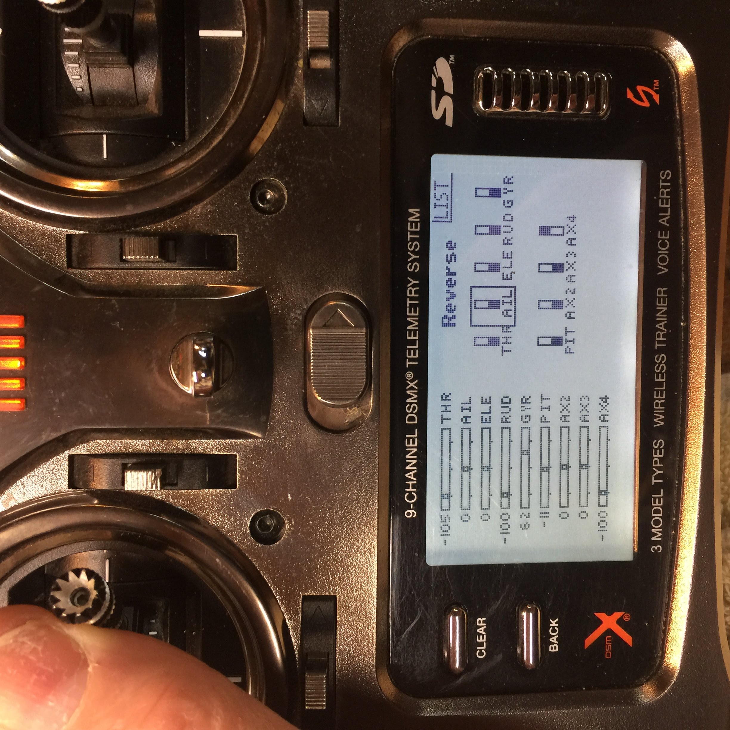

In the DX9 the Servo setup, Reverse menu - all servos are Normal except Aux4 which is my rescue. I noticed though Right rudder which looks correct in Diagnostic, sort of is wrong in the DX9 window where it shows "left" or toward -100. See photo here.
Other thoughts or tests I should try?
