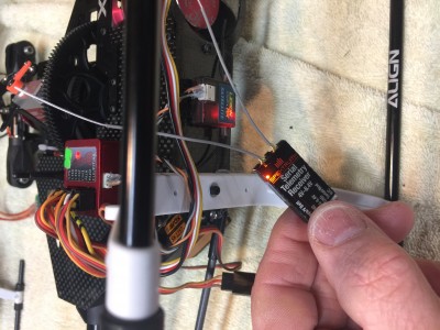

I finally put all the pieces together to try the integration on my Gaui X3 using a Red Spirit and DX9.
I updated the DX9 to 1.21.
I updated my Gaui to 2.4.3

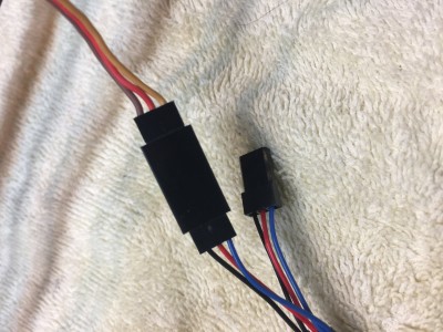

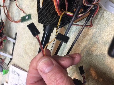

I made my own Jeti Integration cable.
I connected my HW output signal wire (yellow with black bands) to the center pin.
When I start it all up, I seem to have solid lights and get RSSI shown on the first telemeter screen when I roll to it. As I walk away from the heli, the RSSI drops. This seems to show it working.
When I move to the Text Screen I see the "bars" in the upper left corner which I think means telemetry signal available, but nothing on the screen.

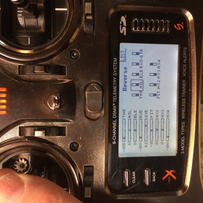

In the DX9 the Servo setup, Reverse menu - all servos are Normal except Aux4 which is my rescue. I noticed though Right rudder which looks correct in Diagnostic, sort of is wrong in the DX9 window where it shows "left" or toward -100. See photo here.
