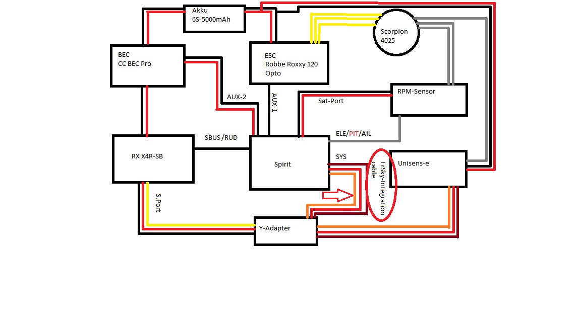

unfortunately if FrSky integration cable is connected for longer time (more than a minute) it could damage processor and either the FrSky integration cable. If connected in the wrong way the cable will become very hot first, then something can fail. Probably we should make it more clear or add a protections so it can't happen in the future.
But don't worry, we will repair it in one day and it will work perfectly again.
Regarding your connection it looks good, except I can't see the FrSky integration cable. I would just connect both BEC leads to the unit. Second can be at the CH0 port.
no connection to Software
Hello Tomas,
I mean, the cable did not get hot, but I am not sure. It was probably connected incorrectly for more than a minute. It is already clearly described how it is connected correctly. Another sketch: Is it really that correct? That's exactly how I wired it first. But Horus and Spirit could not communicate, the Lua script showed only empty masks. In addition, the telemetry data was not transmitted reliable by Unisens-e. This only worked sporadically after a few reboots. That's why I had the FrSky cable trial connected wrong - with evil consequences ...
yes, it looks to be correct. Just putting secondary BEC cable to the unit would be better.
The only important thing is to connect the FrSky integration calbe in the right direction. There is longer and shorter end which points the direction how it should be connected. Longer cable should be always at the SYS port.
