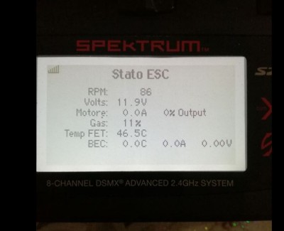

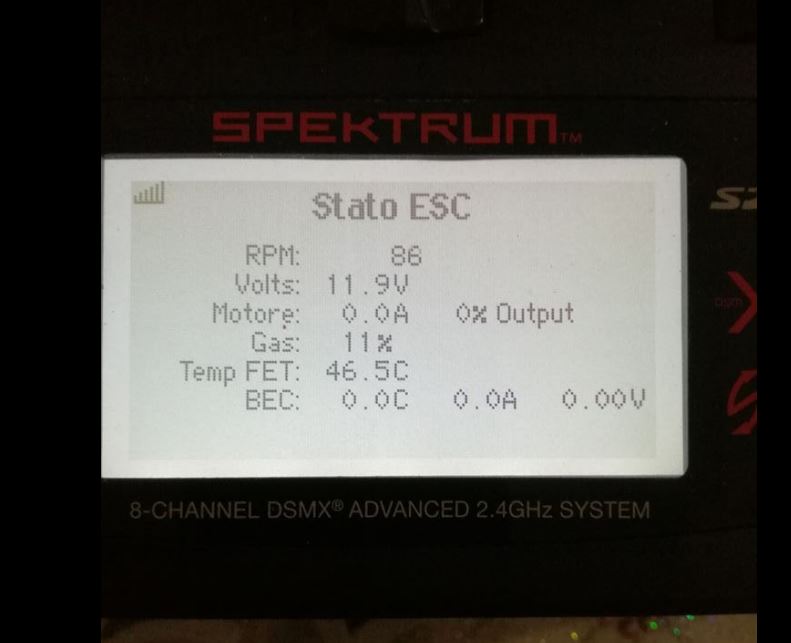

OK made the connection now works, the temp grades are exact those of the esc and also the volt.ma I see the line / motor fields and bec empty. Is this normal? as photos Thanks
Posts: 13049
Yes, this is normal with this ESC. You can get additional telemetry data by connecting a wire directly to the SPM4649T receiver.

Yes. You won't get any bec data and motor data will only appear as you spool up the heli.

Note: My hely when i shot photo from radio,it was on,why the engine data were still?

ZeXx86 wrote:Yes, this is normal with this ESC. You can get additional telemetry data by connecting a wire directly to the SPM4649T receiver.

what do you mean by wire directly?where , in which port on spm4649? other additional sensors? where you add cables to spm 4649 t? I have only one free port now on spm 4649, the jst 2 poles/where u can connect laps/V batt
Posts: 13049
Yes, this is what I have meant.

Ok Perfect, then I feel confirmed that for now on the 2.4.3 firmware without additional sensors but only with the 4649 spm, and with compatible ESC, the only data you can receive are:
1) Rpm (from esc)
2) Volt (from esc)
3) Temp Fet (from Esc)
The motor data 0.0A and 0% output are always stopped.

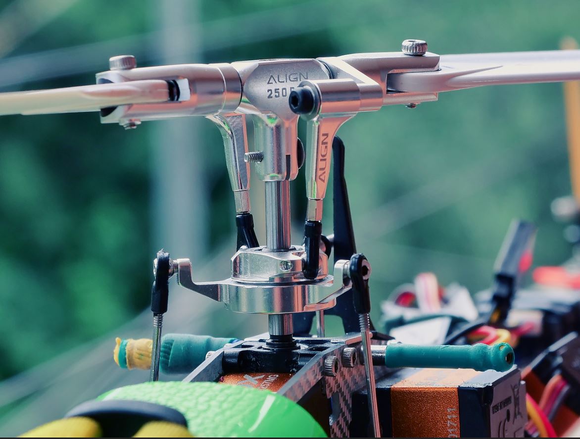

Last question the gps when it will be released? and if possible one day find and where quality cables already crimped Jr / futaba to jst, I ask why on heli small size, the additional links plug/conversion take up space, when use microspirit.
there is link my video
of my heli (OLD TREX 250 SE)working perfectly with microspirit both mechanical flybar, and dfc (now) AS PHOTOS
