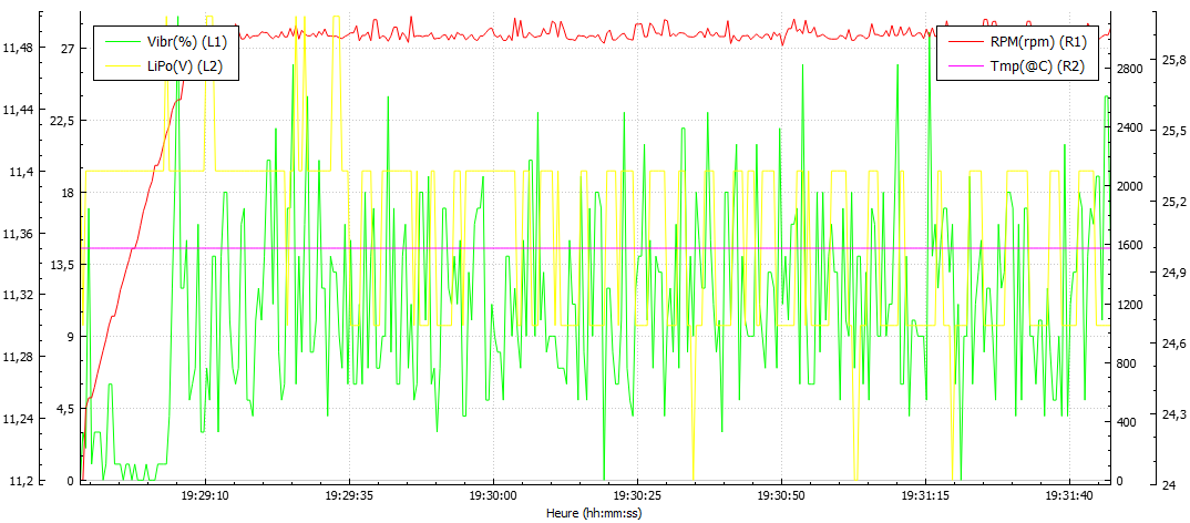

On my Taranis X9D+, I do see the RPM coming from the ESC (through the Spirit unit telemetry port) and also the vibration (in %).
However, something is wrong about other parameters.
According this page << HobbyWing Telemetry >>, I know that the Platinum 60A V4 will not report the current.
However, I'm expecting to get the LiPo pack voltage and the ESC temperature.
Looks like, it isn't working.
The temp is always reporting exactly 25°C without any variations...
The battery voltage is always around 11.4V...
Unfortunately for me, I relied on the LiPo voltage to trigger my landing alarm... :( Since the voltage is always 11.4, the alarm didn't trigger and the ESC shutdown protection was a bit too fast...
Fortunately, the landing wasn't too hard. Nothing was broken.
So, any suggestions why the Temp/Batt voltage telemetry data aren't working?

PS: I attached the telemetry plots.

I think that the problem is caused because the ESC has old firmware that does not support telemetry yet.
It is necessary to update it with HobbyWing software to the latest version. Then I guess it will work immediately.
Values you are seeing are default - you will see the same even if Telem UNI is not connected.

OK, some news.
The firmware version was PL-04.0.05.
The upgrade to the version PL-04.0.06 went well.
But, still no telemetry... :evil:
I started the real-time telemetry from the HW interface. All values were correct.
Then I realized something by checking the wiring: I got confuse between the RPM wire (fast and real-time) and the telemetry wire (slow serial connection)...
In others words, I simply didn't plug the Telem UNI cable. :cry:
