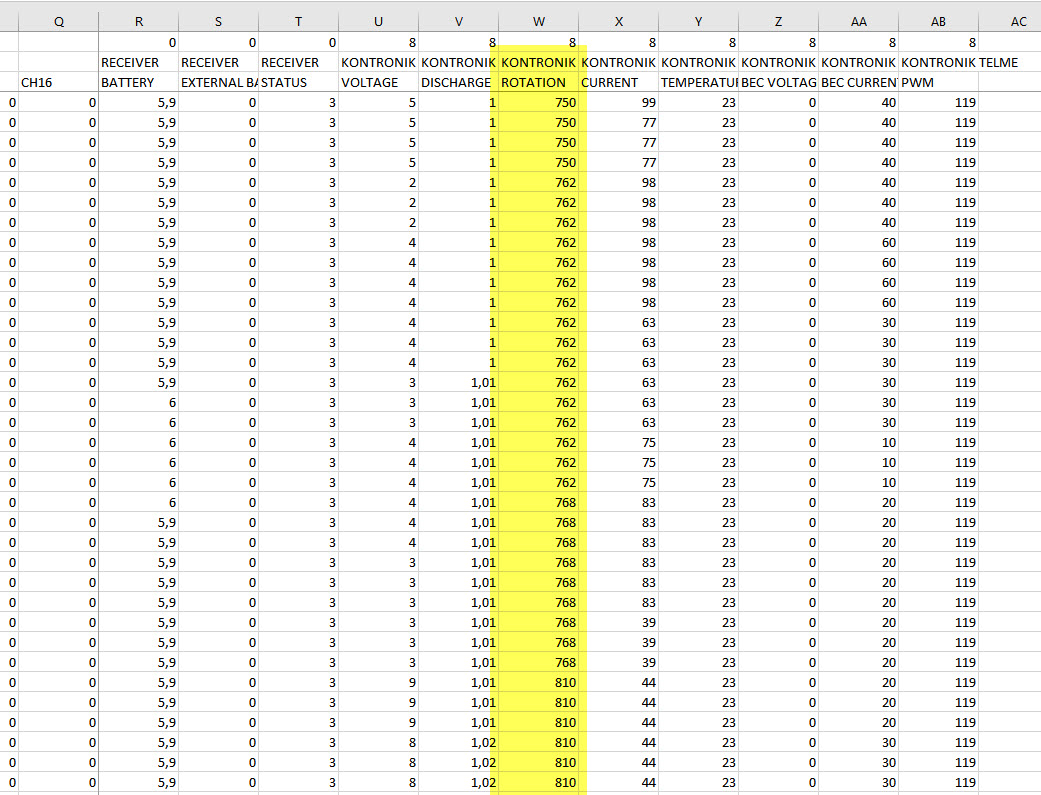

I checked this now and it does not reach the real rpm, it is quite too low.
Also I cannot find the gear settings in the Wlan HTML Interface. I attached two screenshots, as I understood it should be visible there...
