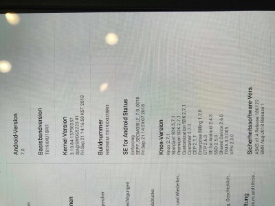

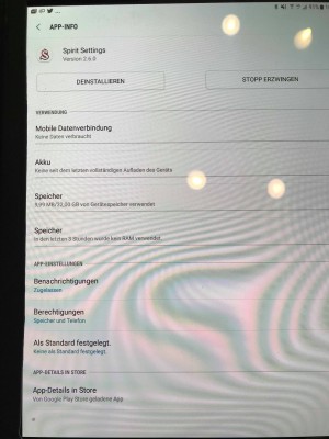

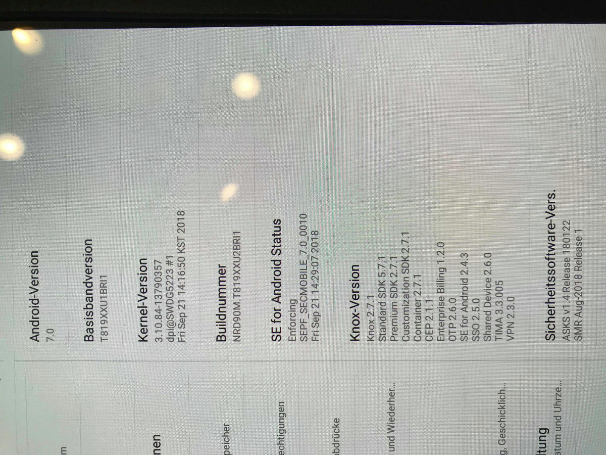

Hello serviceteam,
are you talking about setting file for the modell? Or did you mean android version and information like that ? files attached with information needed
br siggi
scvflyer
Posts: 101
Joined: Wed 22. Jul 2015 16:02:51
tablet information
