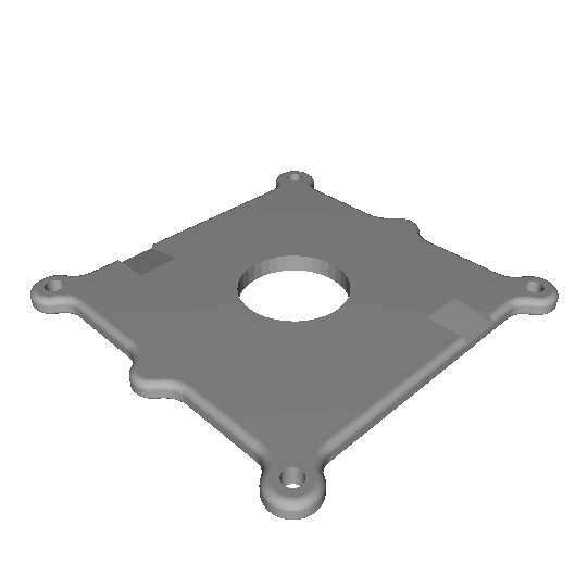

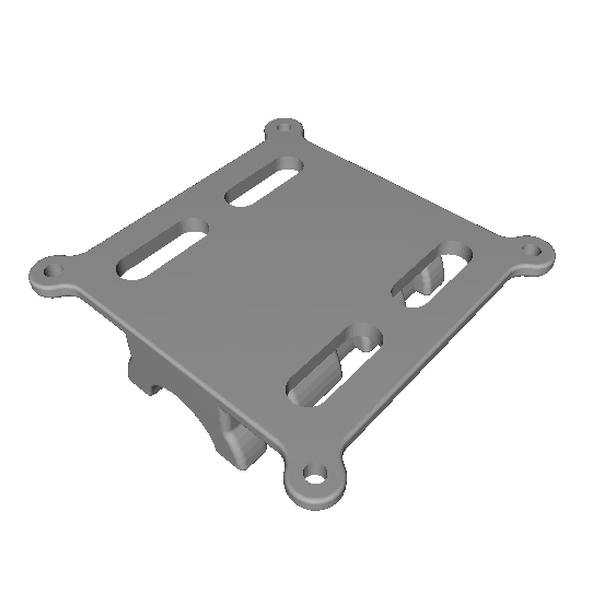

Sorry for my late replies. Yes, I improved my design and already fixed the Geolink in the heli. My test model is Trex 450L My final design is as below:
Top part where the Geolink module will be mounted using provided 3M tape
Bottom part which will be mounted on the tail boom using 2 or 3 wire ties.
In addition to the above 2 parts, I used M2.5 nylon bolt and nuts with nylon flat washers to keep the 2 parts together.
Total assembly is about 14.0g as per my scale (excluding Geolink weight). I had to add extra weights to the front of the heli to maintain CG. Since my 450L is for experimental use, I didn't mind the extra weight. However this might be a problem for some of you guys whom are more concern with the performance of the machine.
