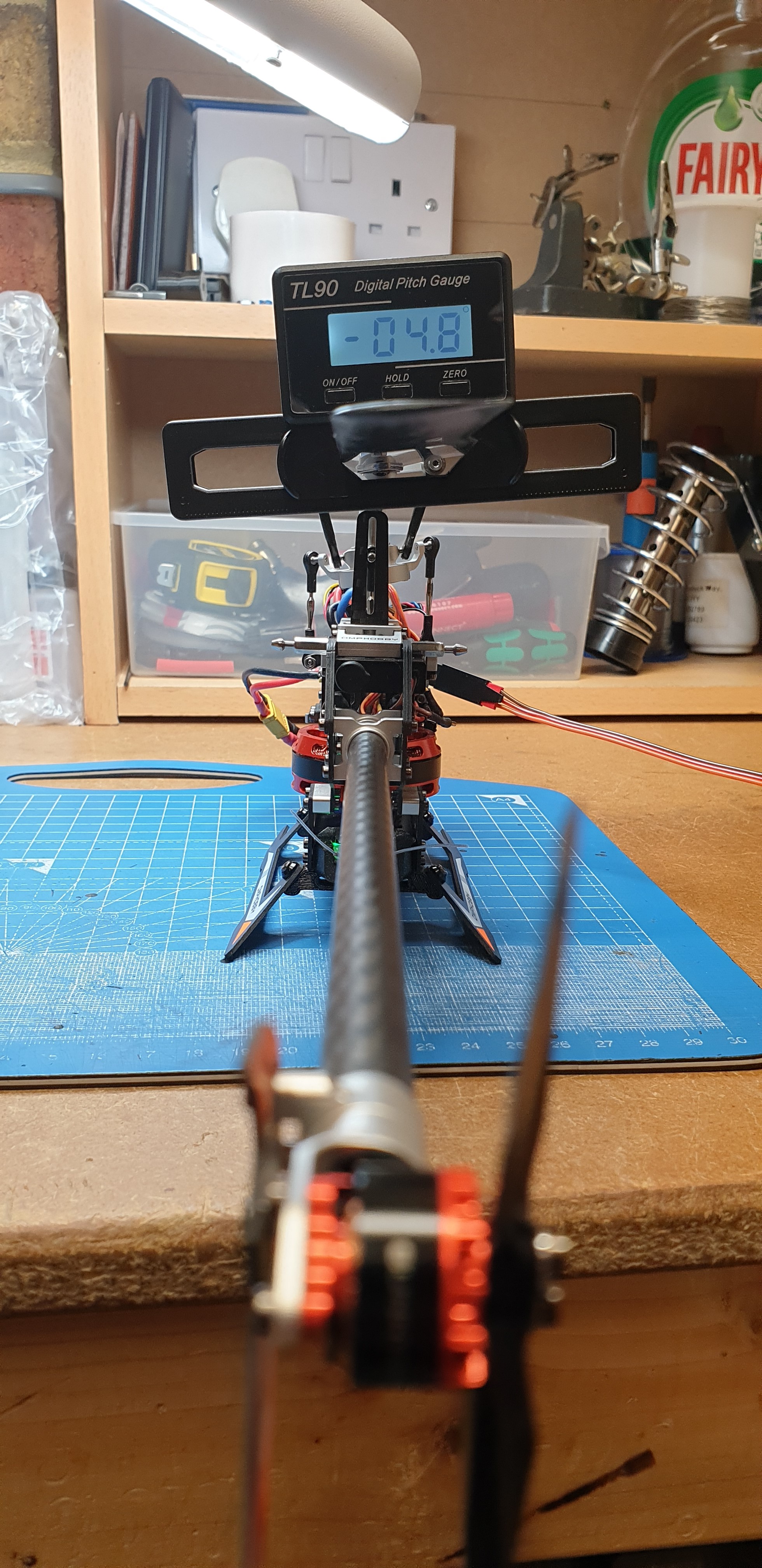

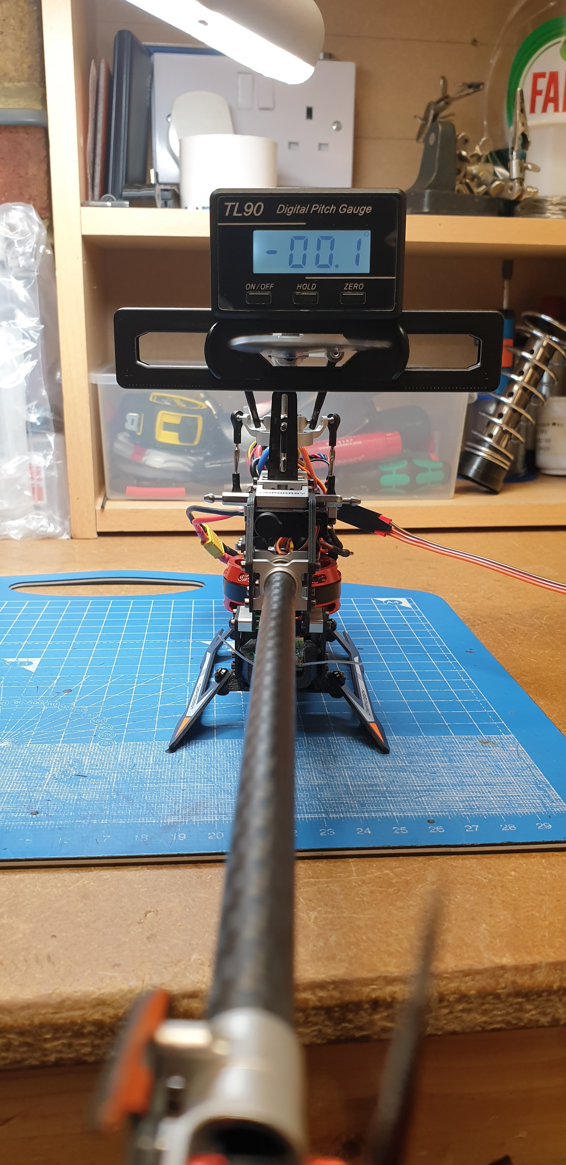

fassla wrote:can you take a picture how you measure the 6deg ?
As per Manual...."It is necessary to set the value so that the blades angle is at 6° in the aileron axis. You need to rotate your rotor head with blades to be parallel to the longitudinal axis of the mode
Hey buddy.
Sure, I'm checking it the way it is advised to do so and with the way the swash leans over it can only be checked like this.
Ian Contessa
