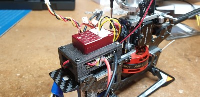

I'd like to ask for some advice please, basically I have converted an OMP M2 to use a uSpirit with two seperate ESC's for main and tail. Setup has gone well and I have gone through the various tail motor settings and all is well.
However when I go to test fly the model, while it does fly and I have control, the disk is wobbling really fast almost as if the cyclic gain dial has absolutely no effect on the cyclic gain at all.
I have tried with it all the way down at 20% and it still does it, I've even gone back up to 60% and it's still there. Apart from changing the rotor RPM which then changes the frequency of the wobble, nothing helps.

Thanks for coming in and also for the compliment on the layout, I am quite pleased with how it's turned out and will no doubt make subtle changes as I go along. Have another Little Bee ESC coming in with the older BLheli for the main motor, as the current one is BLheli_32 which I cannot flash the MAIN firmware to.
