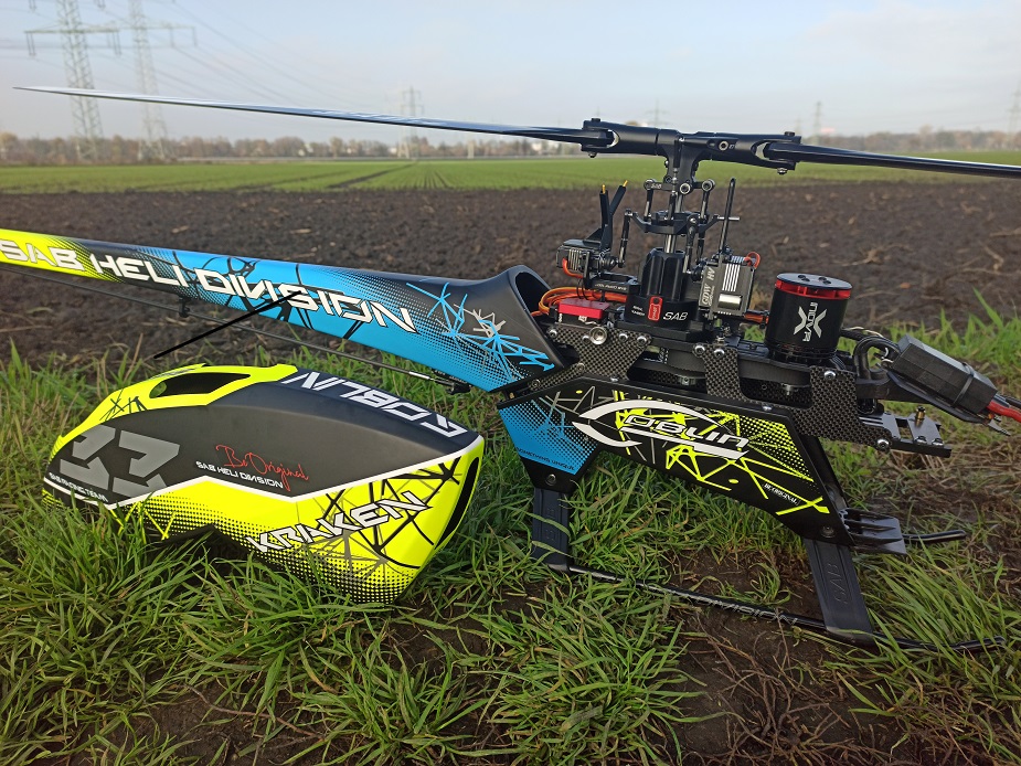

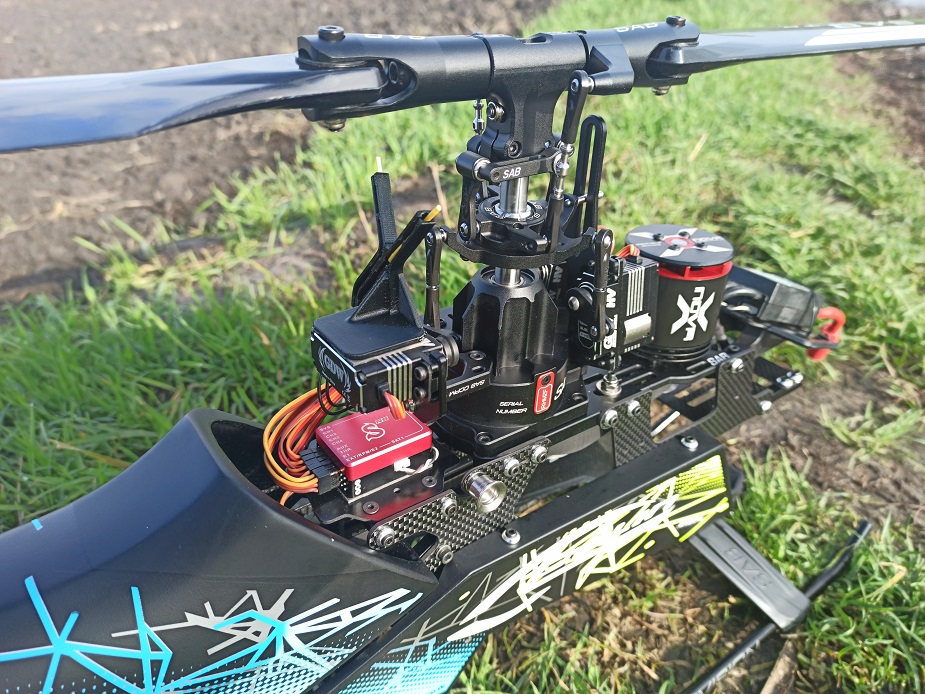

i share my Setup for the new SAB Kraken 580 maybe it is helpful to someone
Setup:
Spirit RS
Swash 3xGDW BLS590 - 17mm
Tail 1x GDW BLS895 - 18mm
Xnova 4025-560
Jive Pro 120
12s 3300
SAB 570 TB
SAB 95 TB
i work nice with the stock blades or MS Rapid 580 blades between 1800 and 2400 rpm
Best Regards
Timo
SAB Kraken 580 Setup
- Kraken580.4ds
- (255 Bytes) Downloaded 398 times
Hi there
Just wondering if you had any issues getting the cyclic range centred (e.g. 12+ to 12-).
I have the same setup (GDW servos etc) but only seem to be able to get a equal range of travel by winding out the Blade Grip linkage rods a fair way (and starting to worry how much thread they have to be secure).
When I wind the Servo linkages out a touch to compensate (and reduce the length of the blade grip linkages) then I cant seem to be able to get a even cyclic range (ie end up with something like 10+ to 13-).
Any help would be much appreciated.
Cheers
