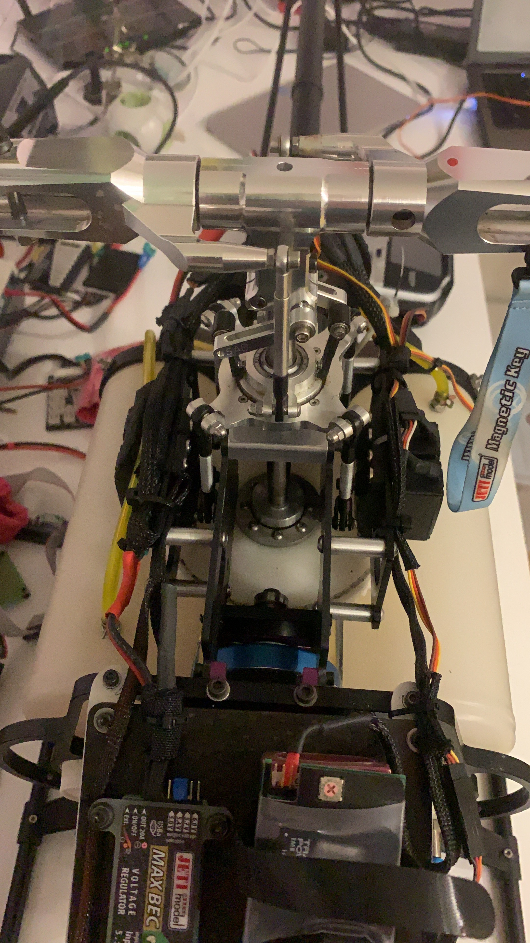

I have an jetcat pht3 turbine with 4 servos on swashplate. The problem is that the spirit pro can only H4 90deg i need H4 90deg +45deg.
No it is a hc3sx mounted on the turbine but i would like to fly with the spirit.
So what can i do?
Is it possible to get an update in the future where this will work?

what you are looking for is on the EXPERT SETTINGS page.
Cyclic phase:
The value indicates the angle by which the swashplate is virtually rotated. For example a value of 90 will rotate the elevator to aileron. This feature is recommended for models with multi-blade rotor heads. For most other models, we recommend a zero value.

Have try this to change to minus and plus 45 but it will not work
Posts: 12851
for sure it can work with Phase angle rotation. We have many scale pilots with similar helicopters.
If not +45° then -45° can work. Then only correct servo reversing is needed.

okay will try again. Can you say me how i have to plug in the servos then?
Servo ch number on spirit
front left ?
front right ?
rear left ?
rear right ?
