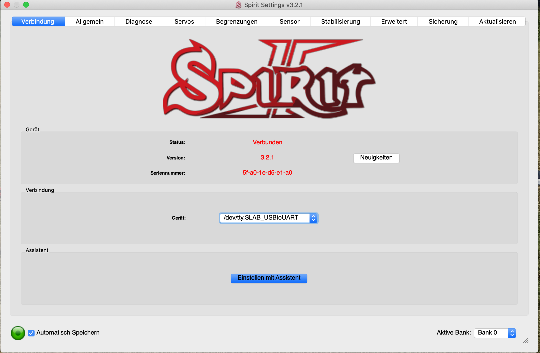

yes, of course Settings 3.2.1 is in use (and all units are on 3.2/3.2.1 before)... on both macOS and Win. i've just done again and documented with screenshots for you.
best regards
Michael
2. macOS, 3.2.1 upload failed
1. macOS connected, Settings 3.2.1, unit 3.2.1

You can try to download the latest USB drivers for Mac.
https://www.silabs.com/documents/public ... Driver.zip
Then after reboot retry.
So the software is waiting after clicking the Flash button? And then after few seconds you can see error, is this correct?
