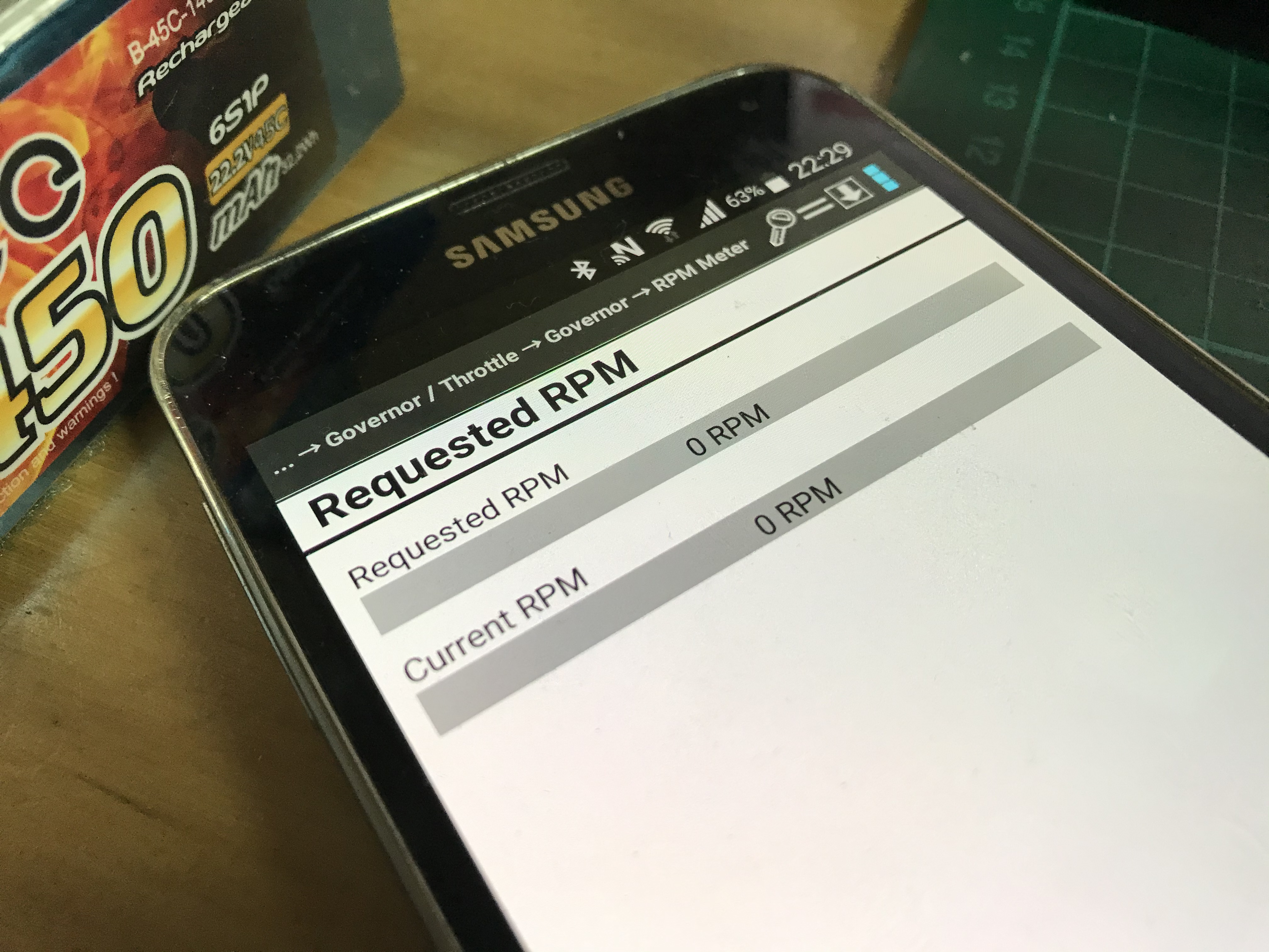

I have connected everything. Futaba see correcly a telementry and a RPM information. I have problem with FBL unit, becouse I checked via android app and rpm value is 0 (maybe for a moment I see 400-700 and it change to 0). For clear I tell you, the classic RPM sensor cable from ESC is disconnected from Spirit 2 unit.
Previously when I have connected RPM sensor cable from ESC directly to FBL unit, I have seen values.
Could you help me?

All telementry read from spirit 2 in Futaba works fine, RPM too. Problem is only with value in governor RPM metter in governor setting, because of zero.
ESC is uptodate. Please take a look in attachments.

Posts: 13054
This is all correct. You can't use RPM value from telemetry for governor. Spirit app is showing data from sensor, but there is no RPM sensor connected.
