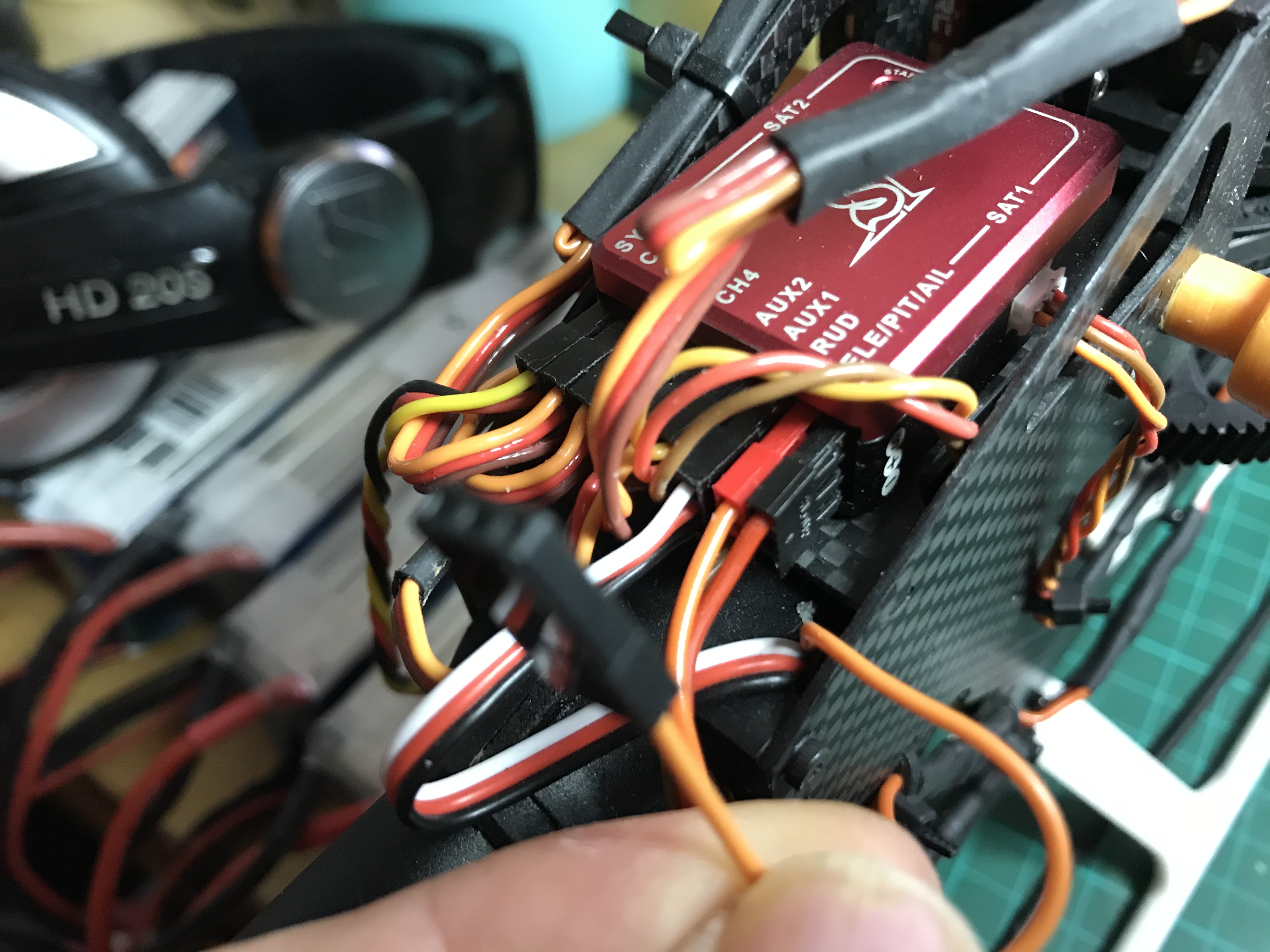

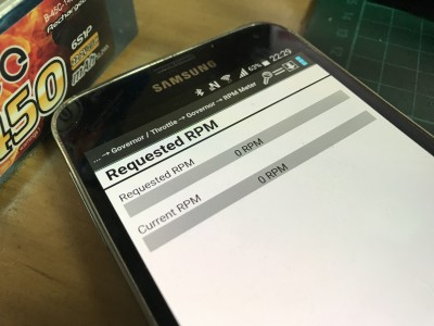

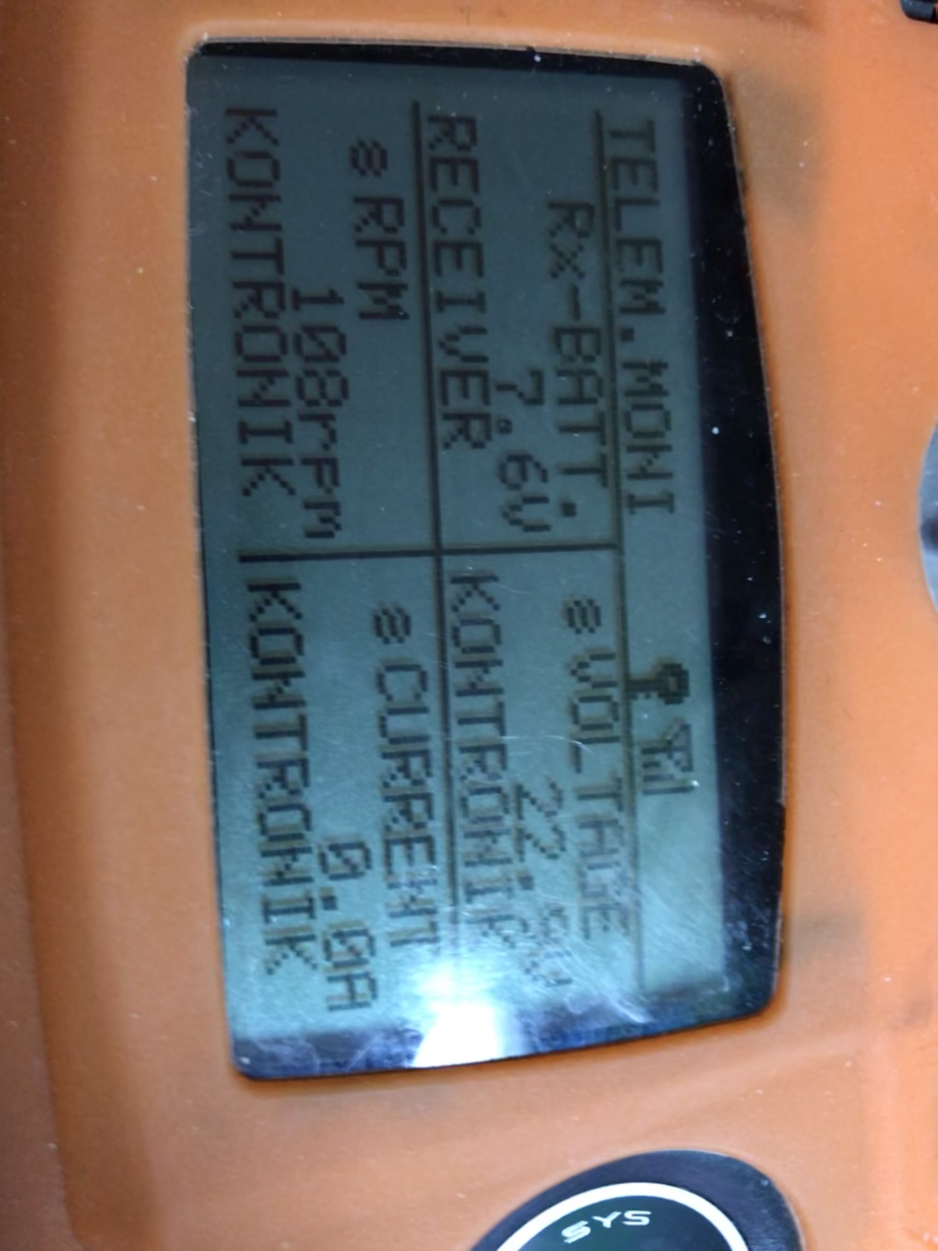

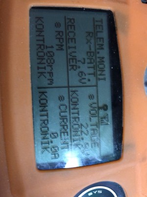

I have connected everything. Futaba see correcly a telementry and a RPM information. I have problem with FBL unit, becouse I checked via android app and rpm value is 0 (maybe for a moment I see 400-700 and it change to 0). For clear I tell you, the classic RPM sensor cable from ESC is disconnected from Spirit 2 unit.
Previously when I have connected RPM sensor cable from ESC directly to FBL unit, I have seen values.
All telementry read from spirit 2 in Futaba works fine, RPM too. Problem is only with value in governor RPM metter in governor setting, because of zero.

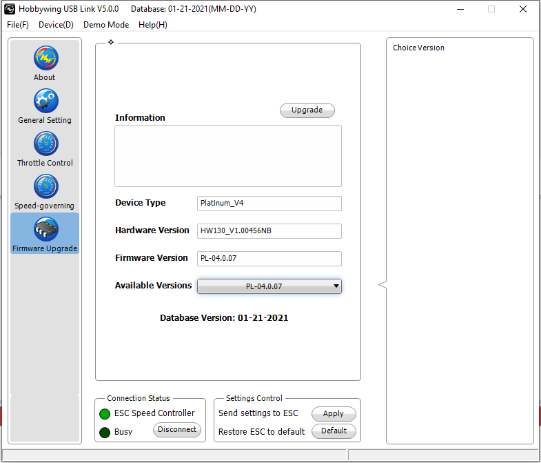

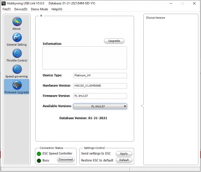

ESC is uptodate. Please take a look in attachments.
This is all correct. You can't use RPM value from telemetry for governor. Spirit app is showing data from sensor, but there is no RPM sensor connected.

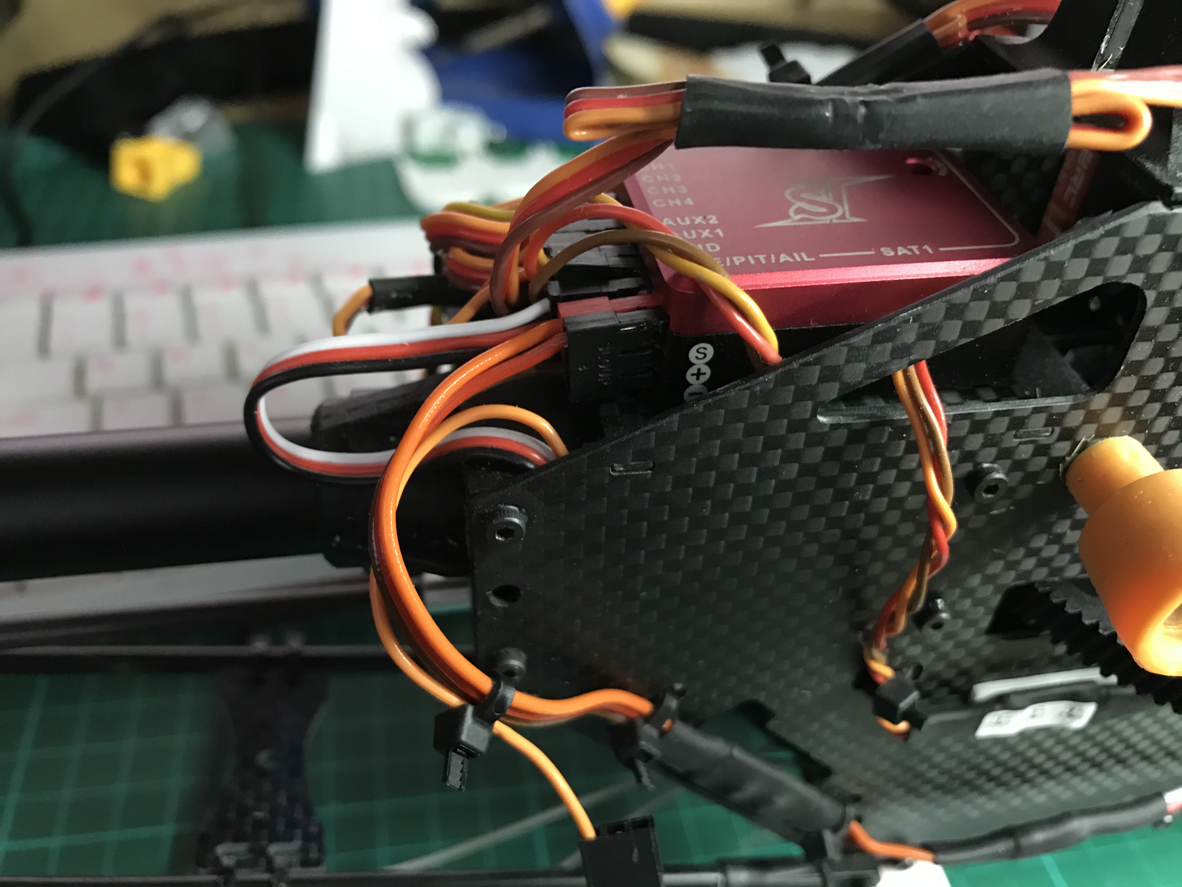

You can add wire from the ESC in the middle position. This is unused. You can use connector from the FrSky integration cable. Or change servo connector to a single pin plastic. Then you can connect and disconnect both separately.
