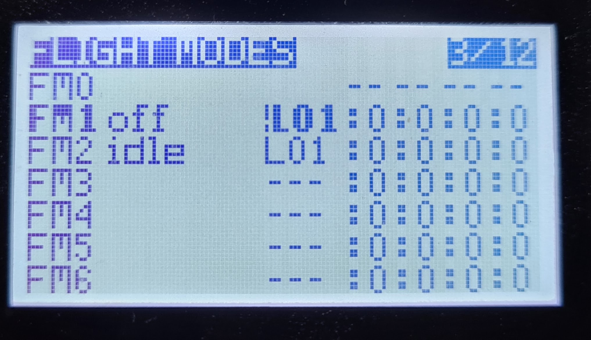

>- No need to specify "No Trim" everywhere. Disabling the trim in the FM0 (Flight Mode 0 = default one) will do the job.
i consider myself still a beginner with opentx so every tip is very welcome, ty.
when disabling trims in FM0 the other FM still shows the trim.
so i assume i must disable this in every FM that i use, or does FM0 supersede the others and it is jut a visual glitch?
"0" for others FMs must be understood as "Same as FM0".
In the FM, the trim can be either "same as FMx", "same as FMx + an offset" or "independent".
So, in your case, your are good by only disabling the FM0 (it is more clear if you are using the Companion software on your computer).
