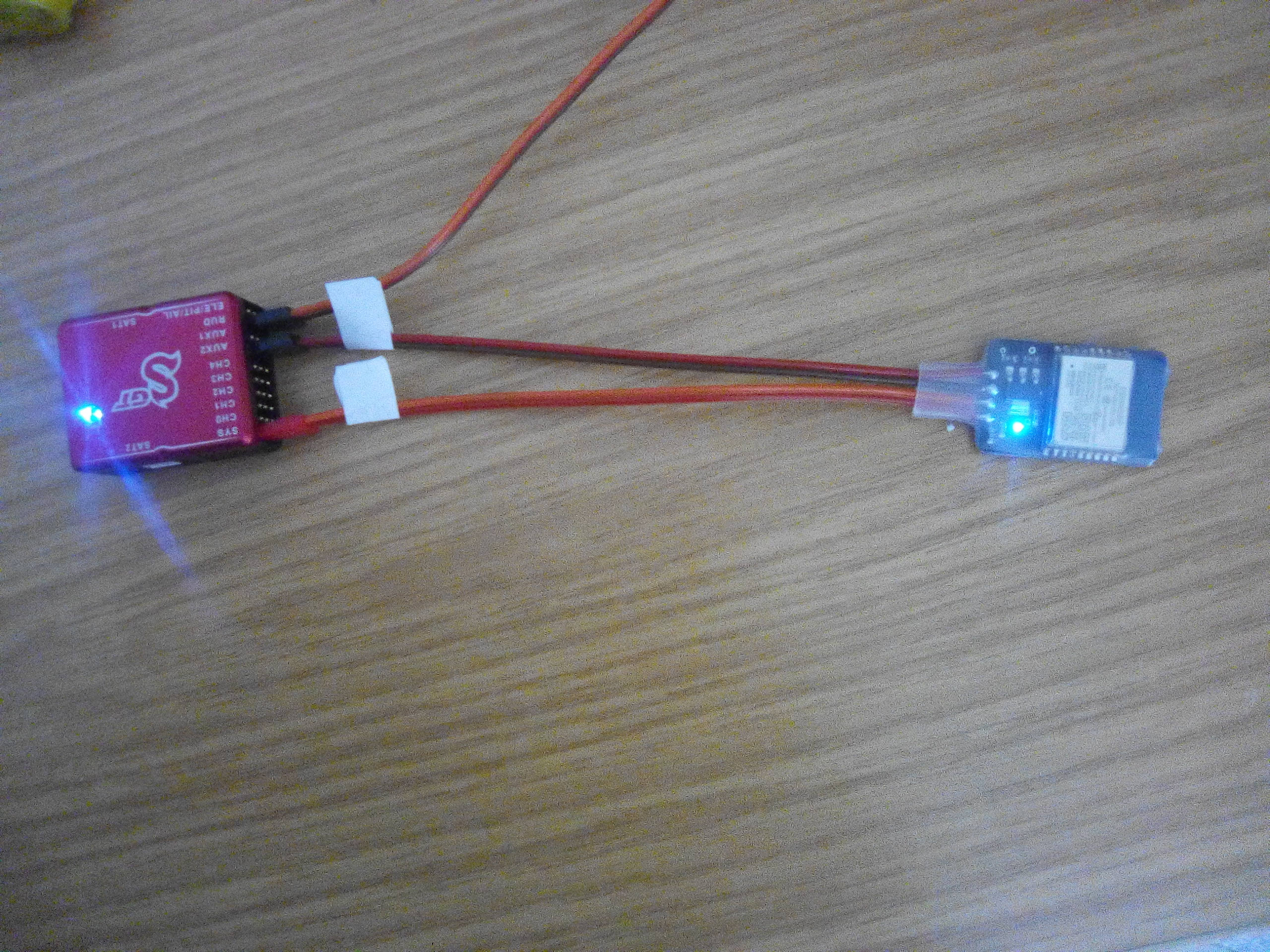

I received my new Spirit GT and the Wifi-Link module yesterday.
Unfortunately, I can't get it to work. I want to use it with my Android tablet.
I have connected the wifi link correctly (see pictures).
When I power the Spirit GT, the LED on the Wifi-Link module turns solid blue. It does not flash. Is this ok?

please powerup the unit. Then connect Wifi-Link to the unit. The Status LED should start to flash.
If you wish to connect to the module immediately after powerup, please reconfigure receiver type from PWM to other. This is default settings for a standard receiver which will be not used very likely.

Hello Thomas,
thanks for your help.
With your advice it worked. The module had started flashing.
I can now see the Spirit Wifi link in the Wi-Fi list and connect to it.
