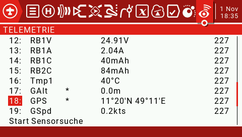

I wanted to calculate the distance between the pilot and the helicopter and looked at the table of the GPS sensor.
the variables are pilot-lat / pilot-lon and lat / lon for the helicopter
The calculation only works every other time or so.
I researched and found that sometimes lon and lat are swapped and then until the geolink is turned off

Now i have seen that the pilot coordinate are reversed sometimes
Just have a look, no problem

Here is a screenshoot, but i live in Germany :D

Do have the same problem. Latitude datas are saved under LON and Longitude datas under LAT on the Jeti Logfile. Thomas, could you correct it? Thanks
