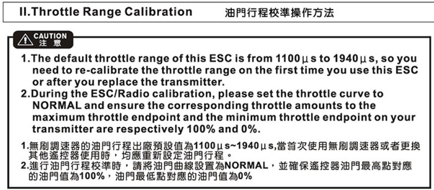

Could anyone advice the correct throttle frequency for Align RCE-BL80A ESC to be used with Spirit setting?
ESC specs sheet shows only the High and Low operating range as 1940 - 1100.
Is it acceptable to leave the default 60Hz value in the Spirit setting?
