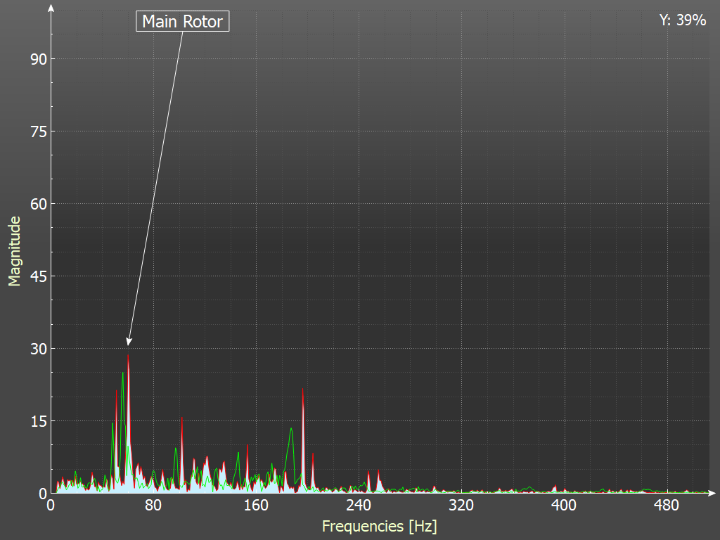

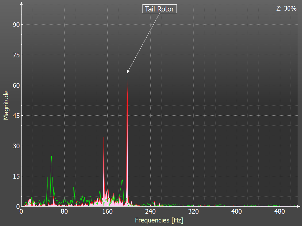

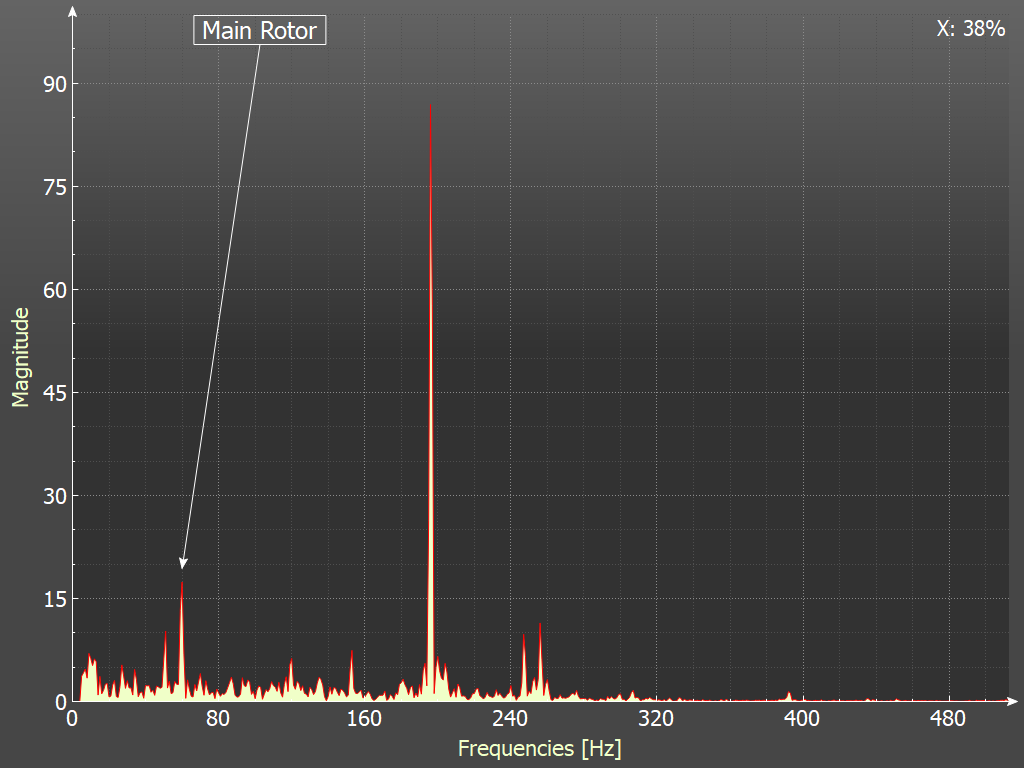

I did some Vibrations tests, without main blades but tail blades on carpet floor, hope this is the way to do this!? Here are the images, "Vibrations" in the Spectrum Analyzer are, according to the real time display, ok.

can you make vibration test without tailblades ? I think 60 are high vibrations (red) -
What is this vibration at ca. 200Hz in X-Axis ? Tomas can you help please ?

This is the tail rotor at 200Hz.
I will check the vibrations without tail blades and upload a video as soon as possible.
