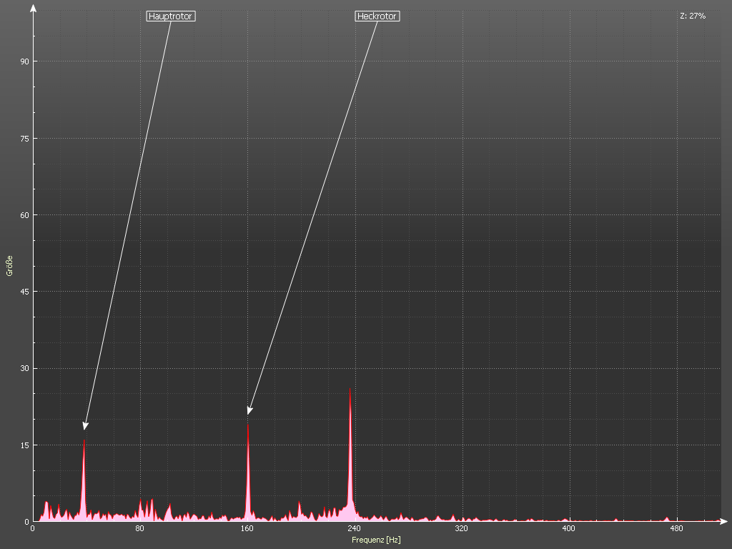

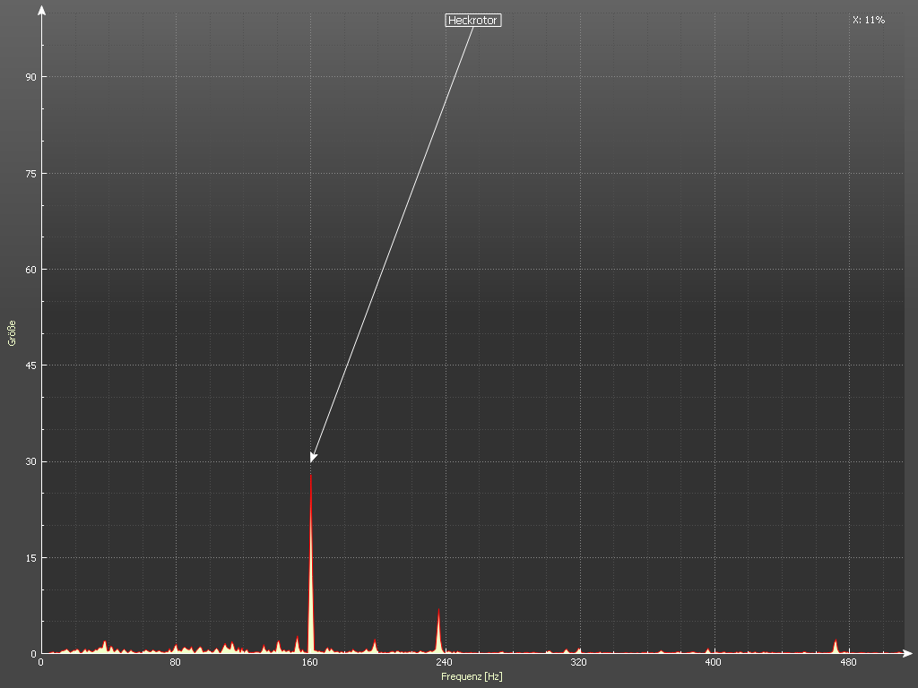

I have updated the unit to the latest FW and checked if vibrations are within permissable levels (12% currently). Hooked to the FBL is a Geolink unit.

Please measure vibration level with tail blades on and with pc software. Especially Y axis. This will be much accurate.
Also do you use ESC fan?
vibration level looks very good.
