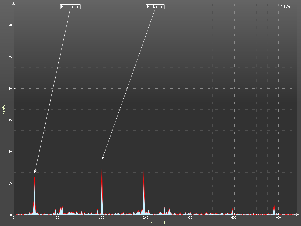

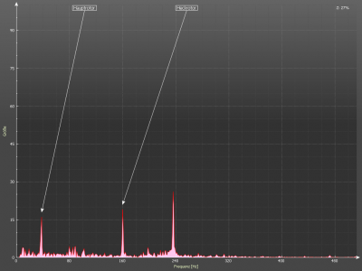

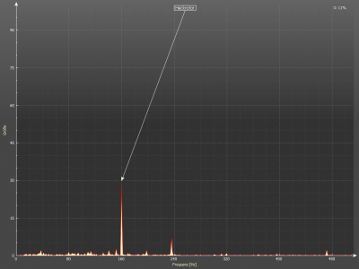

Attached the result of the bench vibration measurement.
Tail rotor blades are installed, main rotor blades removed.
Cheers Martin
Z axis
Z axis
Y axis
Y axis
X axis
X axis
Posts: 12988
vibration level looks very good.

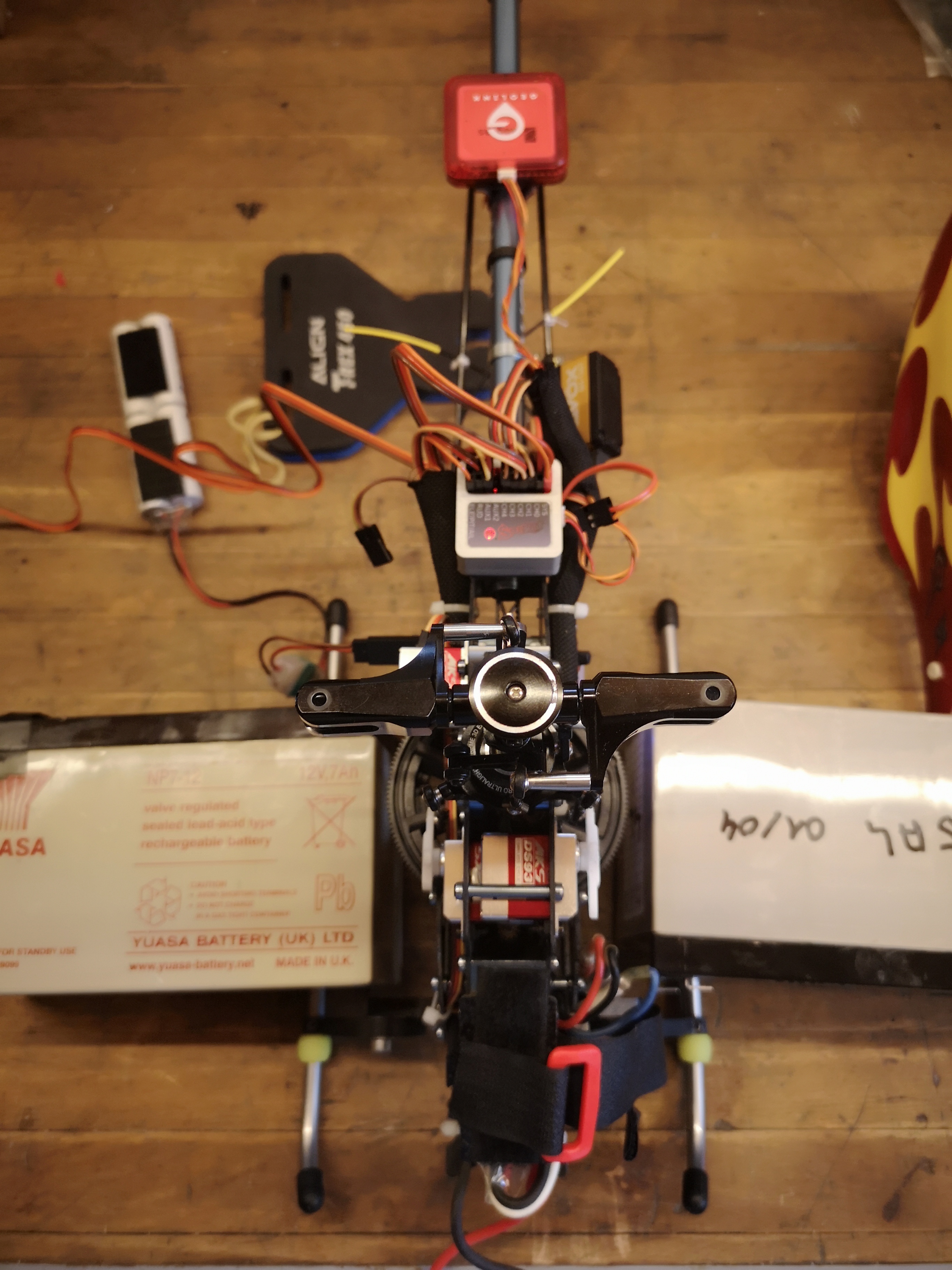

a) with the basic setup - it is possible to achieve working condition when model can fly but it is not connected properly and performacne is poor. It is usually enough to verify mounting position of the unit and swashplate type. If this is matching the model, then settings are correct. To make sure it is really OK, you can send a photo of model and unit at the model and also your settings file.

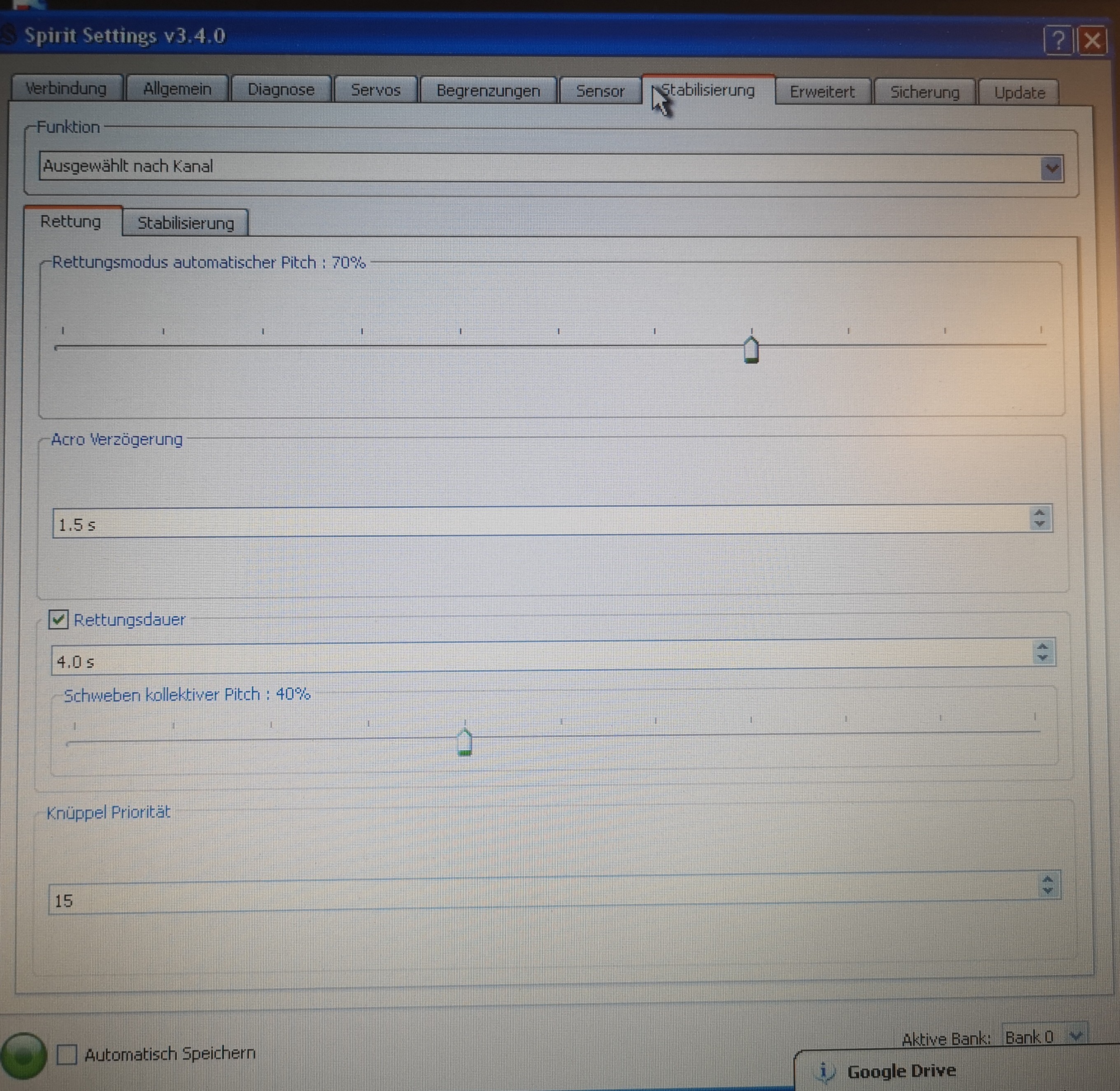

For a) and b) see attached pictures.
Regarding c) I had bought the Unit when it first came to market some 7 years ago.
Until recently the unit was performing in this exact setup without issues.
Cheers Martin

Posts: 12988
Thank you for all the details.
I recommend to turn off Stabi Correction if you have not tried it yet.
