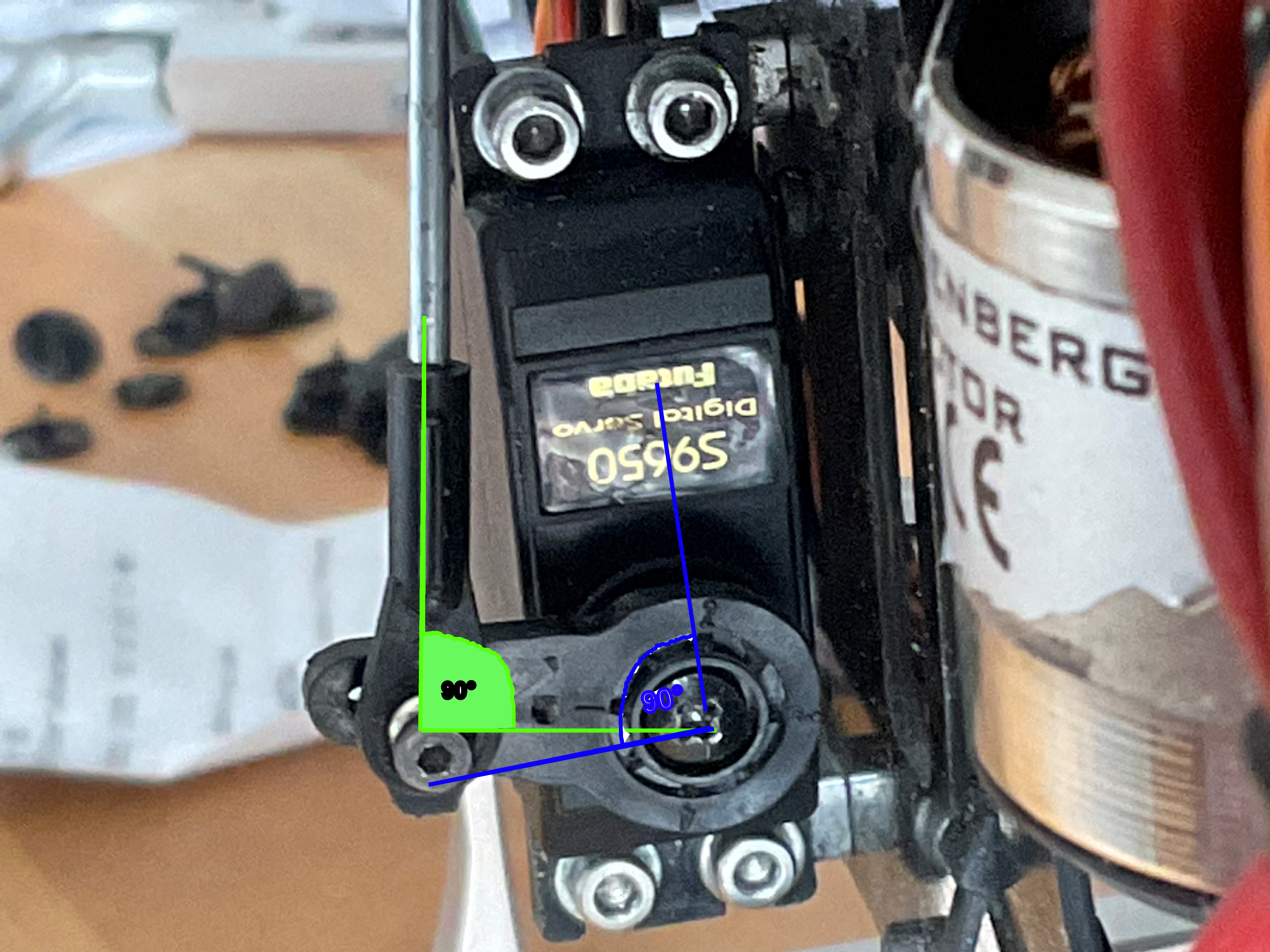

Which is correct mounting for Spirit? The blue version show the describe in Heli Manual
Dieter
jjuk
Posts: 305
Joined: Thu 05. Oct 2017 20:06:35
As per manual. Servo arm 90 degrees to servo.
Posts: 13049
Yes, blue is correct. This mean it is way too off at the photo. This can degrade flight performance and GeoLink functionality in all Altitude related functions.
Dieter
Posts: 30
Joined: Tue 24. Aug 2021 0:04:47
I have changed servo konfiguration, replaced some ball bearings and shafts. The heli flies beteer than everywhere. Now it‘s all o.k.
