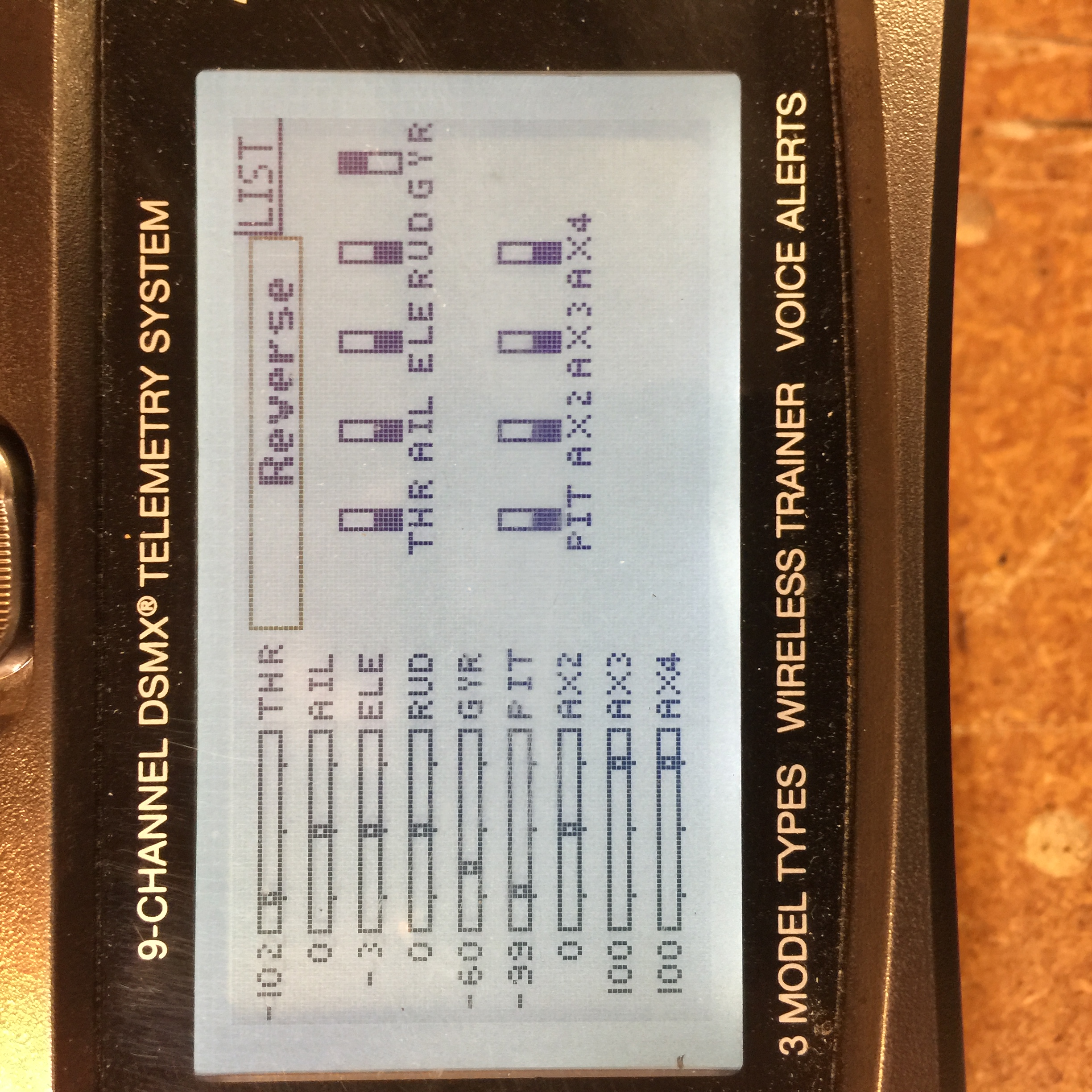

I checked my TX and see this.
I changed the Gyro channel Reverse and then bench tested and I have HOLD now on both Normal and Stability modes. This was the whole issue.
It seems a bit weird that my tail has been in HOLD mode with this setting prior to exploring the Stability by Channel mode, but since it's working in the air now, all is good.
Thanks for your comment which got me looking in the correct direction.
