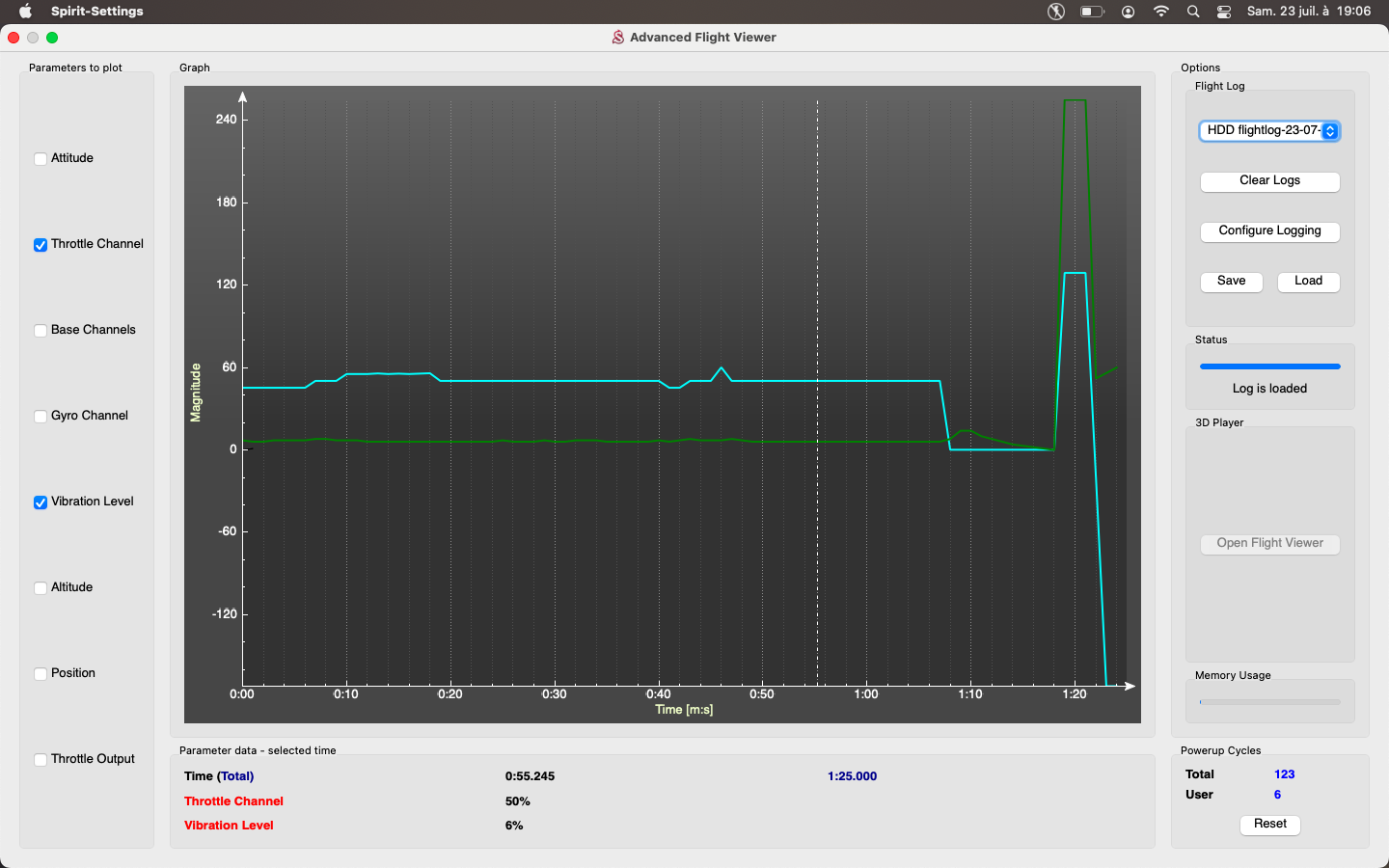

First of all, the measurements are well logged, thank you.
I'm back with something bizarre !
In the end of each flight I have a peak of all mesures and the scale is wrong. I think it is when I switch off the ESC (Jeti Spin 44).
If you have a suggestion/idea ?!... I thank you very much.
I didn't try to unplug the LiPo instead of switching off the ESC ...
With regards
Hervé
