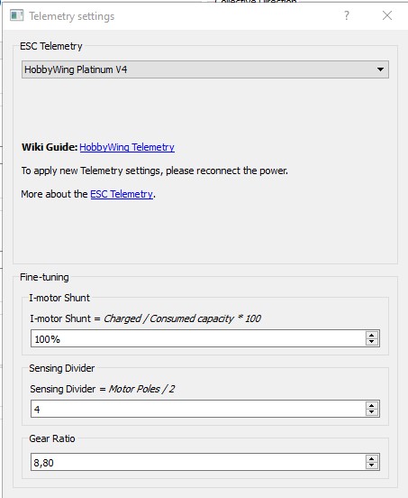

Can you please send me also your settings? I am asking to find if Gear Ratio and Sensing Divider are configured correctly.

Hi Tomas,
here the configurationfile of the SpiritGT and some other pictures and information -

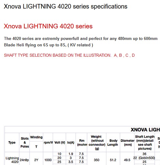

My gear ratio ist 8,83 set as 8,8 (Pinion 12 teeth, Main gear 106 teeth) - The Motor is an XNOVA Lightning 1000 rpm/V, 8 poles - Sensing divider as 4 (8/2)
Battery is an 6S 5000mAh - The motor: In my opinion Sensingdivider and gear ratio configured right -
I hope this will help -
Matthias
