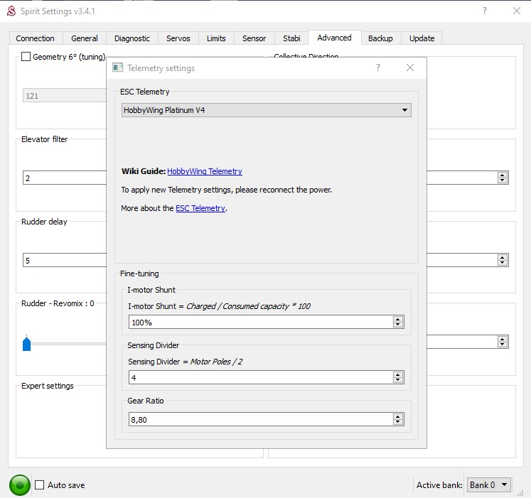

My configuration of the Hobbywing V4 120A can you see in the attached picture -
I have also attached the log file of this flight - if the vibration values were correct, my heli would not fly so well - furthermore the ESC temperature is not correct at all, at the end of the flight 4°C, with an outside temperature of more than 25 °C - The consumed capacity is ca. 42500 mAH, I have a 5000mAh battery - I don't think it can be due to my configuration, see picture attached, but I'm still happy to be instructed if I configured something wrong -
