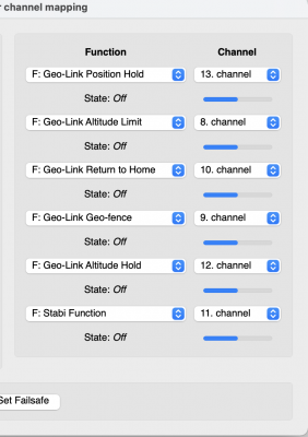

maybe you have one or more geolink function enabled on your radio
pls be sure all geolink aid are turned off when the heli is on the ground
btw, pls note that you can group some geolink functions on single channel
for example you could assign:
altitude limit + with geo-fence
altitude hold + position hold
so you will have to manage less switches :)
EDIT:
... Thomas replied you first ;)

Thank you both so much! Yes Altitude limit was showing as enabled sometimes, the signal was just on the very edge of enabled / not enabled. I have now offset it well into into the off signal area and problem solved.
