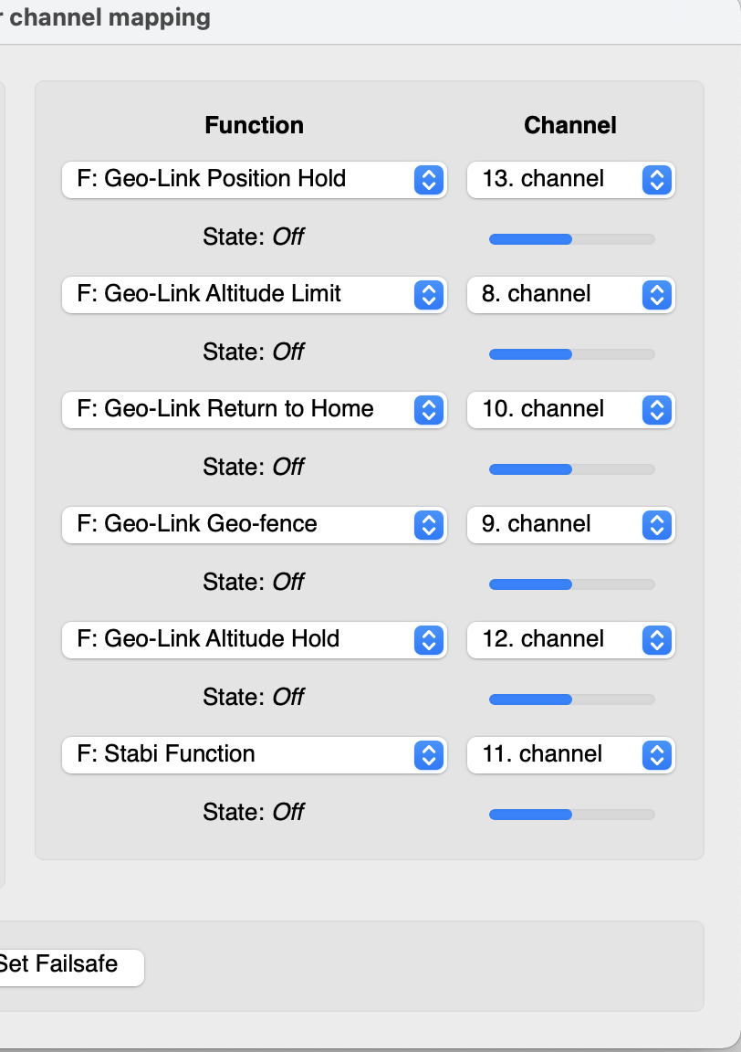

it seems you have completely all GeoLink functions configured and possibly also enabled.
The reason you are seeing strange collective behavior is because you have Altitude Hold function enabled.
This is controlling collective pitch.
Please make extra care to not engage functions from your radio that you do not want to use.
Or disable them if you are not certain.

maybe you have one or more geolink function enabled on your radio
pls be sure all geolink aid are turned off when the heli is on the ground
btw, pls note that you can group some geolink functions on single channel
for example you could assign:
altitude limit + with geo-fence
altitude hold + position hold
so you will have to manage less switches

Thank you both so much! Yes Altitude limit was showing as enabled sometimes, the signal was just on the very edge of enabled / not enabled. I have now offset it well into into the off signal area and problem solved.
