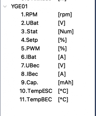

of course this is an option - i am i.e. using all of mine like this (YGEs with GTR and RS). what you get is more telemetry items from YGE (it's stock YGE EX Bus telemetry protocol directly connected to Jeti EX Bus, see pic) and the big advantage for me is: using the Jetibox emulation on Jeti TX you can program the YGE Esc directly... not 100% of all items but the most important ones to be changed on the field for sure.
Ciao
Michael

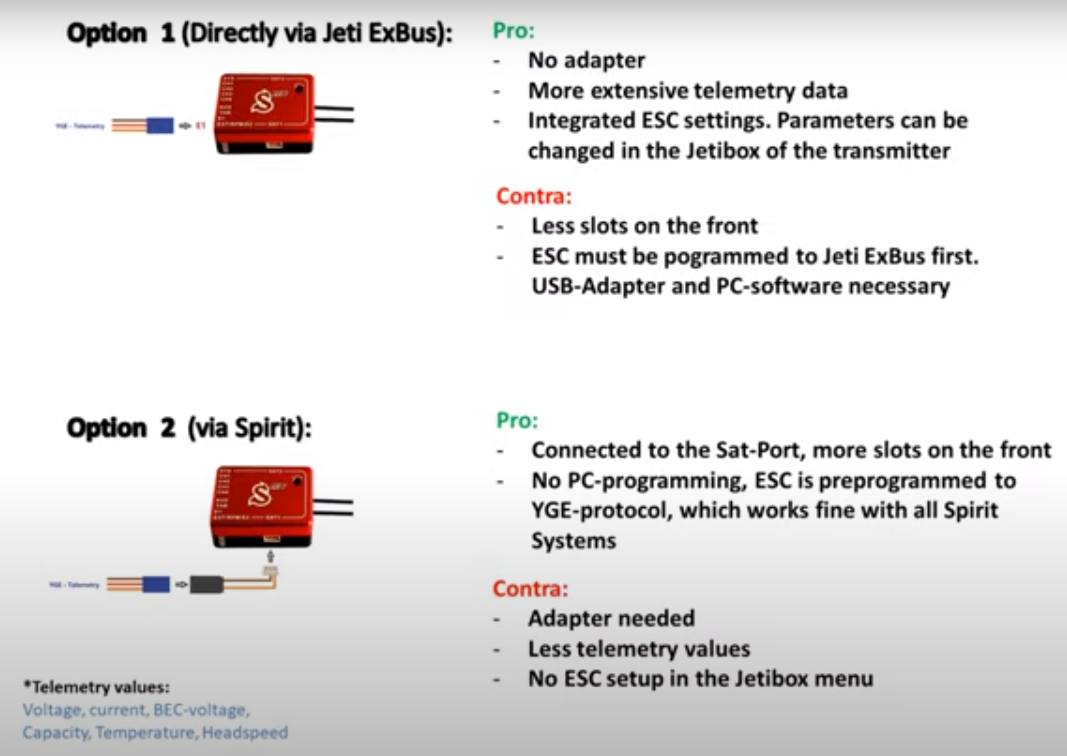

Posts: 1053
comparison in the picture...

Habásek wrote:comparison in the picture...
Correct. The video uses an older Spirit RS unit. I was not sure if the video also applied to the newer Spirit GTR units, especially since the Spirit GTR manual makes no mention of this.
Posts: 1053
Yes, it's the same see manual .. it's the same for both RS and GTR.
