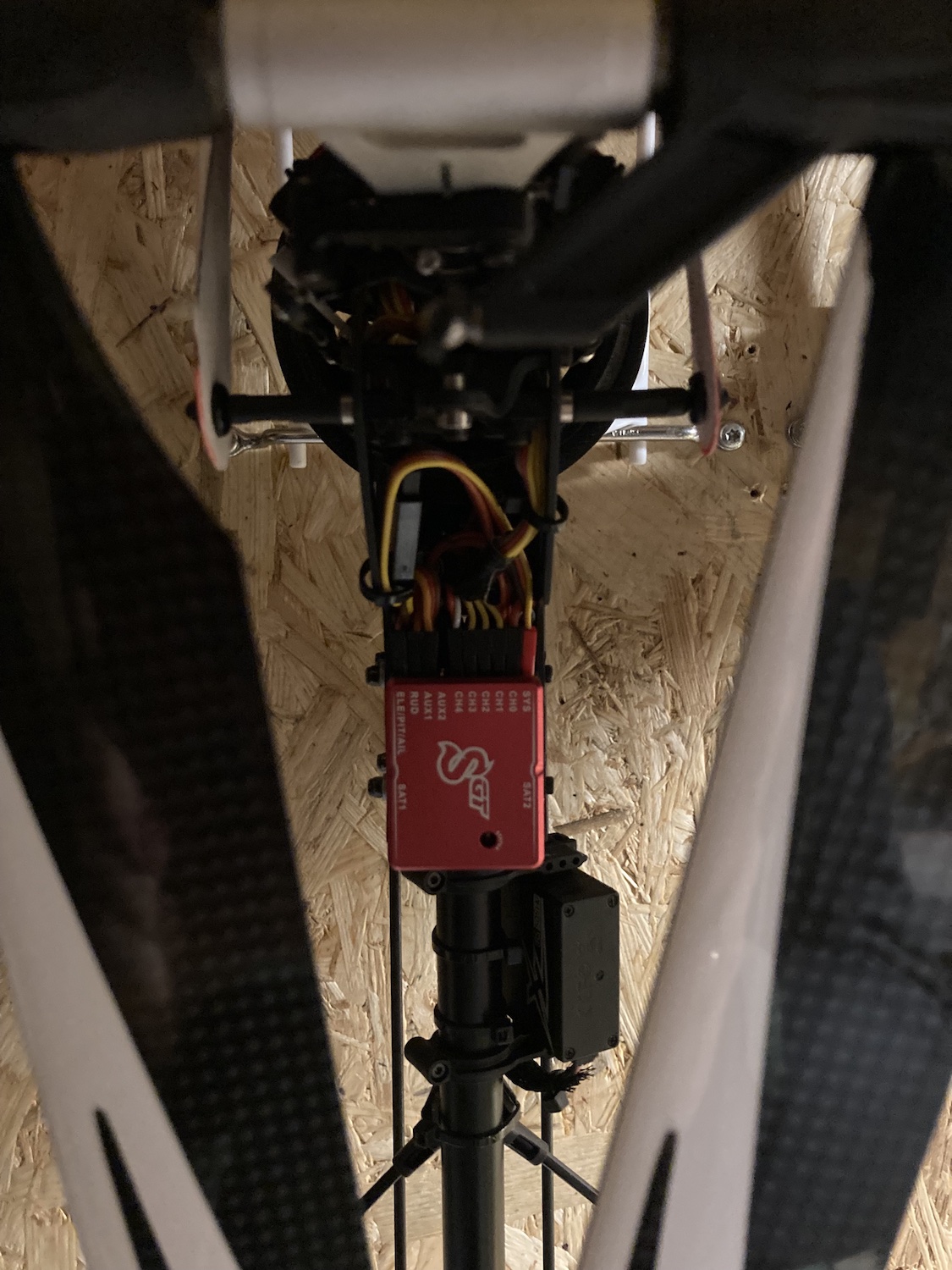

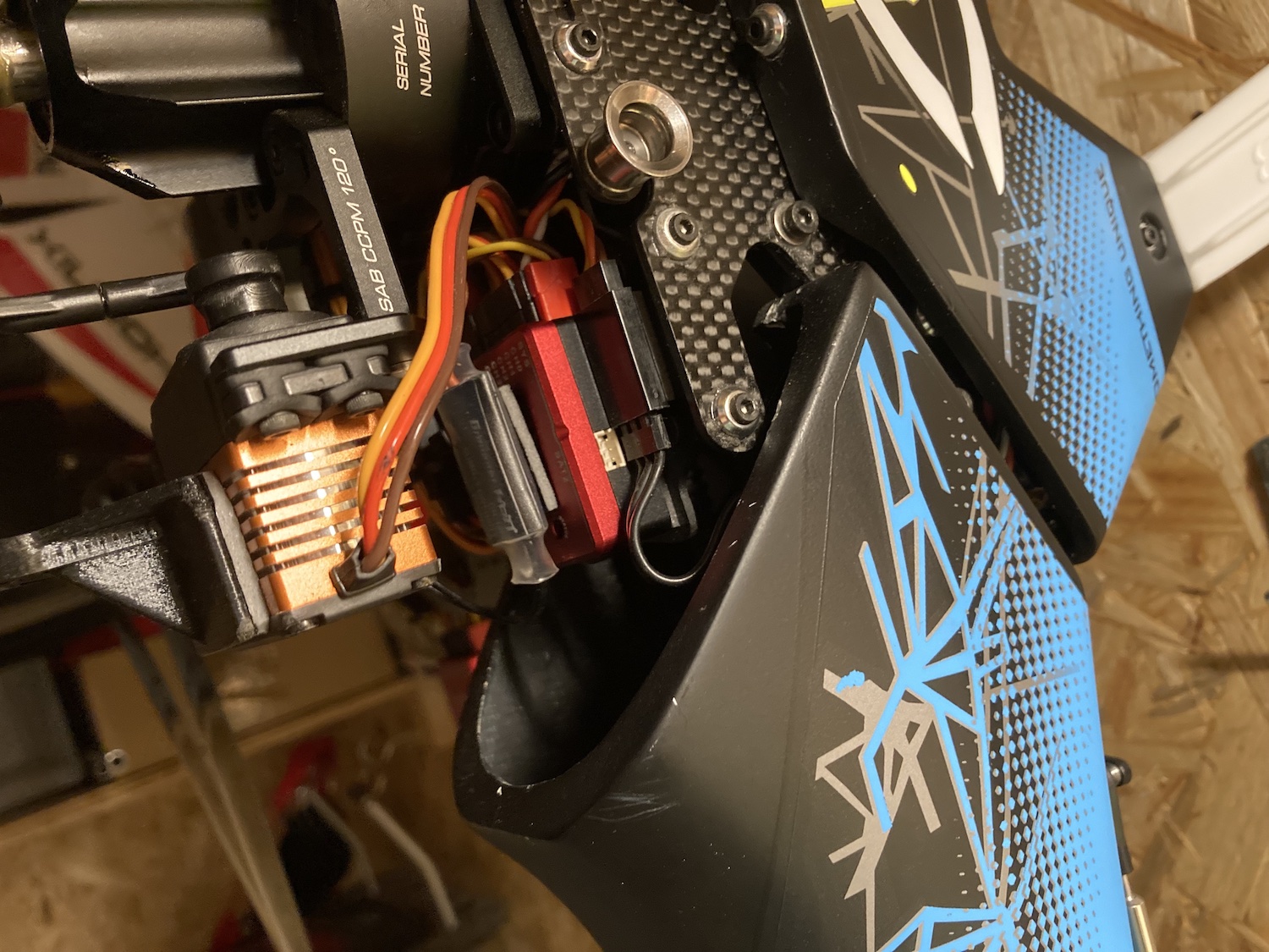

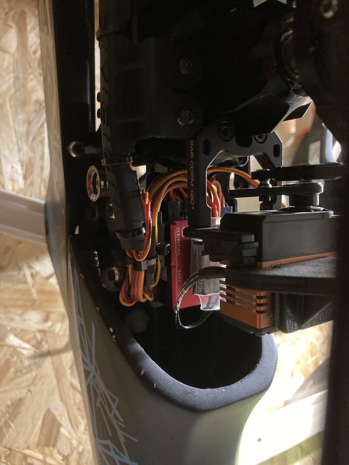

I use a Spirit GT in both Helicopters. The drift is not while hovering stationary its when I fly slowly forward or backwards. The stronger drift is while flying slowly backwards. I don't use the Stabilisation mode at all, don't like the feeling.
The shown vibration scann is fron my Kraken 580 with tail blades. The vibration level is so low that I have several logs from one flight. I'm always happy if I find a log of 2-5min during a 12min flight. Most logs are only a few seconds. My second Helicopter is an Protos 380 light V2 and the vibration level is a bit higher than the Kraken. I get proper logs from every flight.
In both cases the Spirit unit is mounted with the plugs showing to the front. I used the original tape. I was very precise while setting the swashplate.
What is the best way to position the Tail? I always position it exactly in the middle. So I get the same travel distance to both sides.
Sorry for the poor pics.
