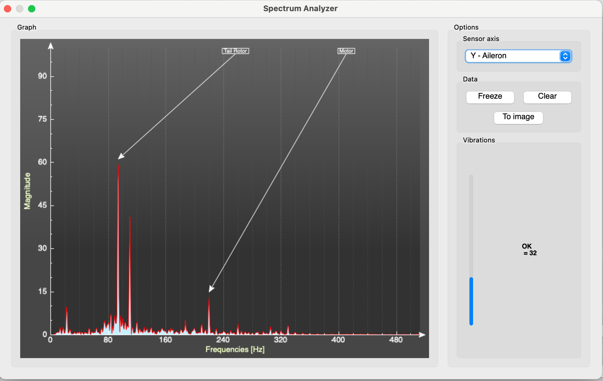

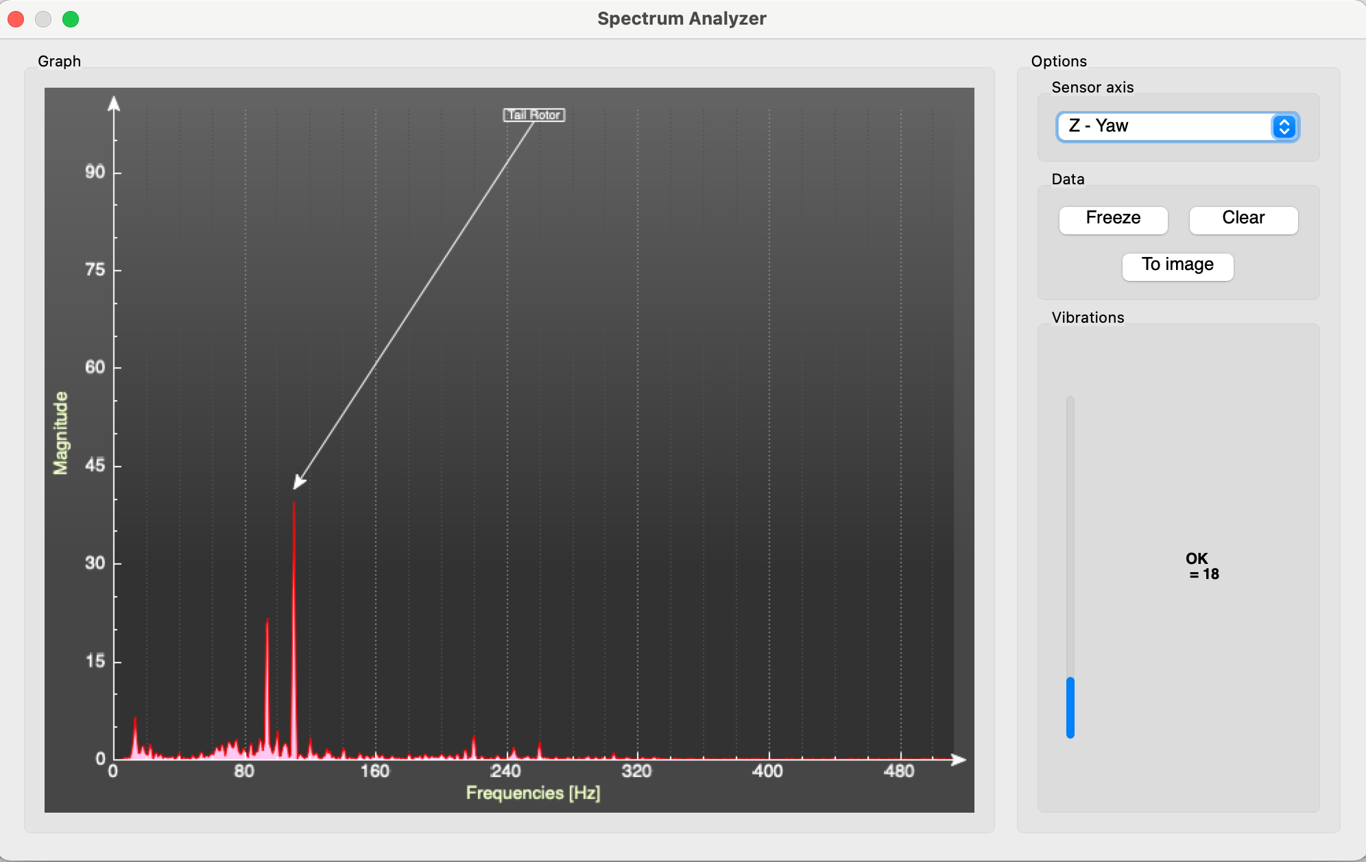

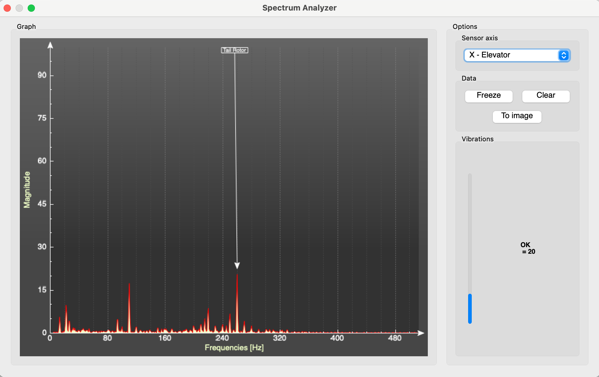

Vibration level for Y is okay. (Heli on the bench without main blades but with tail blades)
Bank 0 : (Hovering 1450rpm) max. 30
Bank 1 : (Flying 1800rpm) max. 60
Bank 2 : (Landing 1350rpm) max. 25
When I lift the Heli the vibration level drops by 5-10.
But I noticed when I use Bank 1 and increase the rpm just by 10% the vibration level skyrockets up to 125.
Still I have the drift in all three banks.

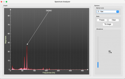

Here the Vibration level pics. ( Heli on the bench)

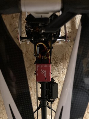

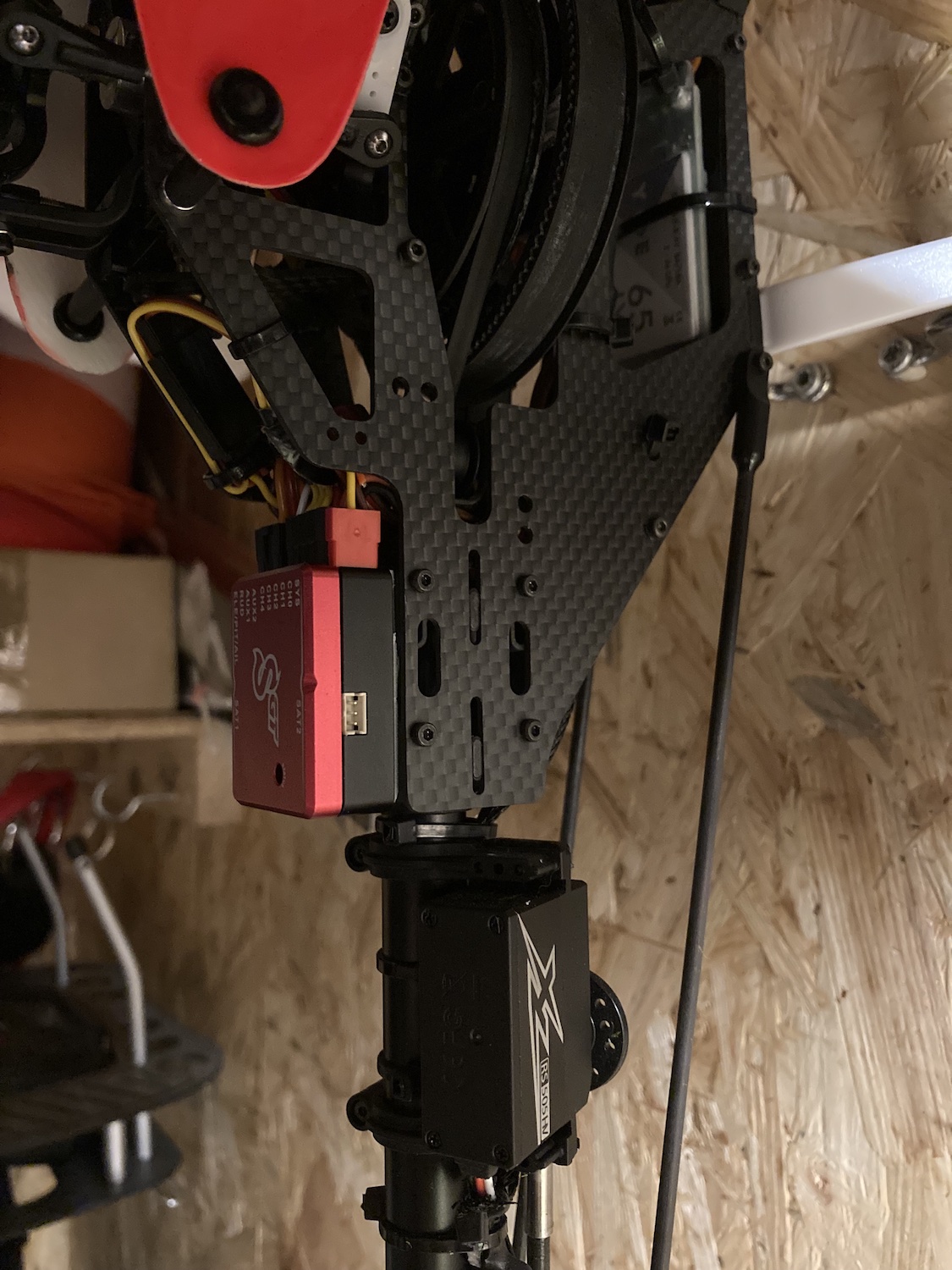

The drifting could be also result of a wrong configuration of parameters such as Mounting Position, Swashplate Type or Reversing or combination of these. Model can fly seemingly well, but stabilisation will work very poorly.
Could you take a photo of mounted unit on the model? Then I can verify also these parameters.
Vibration plots looks great, but have you tested it with tail blades?
If not, difference could be even 100x worse. Usually it is 2-4x worse.

The shown vibration scann is fron my Kraken 580 with tail blades. The vibration level is so low that I have several logs from one flight. I'm always happy if I find a log of 2-5min during a 12min flight. Most logs are only a few seconds. My second Helicopter is an Protos 380 light V2 and the vibration level is a bit higher than the Kraken. I get proper logs from every flight.
In both cases the Spirit unit is mounted with the plugs showing to the front. I used the original tape. I was very precise while setting the swashplate.
What is the best way to position the Tail? I always position it exactly in the middle. So I get the same travel distance to both sides.
Sorry for the poor pics.
