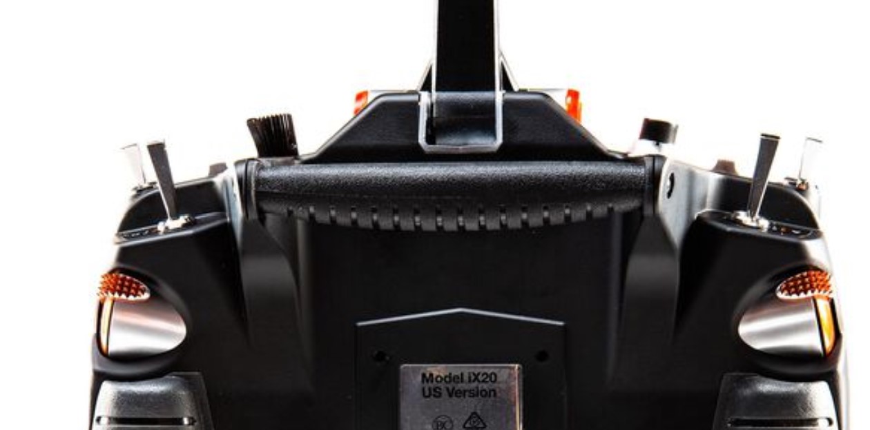

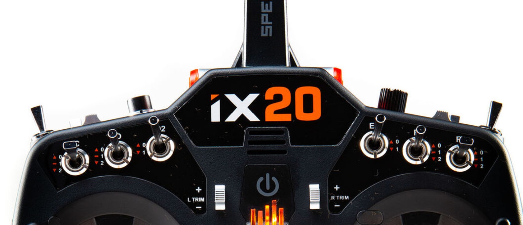

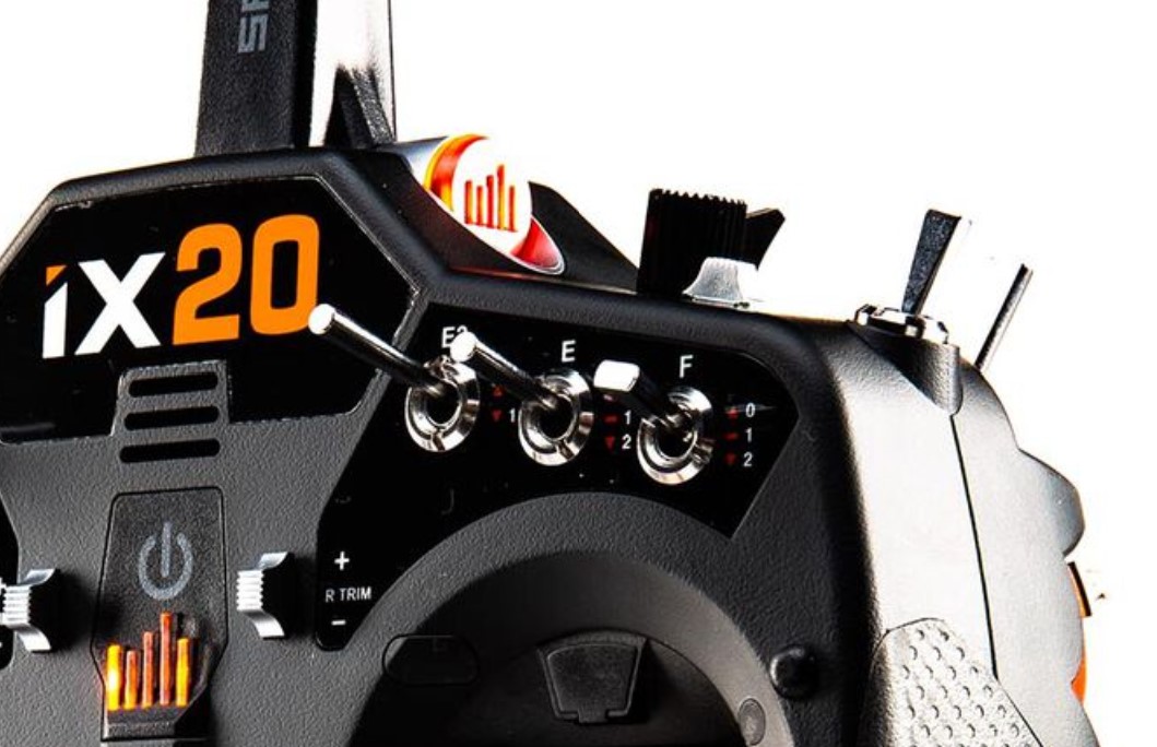

Here are a few more pictures of the IX20:
Please don't get me wrong, I don't want to advertise the IX20 here -

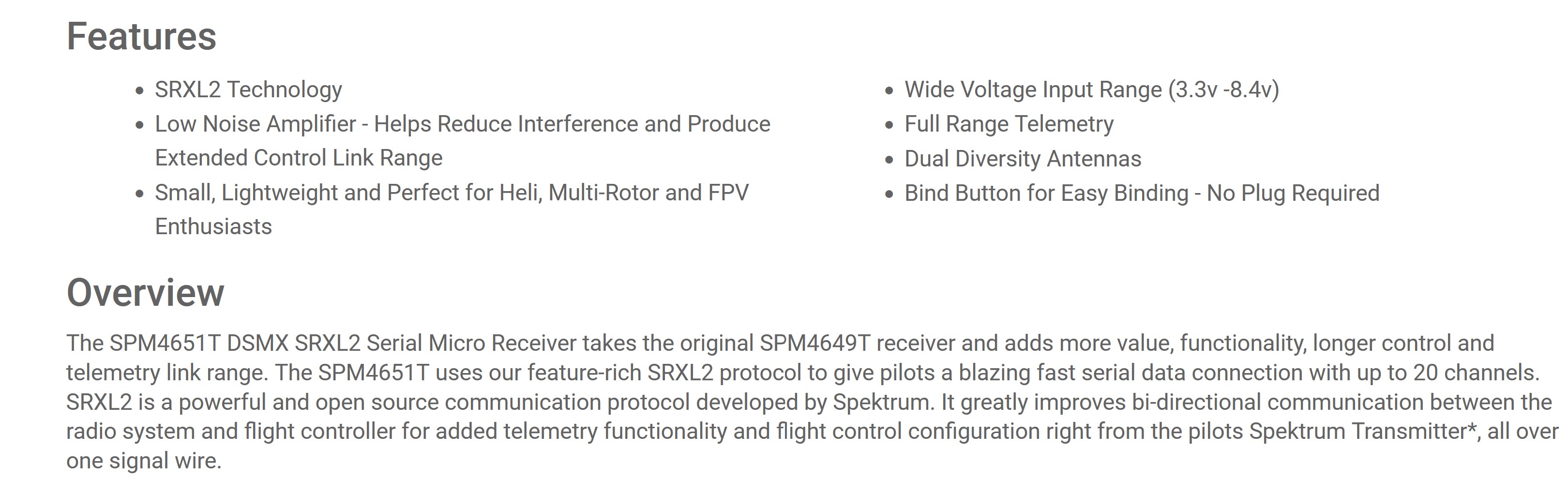

To anticipate, this is not about a discussion about which control is the "best" but only about what the spektrum protocol DSMX (22ms) can do, regardless of whether it is about any external third-party modules with DSMX technology or whether it is about the original - there are currently 12 channels - with a different protocol (SRXL2 system) there are 20 channels, as with ACCESS 24 channels and with ACCST only 16 channels -
see attached picture of 4651T SRXL2 receiver for info -
