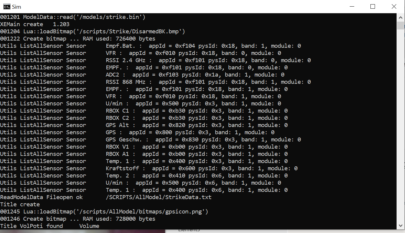

I have made a list of all sensors:
Perhaps the Problem is the second U/min sensor with appId 500 and pysId 0x6.
This one and the Temp. 2 and Temp. 1 are coming from the Frsky RPM sensor ( the last three items)
The first U/min sensor has also appId 500 but pysId 0x03 ( SPIRIT GT)
I do not know how to change the appId address
Jörg
