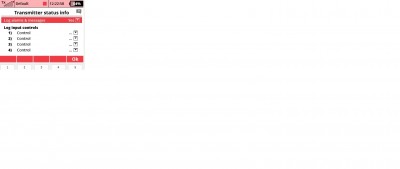

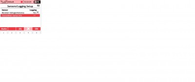

I can't tell you what happened. Just a recommendation. In Jeti you can set up logging of up to four control. I recommend.
