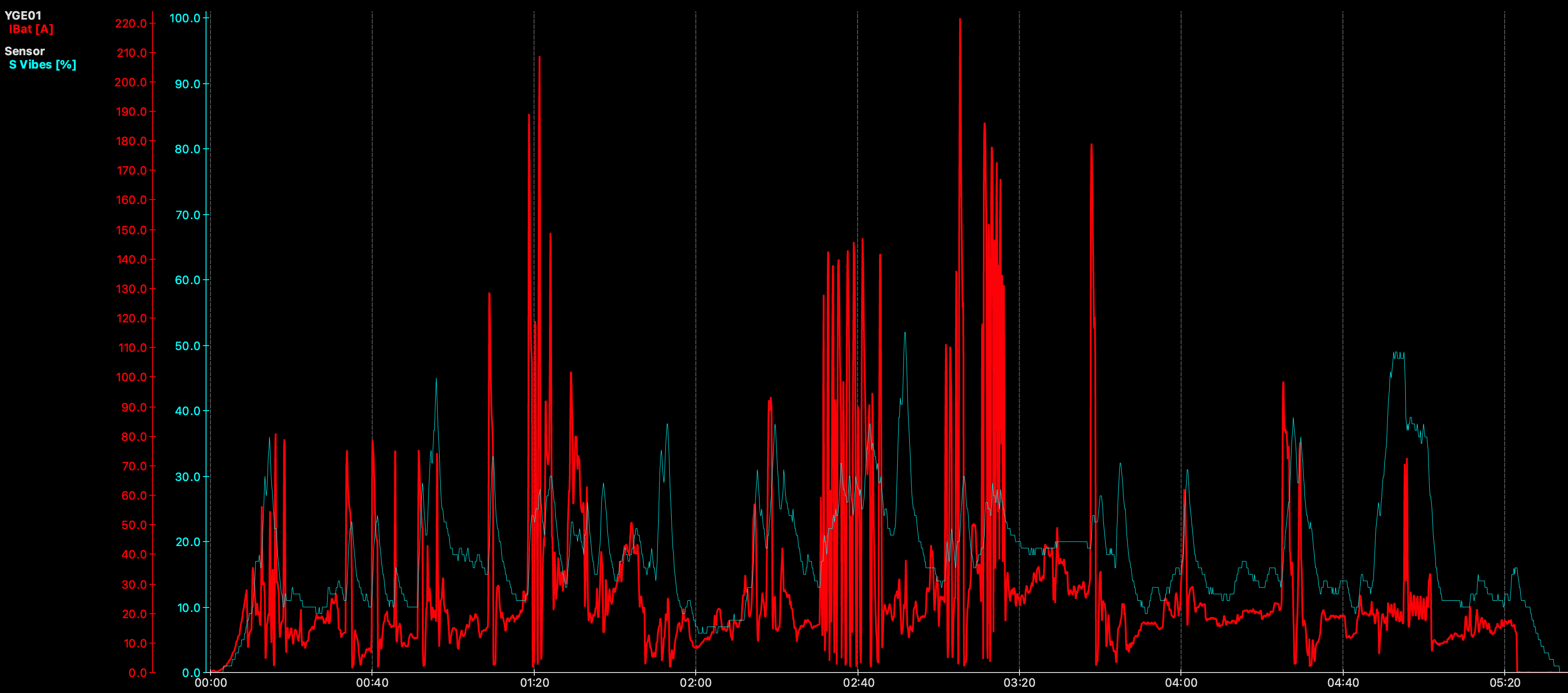

do you have a log of the vibrations level during a 3d flight? your vibration level is still rather high - it will be even much higher in 3d flight and most probably still exceed the level of 100. see attached a log of my "worst" heli regarding vibrations in a 3d flight. the vibrations are more like 7-18 on bench depending on headspeed, spikes up to maybe 50/60 in flight. so if this is similar in your case the vibrations in 3d flight could still exceed the limits...
nb: auto rescue is working good on all of mine even with 3d flight - but it's only GT/GTR and no GeoLink in my case and i only activate it for short periods less then 1 minute when testing new or risky moves.

I have spirit rs and geolink v2 i can record logs only through the radio, use jeti studio to open this log
17-40-07.log
(254.83 KiB) Downloaded 145 times
I used them at 2600rpm and vibration is 70%
if i use 2500rpm vibration is 40%
