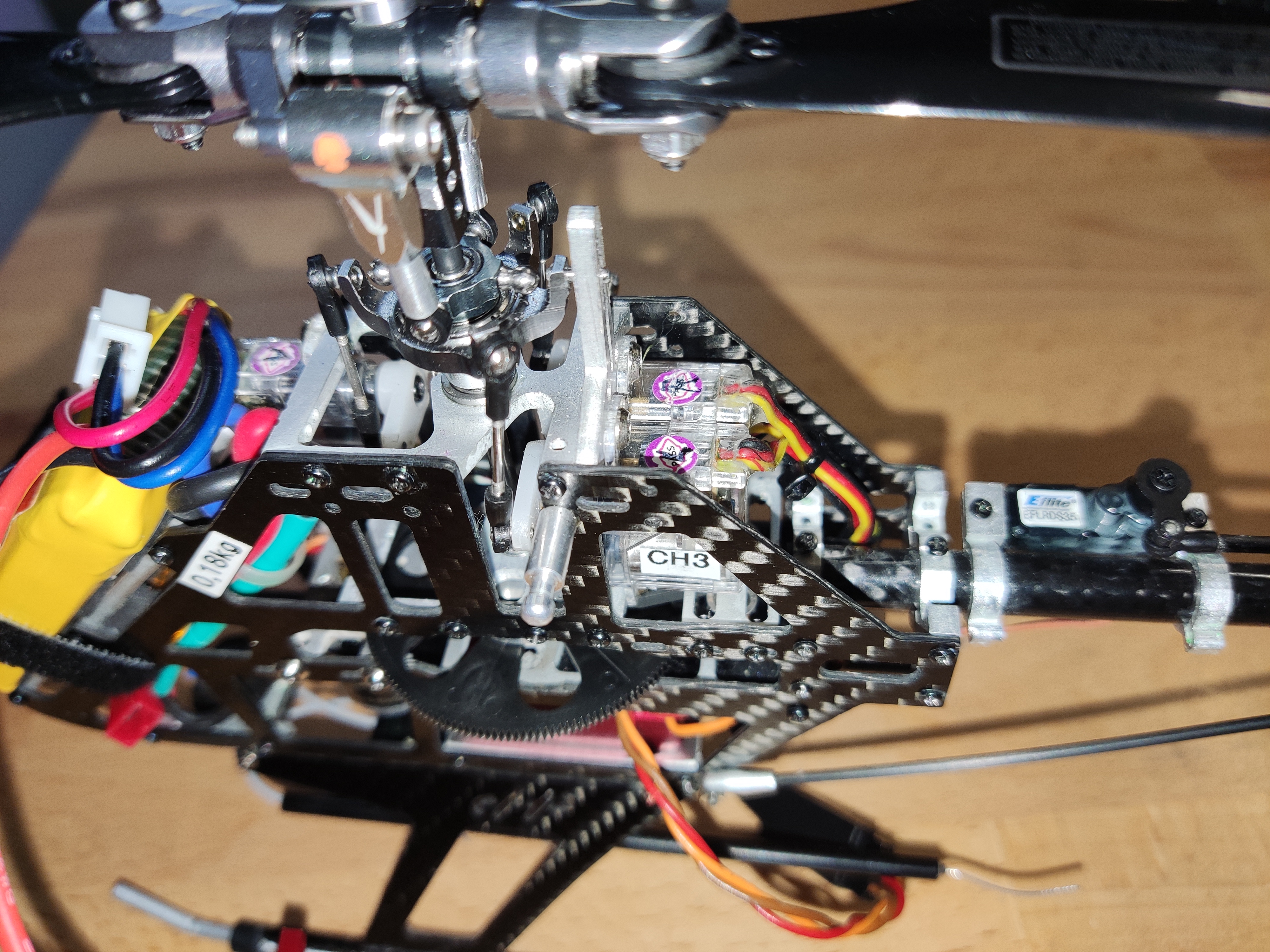

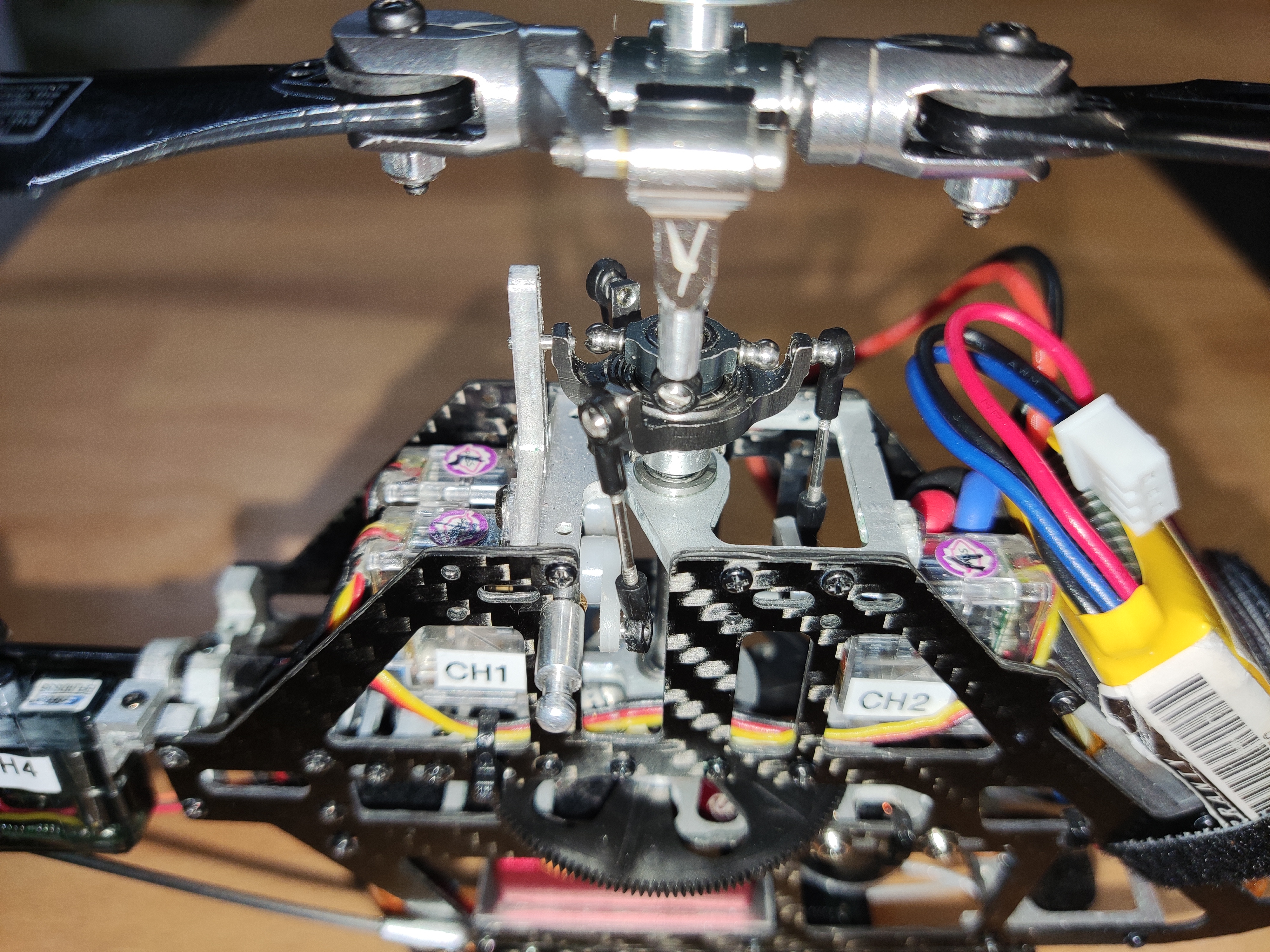

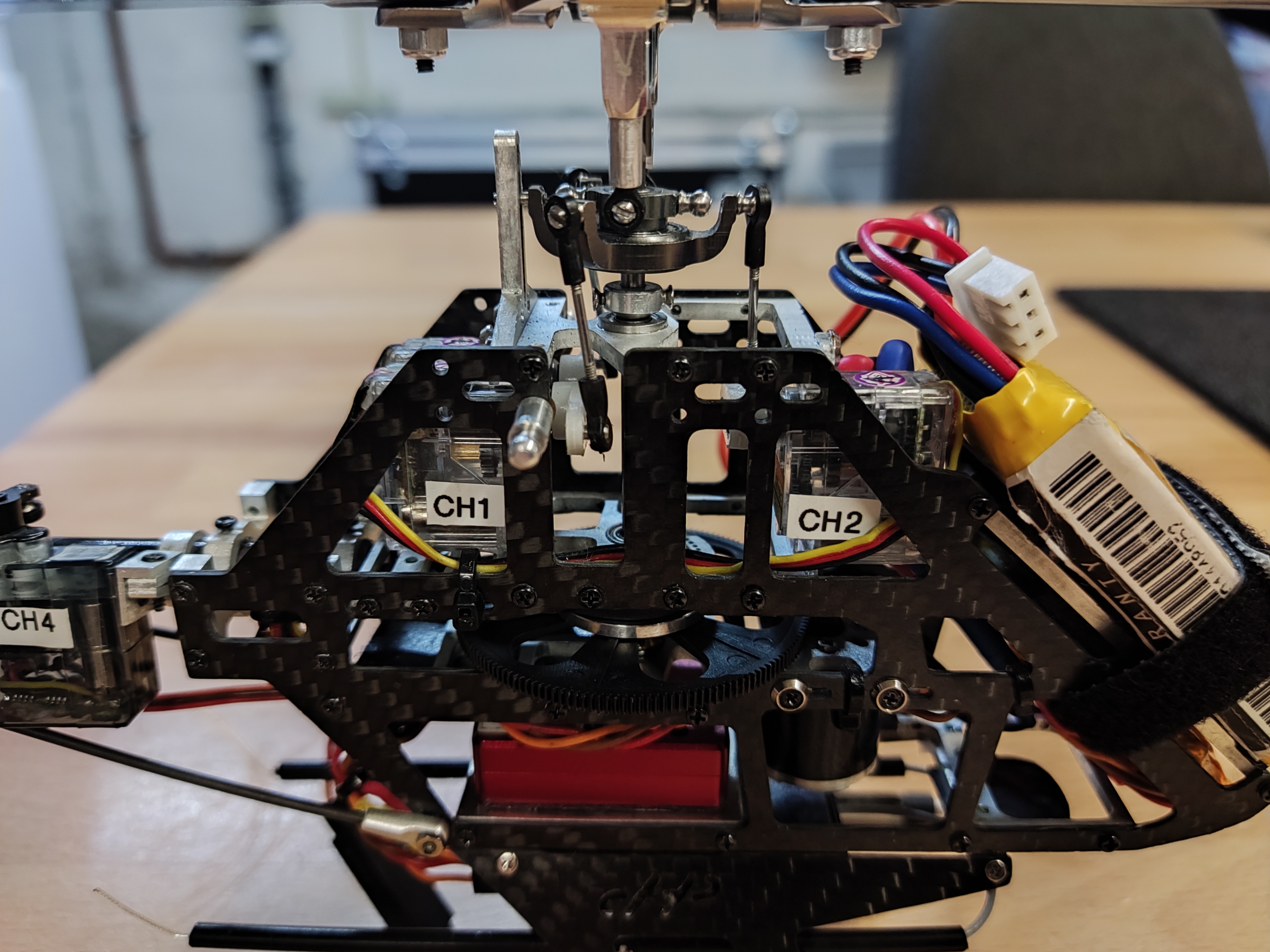

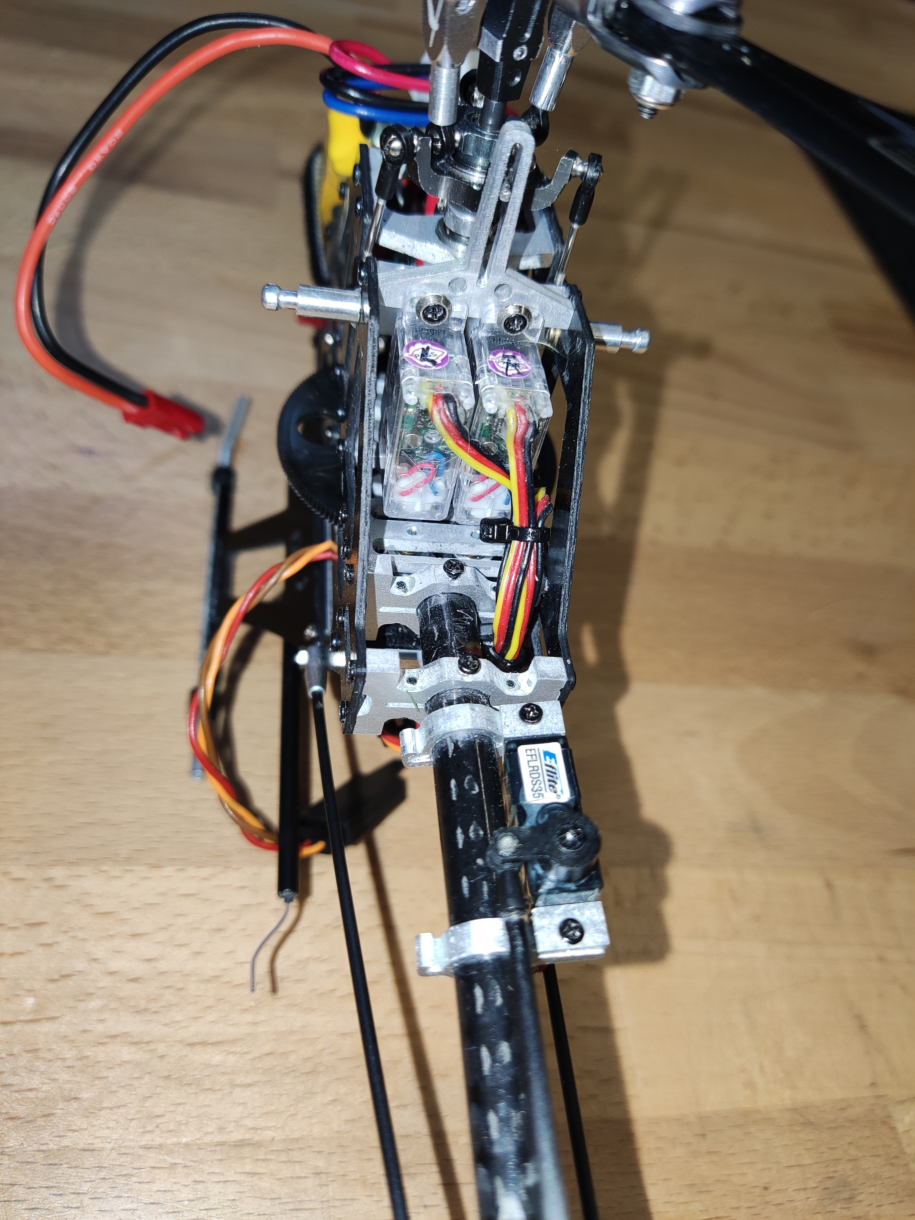

Posts: 1068
I don't see anything wrong with the setting, maybe the direction of the collective is reversed, why?
Please send me a photo of the helicopter, just a few, as well as details

all stearing on the bench, as well as reaction to tilting and turning lead to a correct reaction of the heli - and of course the stick movements are matching the displayed system's outputs.

Posts: 13045
There can be multiple reasons for this behavior, unfortunately it is hard to guess.
For example it could be motor or ESC interference with tail servo or Spirit unit.
Unfortunately components that are used on these small helicopters are usually of low quality. So anything can be reason for this behavior.
I recommend to observe tail servo and check if it has relation with headspeed.
If tail will start to oscillate always even with very low RPM then it is not caused by vibrations for sure but some kind of interference.
It could be also some mechanical issue at tail. I dont know if there were some changes or crash when it was working with other system.
