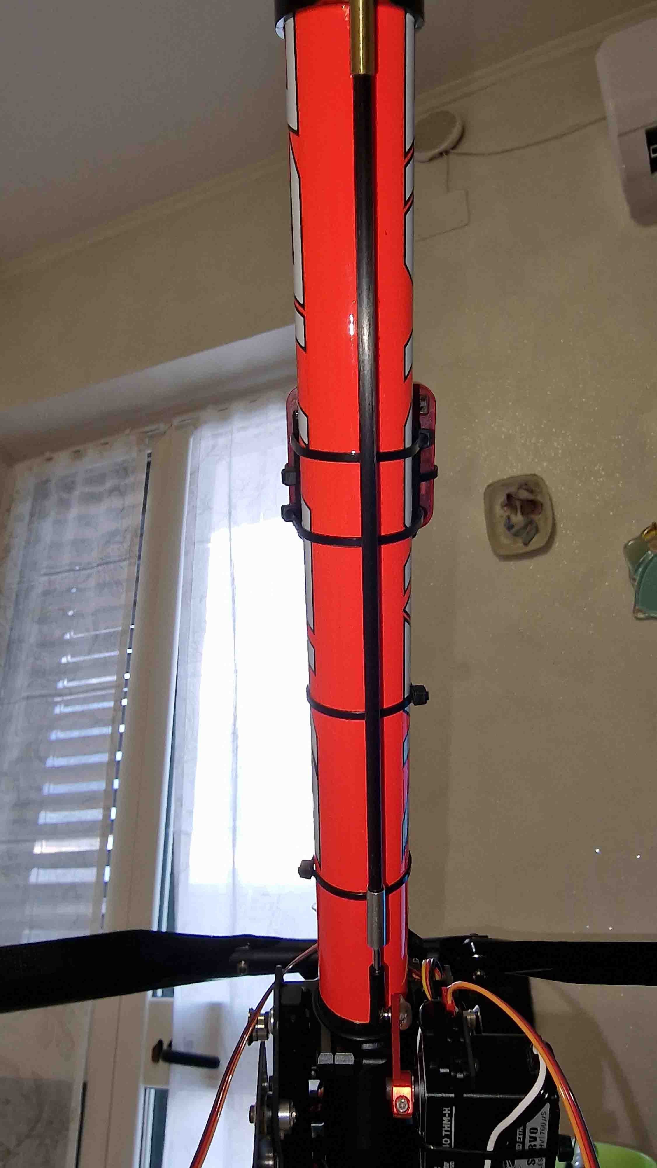

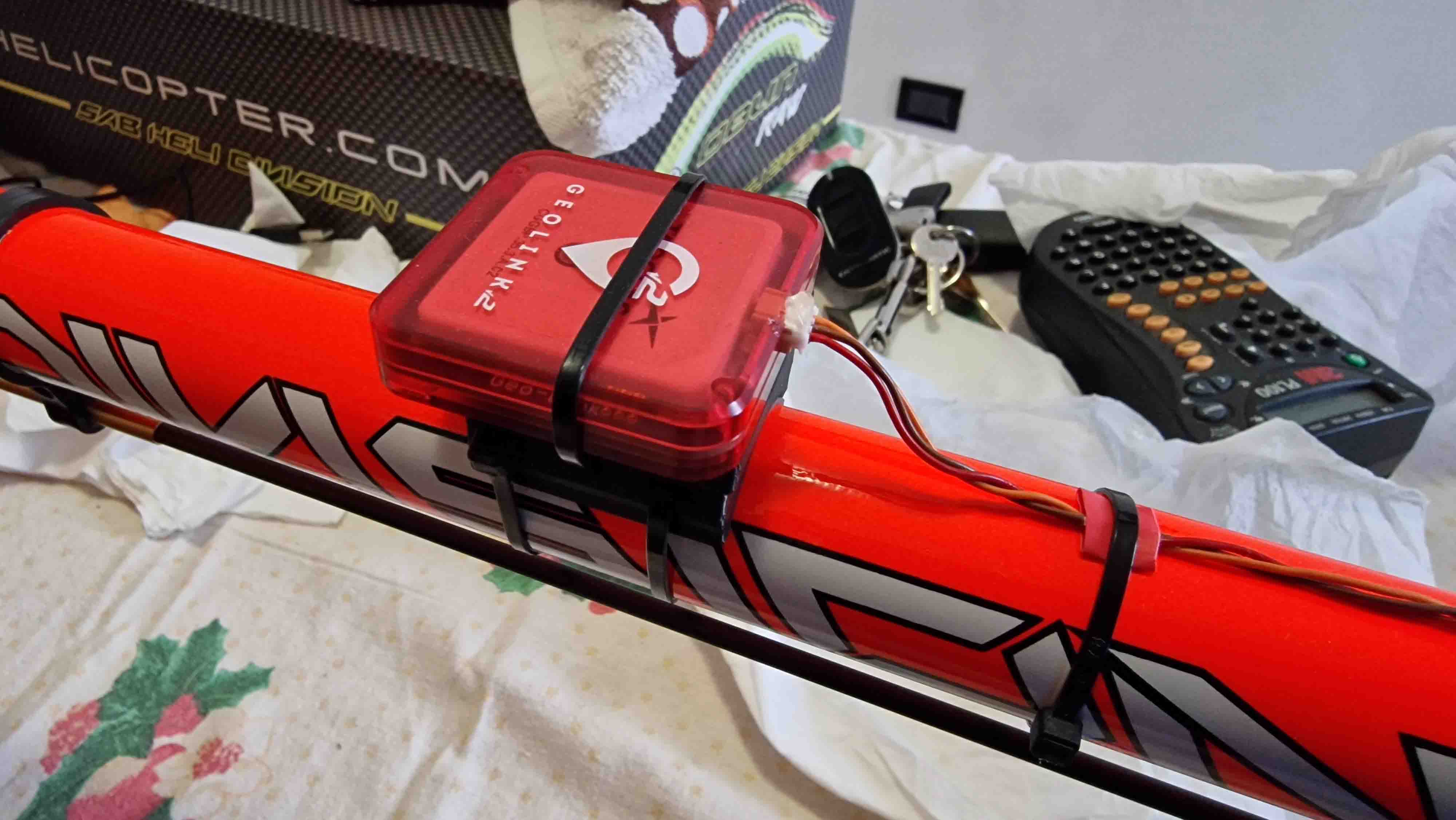

me for the geolink I created a support with the 3d printer, maybe the laser does not have a 100% unobstructed view.

however I moved my geolink to read better the laser.
I tried to aim it at the sky (I had it in my hand disassembled)
while pointing to the sky with 100% unobstructed view it marked 3 meters
reading the values in tab geolink settings - info
is normal 3 meters if you point to the sky?
